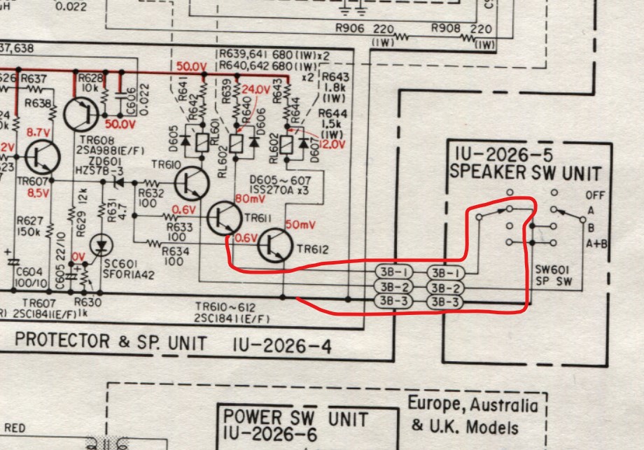

The problem happens more often now, so at least I was able to get some measurements in the "fault" state.
1/ Connect the speakers to 'A' and when the fault occurs measure the voltage on TR611.
Measure all three terminals and record the result.
The expected voltages would be about 650 millivolts on the base, close to zero on the collector and the emitter should be at zero volts.
I'm getting strange results for this one.
When playing ok:
B: 1 V
E: ~ 300 mV
C: ~ 400 mV
When in fault state (so relay tripped, no output to speakers):
B: 1.9 V
E: 1.3 V
C: 50 V (!)
Not sure how to interpret these yet :-|
If the emitter is higher than zero then there is a problem with the switch or the wiring.
If the collector is high in voltage then either the transistor is open or the base drive voltage is missing.
In that case measure the voltage on R631 (either end) and see if that is present. If it is 7 volts or more then there is a problem around the driver transistor which we can look at.
If there is no voltage present on R631 then we are looking further toward the circuitry at the left.
I measured R631 at one end, it was about 8.75V.
But looking at the diagram, the voltage should be 8.5V, so that seems right?
Thanks again 🙂
Just trying to pick up from where it was all at 🙂
OK, this might be easier than you think. Look at the circuit you posted at the beginning of the thread and follow the emitter of TR611. The emitter should be grounded via the switch (this is why I say there should be close to zero on it and why the base should be at around +650 millivolts)
So at face value there is a high resistance somewhere. The switch is favourite tbh.
Does that make sense?
The emitter has to be at zero volts, anything else means a high resistance is present.

If I understand all this correctly, the A/B/A+B switch is the main suspect?
As a side note: there seems to be an error in the diagram: the rightmost RL602 (the one parallel to D607) should be RL603 (confirmed this on the circuit board itself and the printed wiring board in the service manual).
(RL603 is the relay for the headphones output)
(putting this note here in case someone runs into this and googles it 🙂)
Yes... look at that diagram and think it through 🙂
You can do further tests. Connect your meter black lead to where it says 38-3 which is ground.
Now measure the voltage on the 38-3 line at the switch. It should be zero of course as it should be a direct ground connection.
Now measure to 38-1 on the switch board. That should be zero volts as well because the switch should be connecting 38-1 to 38-3 through its contacts. If you have voltage on 38-1 then the switch is bad.
If by chance you don;t see voltage on 38-1 then you must then have an open circuit between there and TR611 but that would be highly unlikely.

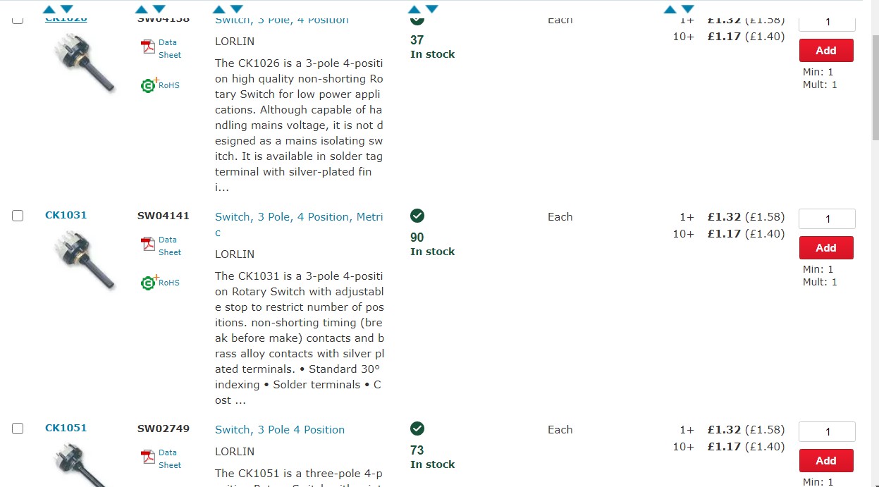

That looks highly promising. I would go as far as to say that those tabs on the frame could be gently closed and the switch dismantled and cleaned properly.
It also looks like a replacement by a generic 2 pole 4 way switch would be easy to do if needed. You would perhaps have to hard wire it rather than use a PCB but it should be straightforward.
You would use a 3 pole 4 way and just use two of the contacts.
https://cpc.farnell.com/lorlin/ck1031/switch-3pole-4-pos-metric/dp/SW04141?st=lorlin

Needless to say (maybe) but don't expect most modern affordable switches to last as long as that one. The Lorlin types are the rare exception, they are both good and affordable. New old stock Elma, Knitter, Grayhill are among the best.
