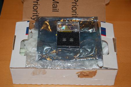

Good news- I FINALLY got a working pair of replacement OP627's to fit to my line stage & finally have the parts to finish tweaking my dream system this year.
I just want to thank my friends here who sent me emails of support (and agree: I didn't want to " get into the middle of a p1$$1ng match " on the forum if I could avoid it either).
Thanks to Don and Mark for reporting here on these great-sounding op amps in the first place. These and the AD826's Matt sent me beat the OP275 and OP2134 amps by mile. I'm still deciding on which I prefer, as I really like the AD826's and they're reasonably priced.
Tweak posts should restart afresh and Moderator: I promise to post strictly about DIY audio matters in the future, and I hope others will too.
And thanks especially to Danny who kindly sent me said opamps; They are the real thing and arrived properly packed
(see pic). I am truly grateful!
