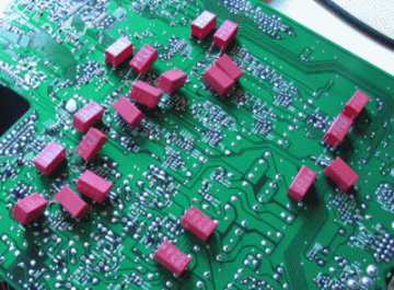

The modding of my 2900 is officially complete.
Tonight, I finished my PS upgrades by removing the .1uf/250V and .22uf/250V x-rated safety caps and replacing them both with .47uf/600V Auricaps (ala "auricap tweak").
On the audio board, I replaced the AD8620 I had placed in IC216 with an AD8066 to match the AD8066's in the output path.
I also replaced the stock output path resistors R312, 313, 314, 315, 318, and 319 with Riken Ohms.
In addition to my "Dutch Mod," these last few items have dramatically improved the sound. More detail, tighter bass, more air around notes, and the blackness is just beautiful. Surprisingly, the redbook playback (the 2900 weakness IMHO) has really improved.

Yes! I'm late to the party, but have modded one of my DVD-2900's!
I bought a couple of these players used several years ago, and just recently got around to modifying one of them. I took a very simplistic approach to the output stage, essentially bypassing it (or at least most of it) through .5uf paper-in-oil capacitors to gold-plated RCAs. Most of the work was done n the power supply, where I followed most everyone's advice by replacing electrolytics around the regulators feeding the audio board, and the bulk of the primary side of the supply.
I spent about $35 in parts, not including the few things that I had on hand. The biggest mistake that I made was not measuring the component spaces on the power supply board - many of the caps that I bought were too wide and I had a real challenge getting them to fit.
It all worked really well, and the player now sounds really wide open with great bass.
Check out the pics...
