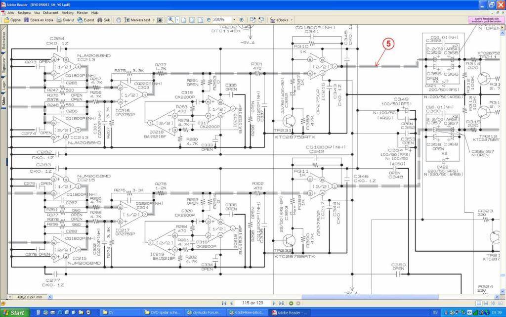

2900 Mod help please...
I am looking into upgrading my dvd 2900 for audio output and am pretty new w/electronic upgrades like this, so I could use some help.
1) to remove the mute transistors on the analoge outs I remove tr221-228 and replace them with a resistor between the outer solder points? (What value resistor would be best?)
-what about the tr207-214? What do they do? do they get removes as well?
-What about replacing them with relays to stop the poping, but keep the signal clean? (Could run mini relays off their own power supply and use the middle solder point and a transistor to switch the external power to the coil of the relay? Good idea or waste of time?)
2) Upgrading the coupling capicitors replace the radial caps (C361-364) with 10uf black gates? (How much base will I loose?)
-What should I put in place of the blue caps (C371-374)? A black gate alternative? Which one, or better alternative?
3) Are there any other caps that I should replace with Black Gates to make a big difference on the analoge or coax digital output to make them sound better, cleaner, more dynamic, better?

Does anyone know if the Burr Brown ops 627 can be soldered in as a pin for pin replacement of the stock opamps?
Unfortunatly not, the ones in the 2900 are dual channel OP275GP for buffering, NJM2068 for I/V and some BA15218 for hf filtering. Any other SMD dual channel op will fit though.
is it worth it to upgrade the caps on the main powersupply board to Black gate caps or are Phillips LL caps good enough as long as I up the capacitance? (I am thinking of using 2 caps of the same rating in place of each power filter cap in the power supply I.E. replae one 100uf 16v cap w/2 100uf 16v cap. Reason: two smaller caps recover faster and give better transient power than one larger cap. -->Does this logic hold up in the audio/video realm or not? ??Increased resistance negates effect??
For the main board you absolutly need to stick with SMD's, partly becouse shorter lead lengts and less ESL but also becouse the critical ones are under the transport where there is not space for anything else. Dunno much about the caps you're referring to but I would suggest Sanyo Oscons, an SMD variant called SVP. I would not double up any caps, the caps I am referring to is as "fast" as you could expect.
If you remove the mute transistors I would suggest you just short the dc blocking output caps.Upgrading the coupling capicitors replace the radial caps (C361-364) with 10uf black gates? (How much base will I loose?)

If I really wanted the best I would try to change the layout and cut down to one opamp per feed, then use the MAX4108 single channel, 400Mhz, -93dB@5Mhz or the BB OPA843 with a similar spec.
I did this a few years back using a BB OPA620 on an Pioneer 717 with really stunning results.
When it comes to filtering and decoupling I don't have the specific values but there are many options on the video board not used to filter ps lines, use them with good coils (very high resonance freq) togeather with oscons and you'll lower the noisefloor significantly.
For the ps entering the board you can easily cut the cables, add coils directly on the cables with a set of high value, low esr caps to keep the overall esr down and at the same time lower incoming noise and smooth off any 50Hz residues.
I've done the clock curcuits by changing the decoupling on the clock curcuit(s) and basically all the digital processing that I found relevant to audio and video performance.
The video board is easy, its the first thing you see above the audio board and the DA is marked AD7300, the opamps are three in a row and marked 15420.
Hope it helps with your inspiration.
/Michael
