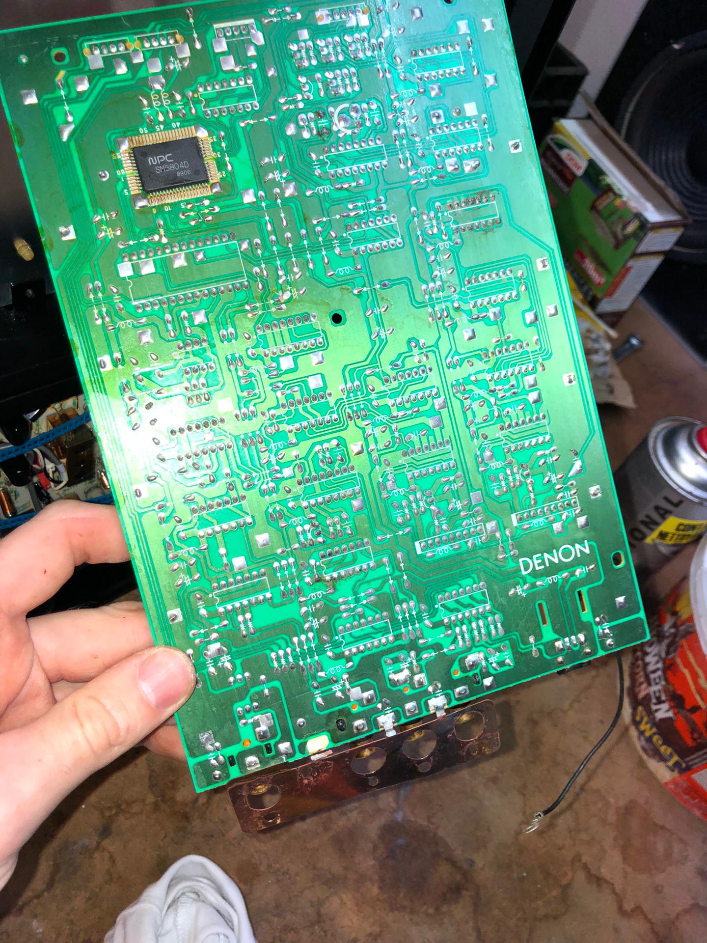

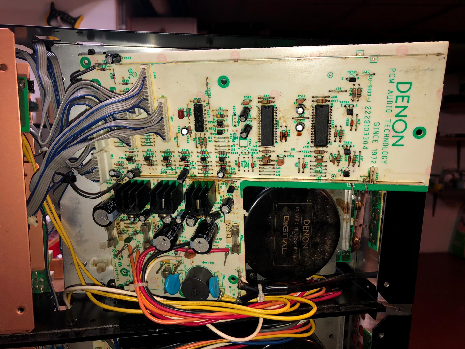

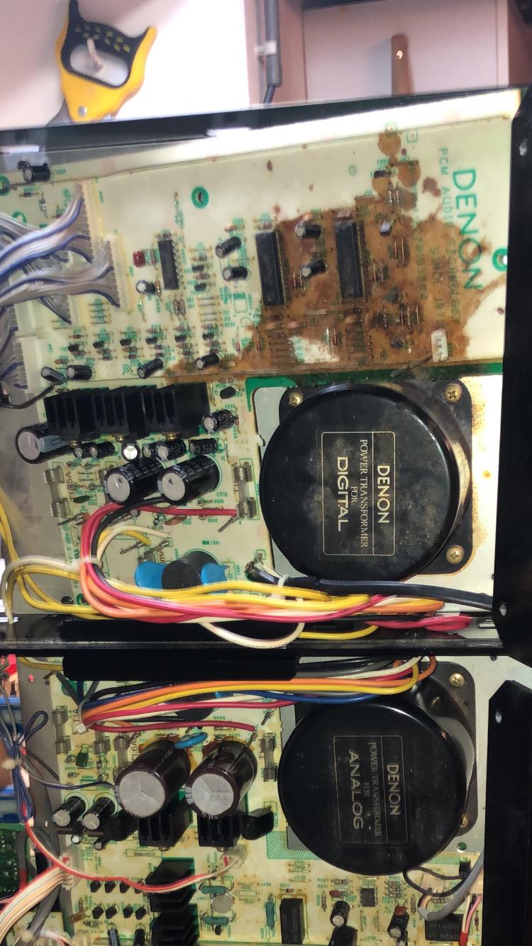

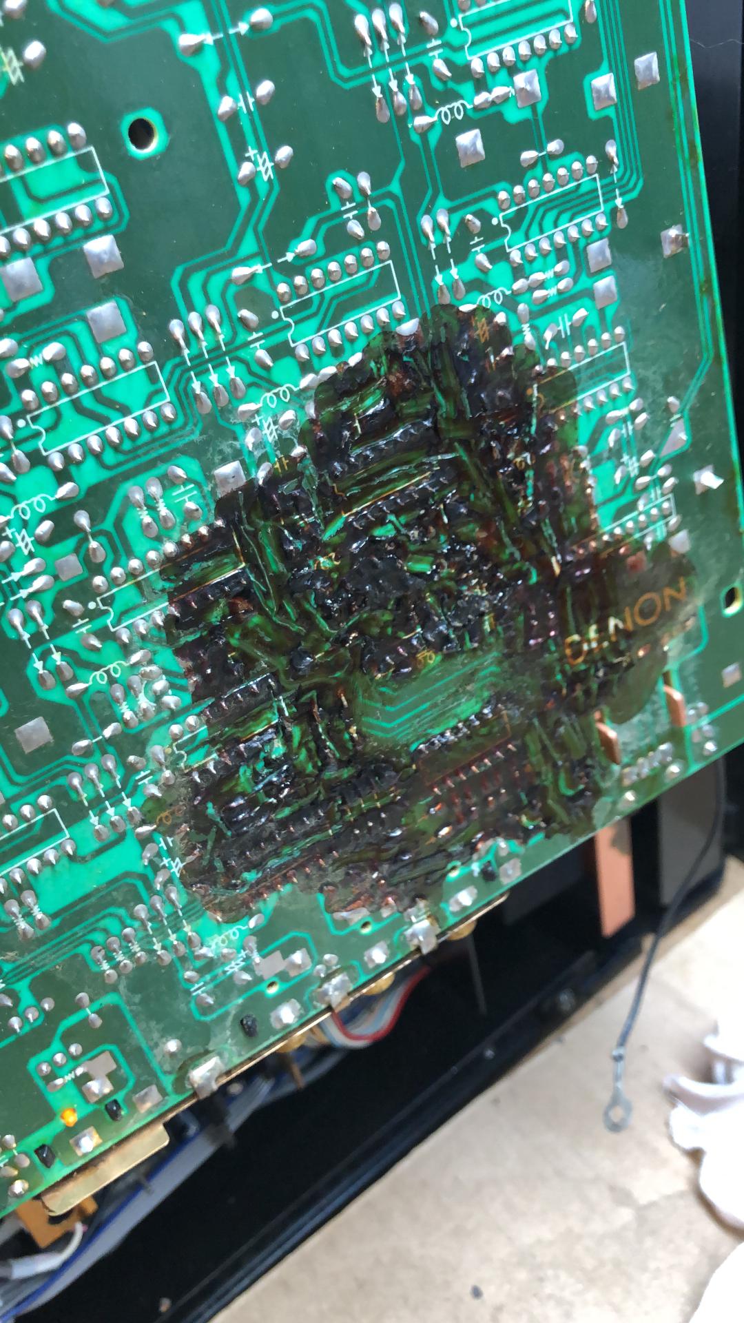

Update: 4hrs of cleaning coke from pcb
Hi Guys
So, the previous owner spilled some coca cola on the amplifier. It was all dried up and sticky. What a disaster! Tried different kind of dessolvants but desinfictant alcohol really did the trick! But what a hell of a job to clean it. Man man. Please check pictures to see the before and after.
Now its okay i guess, later this week i will re assemble it. But I still have two questions.

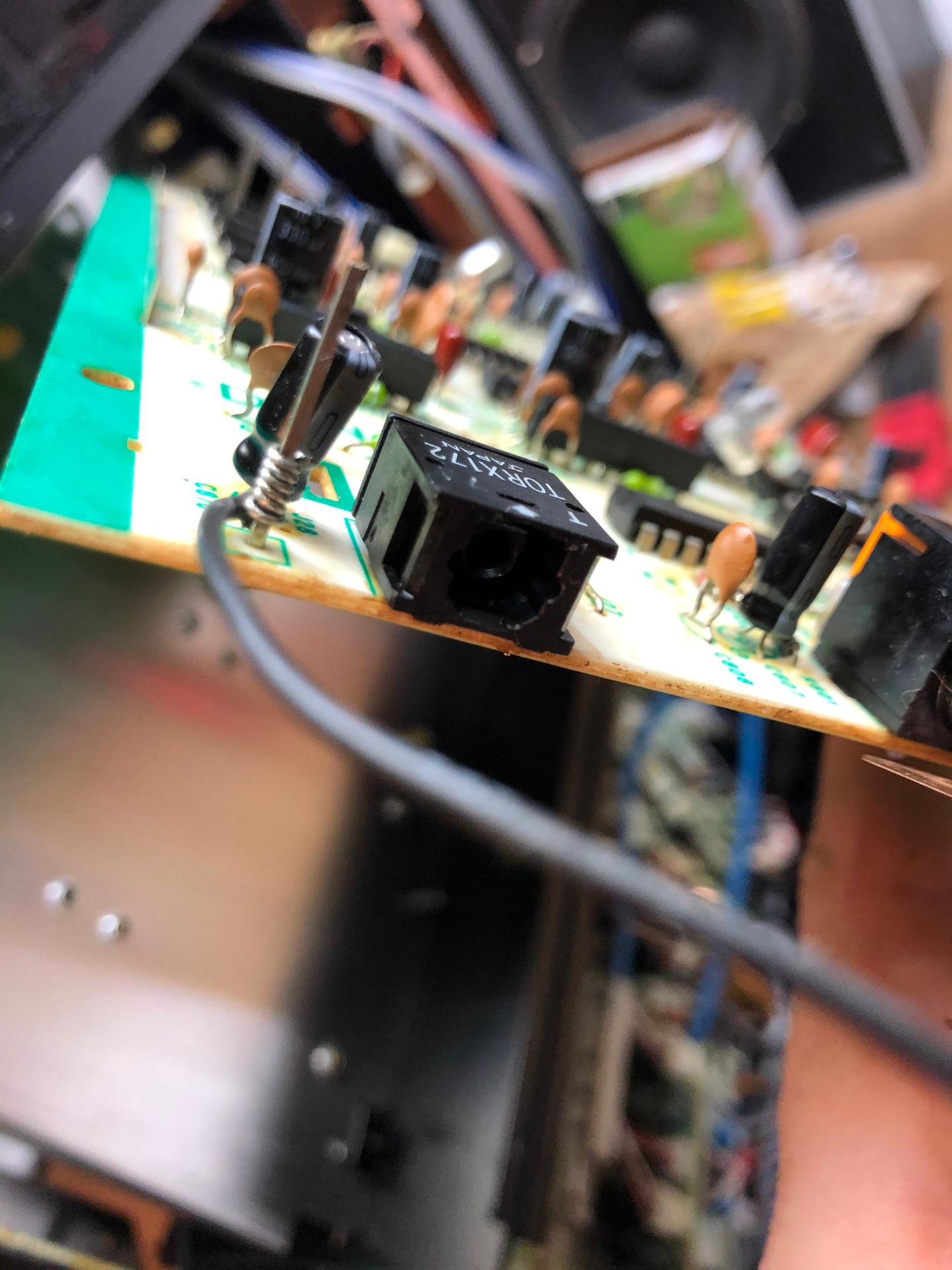

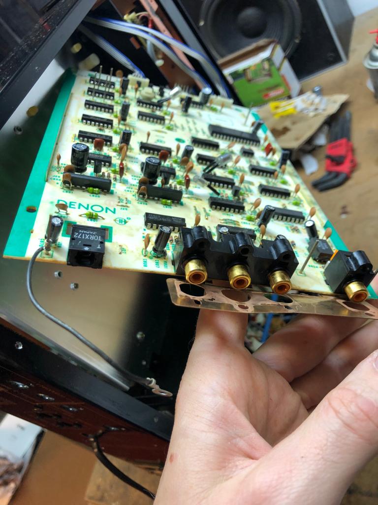

The toslink port (see pictures) was also covered by coke. Should I desolder it and dip it in a little bath of alcohol. Then afterwards of course a night drying out before soldering it again. Or is the inside of such a tosslink connection too fragile to dip it in alcohol?
The two ic’s, mentioned in my earlier post, were completely covered by coke. Now they’re clean. I think an ic is waterproof? So I suppose there wont be any coke on the inside?
Oh, one more thing. The soldering got a little corroded from the coke. Should i redo them or is this not so important?

Update: everything cleanded, desoldered the tosslink gate and cleaned it, did some other cleaning, resoldered some connections. And it works like a charm!!
Digital tosslink locks nicely at 48kHz.
Unit sounds much fuller than the pra1500. Bass has more body, higher notes are more full too.
I’m a happy man ☺️
