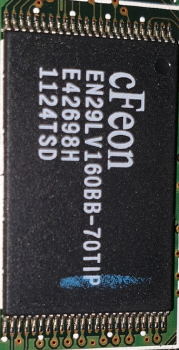

For exemple pcb before repair :

These ERS values are height for sure: Nice job on replacing these capacitors; It’s unnoticeable on the photo. The yellow capacitors are most likely tantalum capacitors, which usually do not fail.
For the rest you have to wonder: Could the part you’re replacing be the cause - or contribute to the cause - of the problem you’re trying to fix if it fails? I’m almost sure the answer is ‘no’ for the decoupling capacitors around the DACs. Since all digital inputs are affected, including HDMI (and DenonLink in my case), the failing part has to be someting used by all of these inputs. This only leaves the Altera FPGA, the Analog Devices DSPs, their peripherals, clock source or a power supply. And that’s all hard to measure without an extender board.
Usually, degraded capacitors cause different symptoms. Unless they’re decoupling the FPGA’s power supply, of course.

IC605 is an EPCS16SI16N, a serial EEPROM probably holding the FPGA configuration ('program'). The schematic in the service manual, unfortunately, is not text-searchable, and there are lots of 'busses', making the signals hard to follow. You can replace it, but you need to program the replacement part with the proper configuration first.
Another contender is IC611, a DIR9001PWR 'PLL' according to the service manual, but a digital audio receiver according to its datasheet. With an extender board, things like this are easy to verify, but without one, you need to tack measurement wires on everything and keep on disassembling and reassembling until you've found something.

Are you able to locate the regulator for the circuit in question?

Did you follow the fault-finding tree for the Digital Audio board in the Service Manual?
