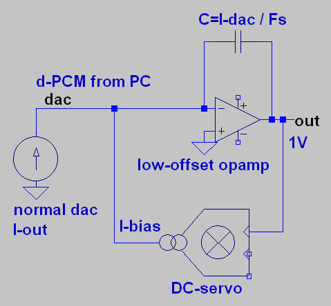

I've been thinking of simple way to play with such dac idea.
Easiest seems to use existing current-output DAC and feed it with computer generated differential PCM (dPCM). Then output of the DAC chip connected to integrator would produce output signal equivalent to linear interpolation.
I asked DSP plugin writers of foobar2000 audio player to write a small plugin that generates dPCM on the fly, and one of the devs was kind enough to quickly write it. He created plugin that makes 2 DSP effects, one to make dPCM and other to integrate back to LPCM.
The player is http://www.foobar2000.com/ and the plugin is found at http://www.stud.uni-karlsruhe.de/~uybc/foo_dsp_delta.dll
With this plugin one can output normal wav file as dPCM into DAC under testing, including high quality musical content for auditioning. To avoid further postprocessing, the DSP effect should be last in chain, and sound card configured to not change anything with the signal after that (like master volume 100%, bitperfect spdif).
There is a drawback with this method. With 16 bits maximum delta representable is -32K to +32K which means that full peak to peak swings cannot be represented - it would require 65K delta. This is an issue if you have -6db or higher magnitude harmonics near Nyquist.
Dual DAC approach is free from this issue - one reason why 2 DACs may be ultimately necessary. You can avoid the issue by making sure high frequency content is below -6db before DSP plugin, thus still have meaningful results. Most probably you won't face the issue if you don't feed the DAC with 0db sinewave near nyquist.
A word of warning:
The plugin lets you apply either conversion (LPCM->dPCM and back) on any content, and dPCM played on ordinary DAC even sounds pretty much recognizable, though quiet. But if you apply dPCM->LPCM onto LPCM content, then DSP will push digital signal into very severe clipping with DC component that can damage your speakers or amps. So be very careful with volume while playing with the plugin.
To make the integration and dPCM->analog conversion with normal DAC, you'd need IV convertable to pure integrator, like for eg. Elso Kwak's schematic he posted here: http://www.diyaudio.com/forums/attachment.php?s=&postid=499341&stamp=1098788239
The feedback IV resistor R3 needs to be removed or increased alot, and integration capacitor increased to limit output swing. I'm afraid DC servo is unavoidable, unless your opamp and DAC has zero DC offset. Some DC drift is expected anyway, thus make sure to filter out DC before output.
If DC drift is slow enough, then it might be possible to test it out even without DC servo, though the sessions might be uselessly short before DC offset reaches unacceptable levels. Anyway, its the simplest possible way to proceed with practical evaluation I could come up with.
Hopefully someone who has a suitable DAC for such conversion cares to play with this, it would be interesting to hear comments on how it works, measures or sounds.
