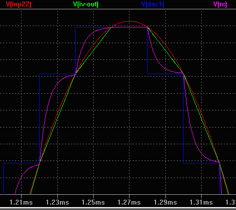

Think in terms of currents here. Your list of ABCD inherently assumes absolute voltage levels, which is not what its all about.
There is output A(x) on DAC1 and A(x-1) on DAC2, concurrently, always. Only 2 samples at a time. Currents are easy to substract. Result is single current that is proportional to difference between two last samples. In your example, that would be A-B, B-C, C-D, etc.
If such delta current is applied to IV Cap, exactly the waveform results that connects instants of DAC output change as if infinite linear interpolation has been done.
http://www.diyaudio.com/forums/attachment.php?s=&postid=492387&stamp=1097849833
Its a difference between blue DAC output and green delta-current output (IV-out plot). To generate such linear signal, not a single filtering stage is needed or digital filtering, only 2 DACs with delayed data on one.
The IV Cap is slew rate limiter. It must be dimensioned so that to get say 1V AC output from the DAC, slew rate on the Cap must not exceed 1V/sample for change from 0 to 64K of 16-bit sample. In essence, thats slew rate limit of 1V/22us for 44.1K audio. Thats pretty hard, but its nothing compared to 200ns settling time of DACs. And thats absolute extreme case, for lower freqeuency or lower amplitude content, slew rate on the Cap will be lower, naturally, as a result of DAC delta-current charging the Cap.
Thus, anything beyond that IV Cap is seeing slew rate limited signal to deal with.
Guido, thanks for quote. So its not new idea. I have also seen some hints on similar approach from Onkyo, but not any DIY. Why I wonder.

wimms said:
<snip>
<snip>
I see absolutely no point to this.

janneman,
If you integrate output of normal DAC, you won't get the same thing. You could achieve almost the same result IF before feeding normal DAC you translated PCM into delta stream computationally. It is important to integrate delta-current, not absolute currents. Then you would need to change your normal DAC IV stage to integrator. Normal alias filter would fit then beyond that.
Linear interpolation occurs only if you integrate between steady states for the whole duration of sampling interval. There are only few ways to do that, all involve "memory" of the previous sample for the duration of integration.
The remaining considerations, perhaps arguable, are related to other things, not fundamental to the idea. Of course imo.
Because outputs of both DACs change simultaneously, some nonlinearities are canceled. It's utilizing similarity of channels as a matched pair. DAC transients are heavily damped. DC drift due to nonlinearity of DACs is canceled.
Integrator is purely passive device - Capacitor. No feedback. No opamp is needed at this stage. Thus linearity of IV stage is defined purely by DAC output linearity and Capacitor properties. Nothing else.
It's the linear interpolation with only passive devices that is the core of the idea.
I don't think second DAC channel is _necessary_, single DAC would be even easier for testing with PC, but I thought that it would be pain to construct delta-PCM computationally in a standalone DAC expecting normal PCM data input. The use of 2 channels is simply a straight forward method of getting delta-current.
Settling time of normal DAC can cause voltage oscillations. In delta mode, it is converted into slew-rate variations, basically damping high frequency transients very efficiently without upsetting circuitry beyond. When going to higher DAC sampling rates, settling can take quite a large proportion of whole sample interval, thus digital interpolation has some limit in its usefulness.
WRT essentially implementing first order filter, raised by Alvaius - any type of interpolation is essentially some kind of filter. Yes, this DAC would have property of lowpass filter, but its not as simple as ordinary lowpass with some fixed cutoff frequency. I'm in trouble classifying it. Its behaviour is different with discrete-time input vs linear input signal it seems. It allows instantaneous change of slew rate (and thus signal, implying infinite bandwidth) yet strictly limits the slew rate itself. With linear input it looks like first order filter with cutoff frequency of 0. Its the interaction of fixed sampling interval (Fs) and the integrator that makes the difference. If you take output peak swing for output magnitude, then such discrete interpolation has cutoff at Fs/2. Reason why sinusoidal output has lower cutoff is caused purely by signal shape approaching triangle when approaching Fs/2. That is best avoided by digital filtering and OS.
Of course, all these are just my thoughts, not necessarily correct.

Perhaps this picture below illustrates it better. There you see DAC output that corresponds to 1KHz sine sampled at 50KHz, simple RC integration of the DAC output, and delta dac output.janneman said:But a 'normal' I/V IS an integrator, so I don't see how you can improve on that with what is essentially a scaling change. I thing rfbrw's comments is along the same lines, IIUC.
RC output is what the output integration of a normal DAC gives. This picture is of course exagerated, as its just simple RC, more sophisticated brickwall filters will increasingly achieve sinusoidal output, but there will always remain the character of this RC integration, which is result of memoryless integration.
Notice that the positive and negative slopes are not symmetric with RC integration. Notice larger difference (error) between original waveform and RC integration vs linear interpolation. This is manifesting as higher spectral composition of DAC output that is subsequently harder to filter, meaning higher order filter is required, is facing more difficult transients.
So, what this linear interpolation gives, is lower spectral density, higher symmetry, simpler filtering. Whether thats good thing to the sound, I don't really know, but I'm inclined to think so.

Green Curve
Hi wimms,
Interesting picture as the signal in my DAC after the IV looks exactly like the green curve. To get a smooth signal additional filtering is required.😎
wimms said:Brouhaha? rfbrw, this is a discussion forum, so if you have constructive input, give it. I had an idea that I presented with my personal thoughts. If that is brouhaha in your book, then I suspect you're into personalities here.
As there have been noted that this is not a new idea, I don't claim its mine. So free yourself from urge to attach it to me and analyze it like idea first implemented by names like HK.
I'm genuinely interested in discussing merits or problems with that idea, and OliFilth is at least trying to make his point.

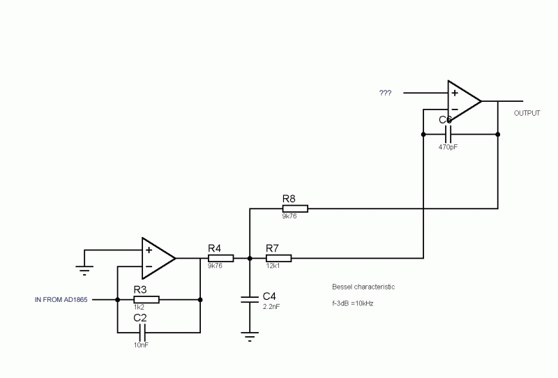

Schematics
Yes, With the TDA1543 NON-OS I am currently using 3k65 as the IV-resistor (R3) and a 3n3 cap (C2) across it. Please note "??"= ground.
The scope picture I am referring to is that of a 3150 Hz sine wave.
wimms said:Hi Elso,
Can I see your schematics?
