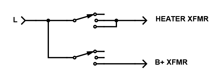

Take a look at a switching scheme I've used many times for power amps. It uses two DPDT toggled wired so that whichever switch is closed first powers the heaters and the second powers the mains. No matter which switch you turn off first it powers off the mains first. Not original, I found it long ago.
https://www.timebanditaudio.com/300b/schematic.html
This is really great in its simplicity and effectivity!

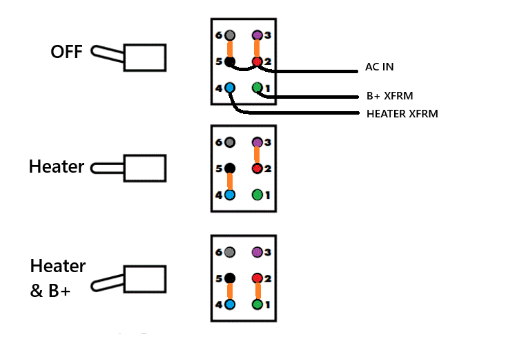

My suggestion would be to use a DP3T rotary switch or a DPDT On-On-On toggle switch instead of separate switches for the heater and HV so that you don't need to drill another hole in the front panel.
Screenshot 2025-04-10 at 22-52-50 Scheme-it Free Online Schematic and Diagramming Tool DigiKey...png
DP3T Rotary Switch
Screenshot 2025-04-10 at 23-02-10 dpdtc-oncolours.gif (GIF Image 550 × 550 pixels) — Scaled (8...png
DPDT On-On-On Toggle Switch
