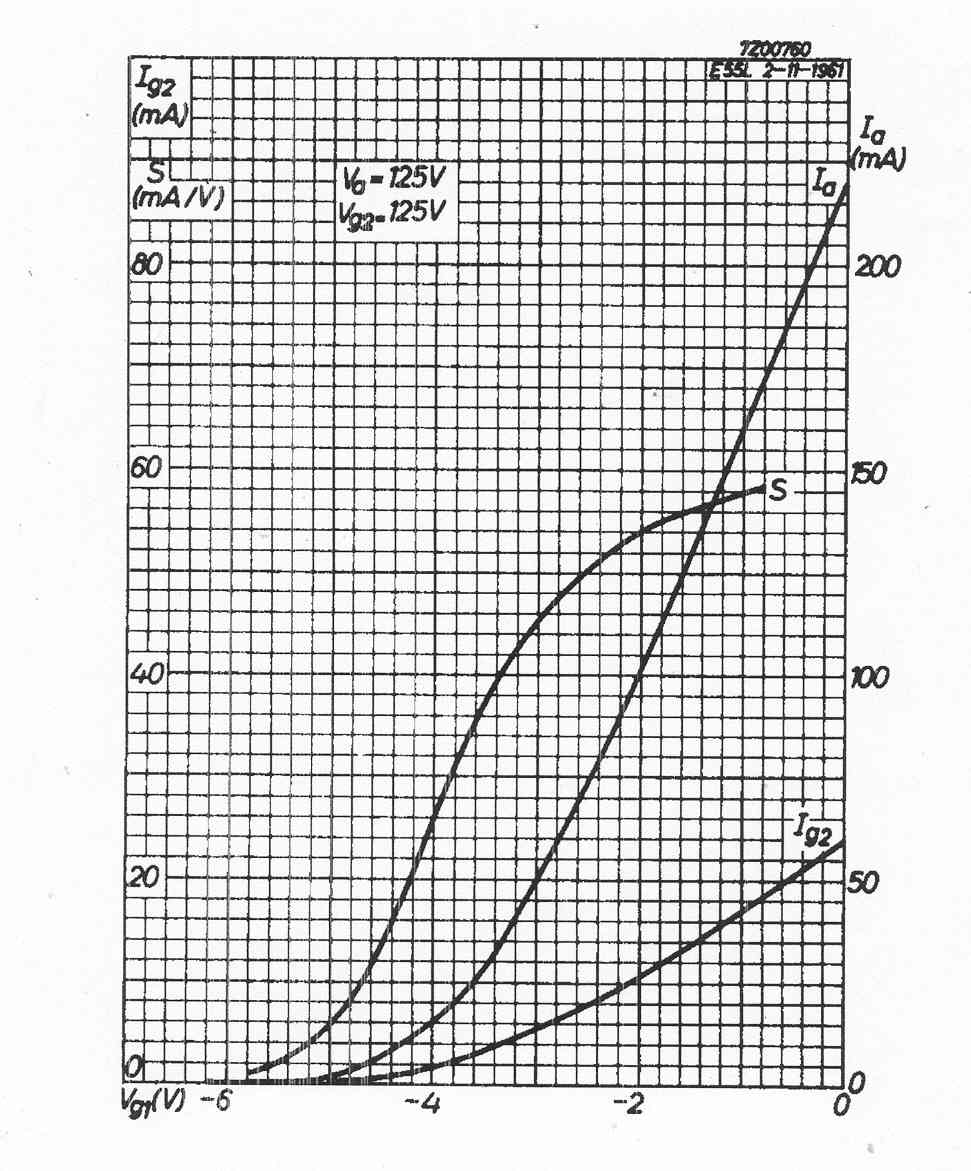

This whole discussion is not hitting the bullseye yet. The Class A/ Class AB distinction is not about the way the music will sound. It's not relevant unless the amp isn't well designed. In an AB amp both power levels should be the same SQ in the amp as the power transitions higher into cuttoff, if the amp is well engineered to minimize any crossover distortion. FB is the magic. The focus of attention should be on the difference between an SE and a PP amp. That is where the characteristics of distortion and PS ripple hum diverge, vis-a-vis. Both types sound great.
In what way shape or form would the brand-X amp amplifier be any "worse" or any less worthy of being marketed as a "50W class A amplifier" than the brand-Y amp?
From the typical gm curves posted back in #53 (and 1st graph below), the fully overlapped conduction class A amplifier will tend to have near constant gm (sum) throughout the full operating range. While the partially overlapped conduction class AB amp will have almost constant gm (sum) up thru maybe 80% output (actually a slightly curved upward sum) until near the transition regions where gm will sharply round upward toward the V shaped gm regions of the class B portions. Sort of "anti-clipping".
Of course N Fdbk can fix that. But may make the amplifier sound "flat", at least for some SE amp users. An optimum fix exists. Some tail resistance under the output tubes might "de-curve" the (central) gm (sum) too. (2nd graph below is tube gm over a CCS tail (ie, versus current), which has an opposite downward curvature sum in P-P. Some intermediate tail R can achieve a near flat (central) gm sum. It won't fix the V shape gm regions in the class B portions however. )
So a subtle difference if done well. A noticeable difference if done badly. Depends on the tube gm curve details and circuit design. Local output tube N Fdbks could change everything too.
As is apparent, a summed gm plot versus input signal, displayed on a scope, would be a big aid in developing correct output stages. Not that hard to make actually. A linear ramping input signal across the relevant range, with a summed small amplitude 1 KHz test signal. Then display the ramp on the scope horizontal, and a 1 KHz filtered and rectified/smoothed output amplitude on the scope vertical. Just a dynamic gm tester actually.

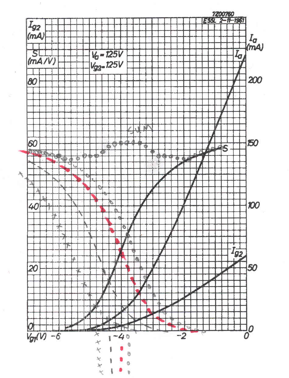

I know I've discussed this with you in the past. This is a subject that interests me a lot.
I just printed out your E55L transconductance curves and just doodled some combined sum curves for a push-pull stage at 12mA, 15mA, 20mA, and 50mA bias points. I saw similar shapes to solid-state devices, although much smoother. The 12mA case was a smoothed V-shaped curve with perhaps 16mA/V total variation. The 15mA case gave a more flattened curve with a small peak emerging in the center of the "V". There was slightly less than 8mA/V total variation in that curve. The 20mA case gave a good strong peak in the center with rising sections on the left and right sides of the curve from the center (peak was over 6mA/V tall, which makes up the total variation in this case). The 50mA case was a large peak with all signs of the "V" gone. It had over 26mA/V variation in gm across a reasonable operational range. Overall, these shapes are very similar to what I've seen in textbooks for solid-state devices, although the shapes are much more rounded and smaller in magnitude.
Of course, this represents working into a vertical load line, but I'm thinking that gm would be pretty constant with plate voltage at a constant current, so this would give us insight into how a real push-pull output stage would work.
I'm puzzled that you state that the class A case has nearly constant gm, since that is where I saw the most variation. The cases where I saw the least variation in combined gm where when I biased right in the steepest part of the gm curve. Maybe I'm missing something here. I'll try to post my doodle later.

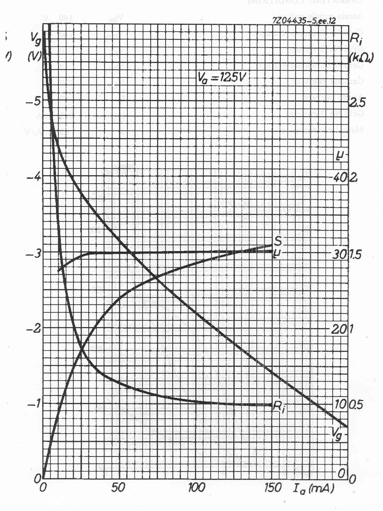

Are you using the gm curve that is versus grid voltage? (below)
You would certainly get a bump in the middle using the gm versus current curve. (which is what one gets over a CCS tail)
But normal P-P grounded cathode outputs use the gm versus Vg curve. (S shape) Since the two Vg are complementary there. (the anode currents are not so complementary due to a common mode component)
The plate voltage does not matter much for pentodes, so the gm versus Vg at a fixed Va graph is still useful.
For triodes however, the plate voltage variation is acting like N Fdbk to keep the gm variation fairly constant. So plate V does matter there.
Yes, I picked a plate current (tied to a grid voltage on that plot) and centered things there. I plotted a point that is double the gm value at my center point. Then I summed the gm value of one square to the right and one square to the left and plotted that value on both sides of my center value. Then I repeated that moving outward from my centered point. Does that sound reasonable?
That would be the case for a HIGH N Fdbk amplifier with very low distortion, but for (-some-) tube amps which have NO or LOW global N Fdbk, I would want to see the gm wing plot. To insure only low order harmonic distortion.

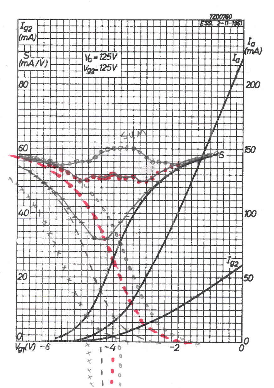

I just made a hasty summing graph(s) below, and I see a bump in the middle for the class A case also. Apparently the S curve is not perfectly symmetrical. Should make for an interesting set of graphs as the overlap conduction is reduced. (more neg. bias at center)
