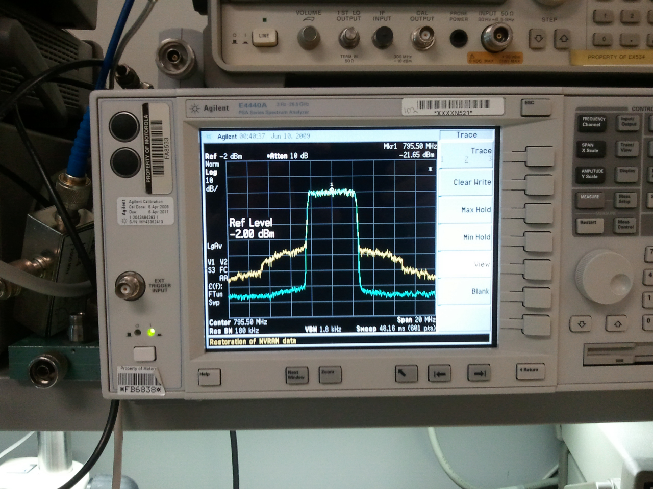

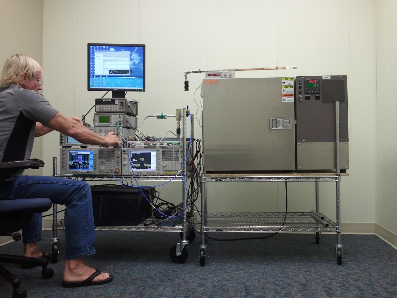

The first picture shows the big dummy (me) testing and tuning an LTE power amplifier to meet all the regulatory requirements while being subjected to temperature and load impedance variations. The RFPA is inside the big silver environmental torture chamber. The transmitted carrier is seen on the spectrum analyzer in the lower right, while the performance to the emission mask is watched on a specialized instrument in the lower left. A variable length line (trombone line) with a calibrated mismatched load attached is seen on top of the test chamber.
The second picture shows the PA operating cleanly (blue) with minimal spillover (meets requirements with margin) into the adjacent channels (techniques applied), and the same PA blasting the adjacent and alternate channels with spill over (2nd and 3rd order IM products) with the "magic" turned off (yellow).

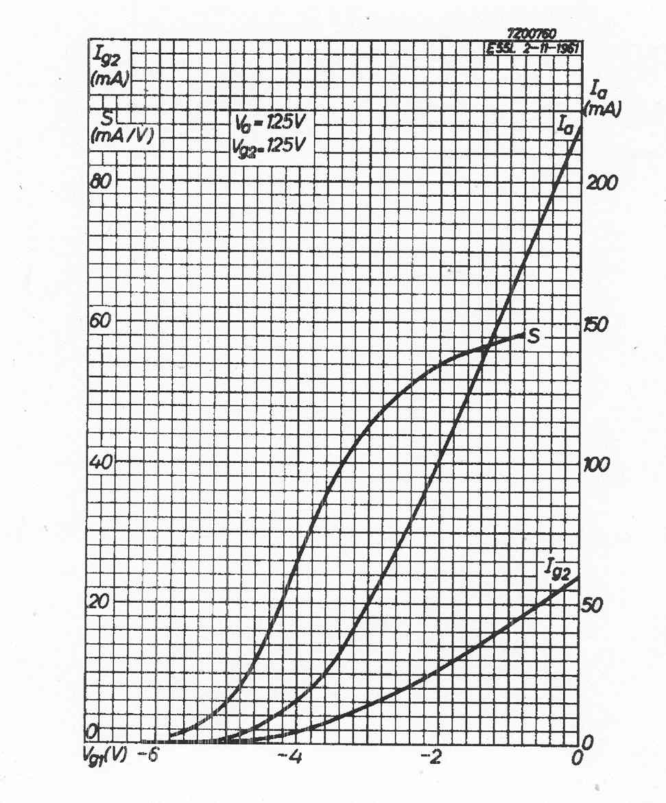

The mode of operation. It was originally (and still is, IMO) an operational descriptor, not an architectural one. Unfortunately the issue was clouded when people also started naming architectures as 'classes' too (class D, class G etc). Those higher 'classes' are really a collection of devices working in a combination of the 'true' operational classes, A, AB, B and C. It would have been better to call such architectures 'Smith amplifier' or whatever.What becomes Class AB? The amplifier, or the mode of operation?
Class AB should not have gm-doubling.
Sure, marketing literature says nothing about gm.
How is >50% class A possible?
No. It is either A, or B. You can bias it at any idle current that tubes can afford. All in the middle between A and B is called AB, assuming some artificial tube curves.
The sum of the two P-P tube's gm should be mentioned. For classical full over-lapped class A, the gm sum of the tubes becomes close to constant over the full signal swing range. Typical Gm versus grid voltage for an E55L tube is shown below (S curve). (the P-P over-lap has one S curve flipped around, and biasing determines the amount of over-lap.)
Without full overlap of the tubes conduction, the two gm curves sum to a flat bottomed V curve with rounded corners with the top of the "V" winging out besides. So clearly there is some distinction between full class A and just the class A portion of class AB.
The SS literature makes extensive reference to gm "wing" plots for P-P devices. Something similar needs to be done for P-P tubes. Both in the tube literature and on the bench with a simple analyzer/O'scope. This would make design so much simpler.

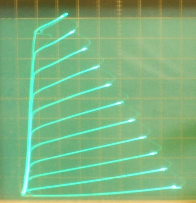

Then there is the "new kid" on the block, Twin/Crazy Drive (2nd pic below) which has near constant gm for each tube. Constant P-P gm sum should work out to a rather limited conduction overlap in this case. Making for an efficient "class A" equivalent.
