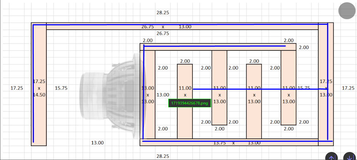

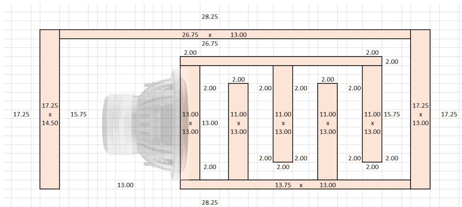

Hey man, what is this contraption called? I have been trying to digest this since yesterday. I take it that the HR sim is this box? 128dB is awesome, but I dont understand how you applied 12kw to a 1kw driver?With a 52.8 EBP, the driver should be used in a Sealed or BP4 enclosure.
I am trying to learn HR right now to see if I can draw something like that too for the 10" driver
Stepped Tapped Horn or
stepped tapped quarter wave pipe/tube.

is a ‘port’ that small not going to compress or create a very overdamped Fb If used as a ‘TL’ ?Hey man, what is this contraption called? I have been trying to digest this since yesterday. I take it that the HR sim is this box? 128dB is awesome, but I dont understand how you applied 12kw to a 1kw driver?
Taking inspiration from @BP1Fanatic (who is always a good source for interesting ideas)
an offset driver entry qw pipe works well, but every time ive created a REAL(wood) 'tapped pipe out of it(driver in the exit as shown) the 'backpressure' felt in the pipe misaligns the driver position with the resonance its normally cancelling out(not exciting) at about 1/3 from the closed end.... meeow
In theory the offset s/b at its eFhm = ~34400/8/eFhm = its acoustical 1/4 WL spacing, so when loading a driver with a eFhm that puts the driver near/at or partially outside it must have a terminus extension for best results.

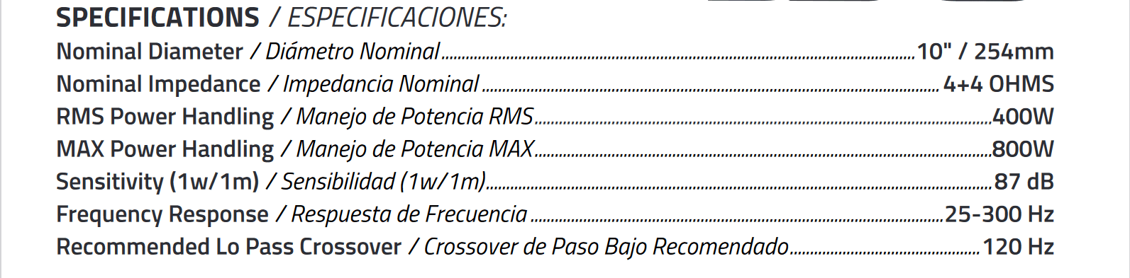

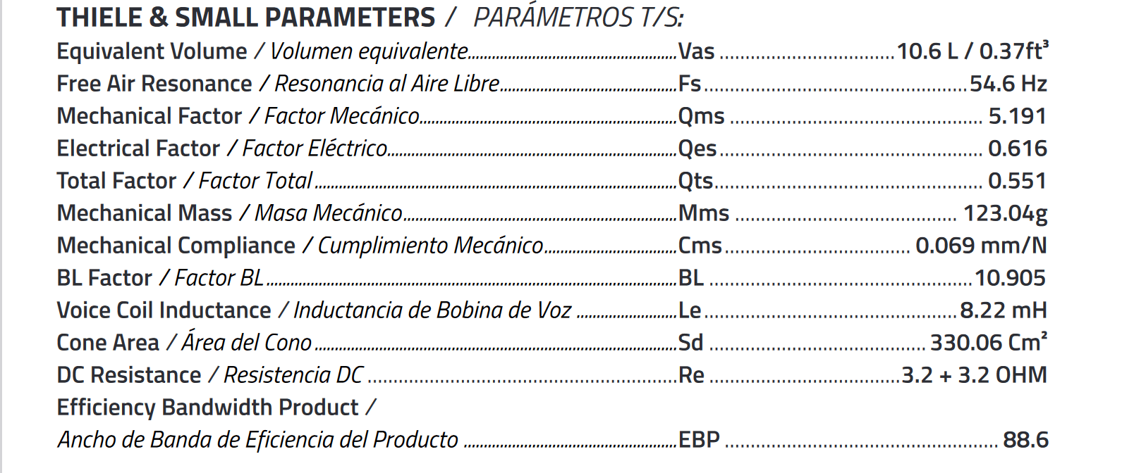

Heard back from DS18 tech support case
While trying to learn the data entry for HR, I came across this
I wonder if this has implications for WinISD too. Since the sim for the ZR12.3D has the coils in parallel as per past advice on settings regarding dedicated amp per coil, should the WinISD driver parameter for Qes be half too? The implications are the same for Le and Bl too? @weltersys @GM @WhiteDragon
Again the reply from DS18

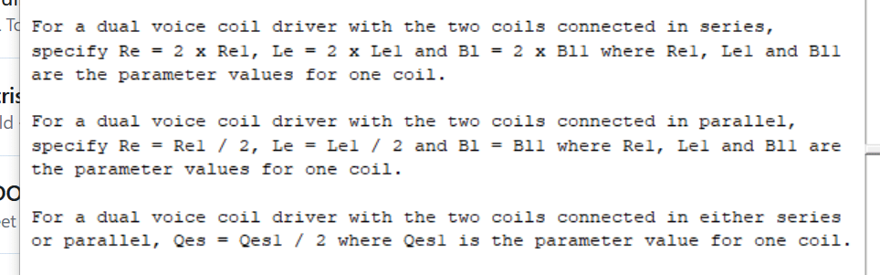

So HR input is sorted. The help file has instructions to config this
But WinISD feels pretty vague. I take it that in the parameter's dialogue, the switch for the coil connection is the key?
Leave that default parallel and then enter coil qty as two and then populate the rest by halving each value eg Re as half of the single coil and so on. This should then correctly update when the switch is flicked to series and back. Qes correction should done too? What about Qts, leave this for WinISD to calculate so it can flip correctly?

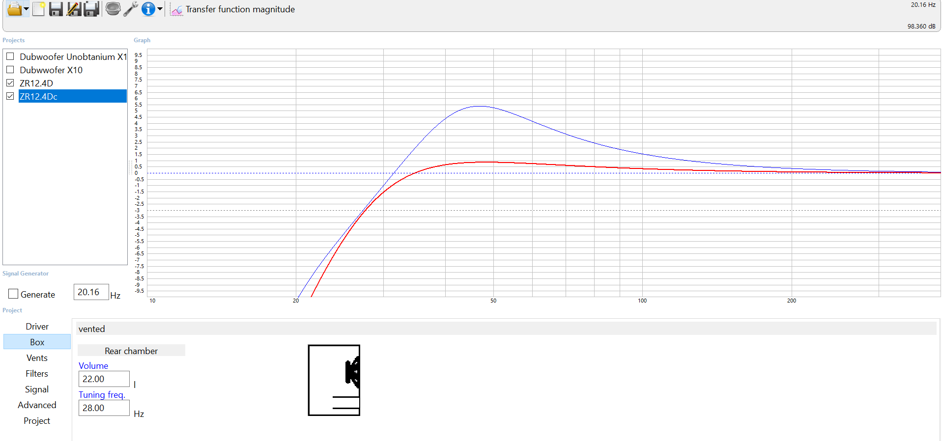

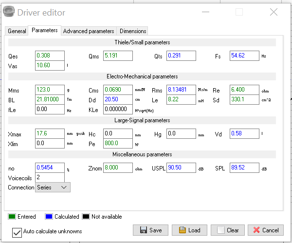

I might be onto a breakthrough with WinISD data entry for DVC. I followed the HR procedure for entering a DVC in parallel and first setup the electro side of the 10" unobtanium first
Left switch in parallel
Set voice coils as 2
Re=Re1/.2
Bl=Bl1
Le=Le1/2
Qes=Qes1/2
Znon correction
Then Cms, Mms, Qms, Vas, Xmax
WinISD calculated the Fs spot on and calculated 89dB as sensitivity. That's 3dB more than the listed 86dB that tech support confirmed as being for one coil only
Then I flipped the switch to parallel. Left Qes as Qes1/2. Corrected Znom again to 8 and Le to Le1x2. Bl and Qts had auto updated correctly
Seems consistent, what do you guys think? This could mean that the sims so far are all invalid, including the Cub Sandwich project. Maybe that extra 3dB of native sensitivy with both coils and the halving of the Qes would make the project response predictions viable again

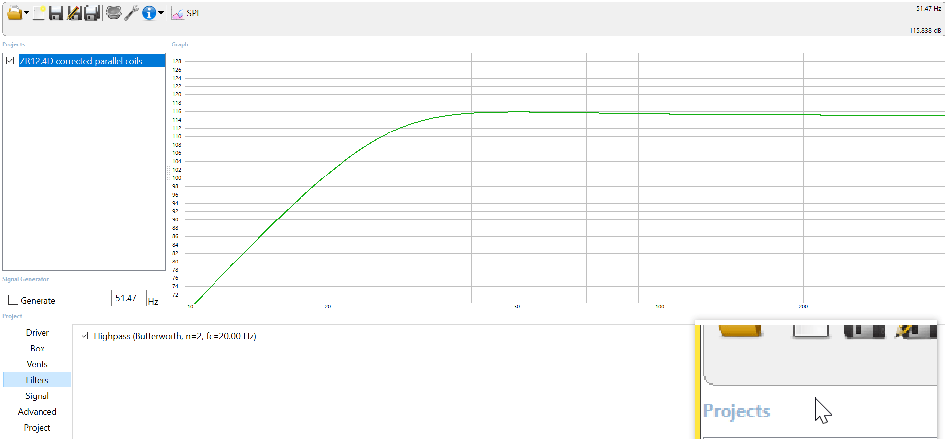

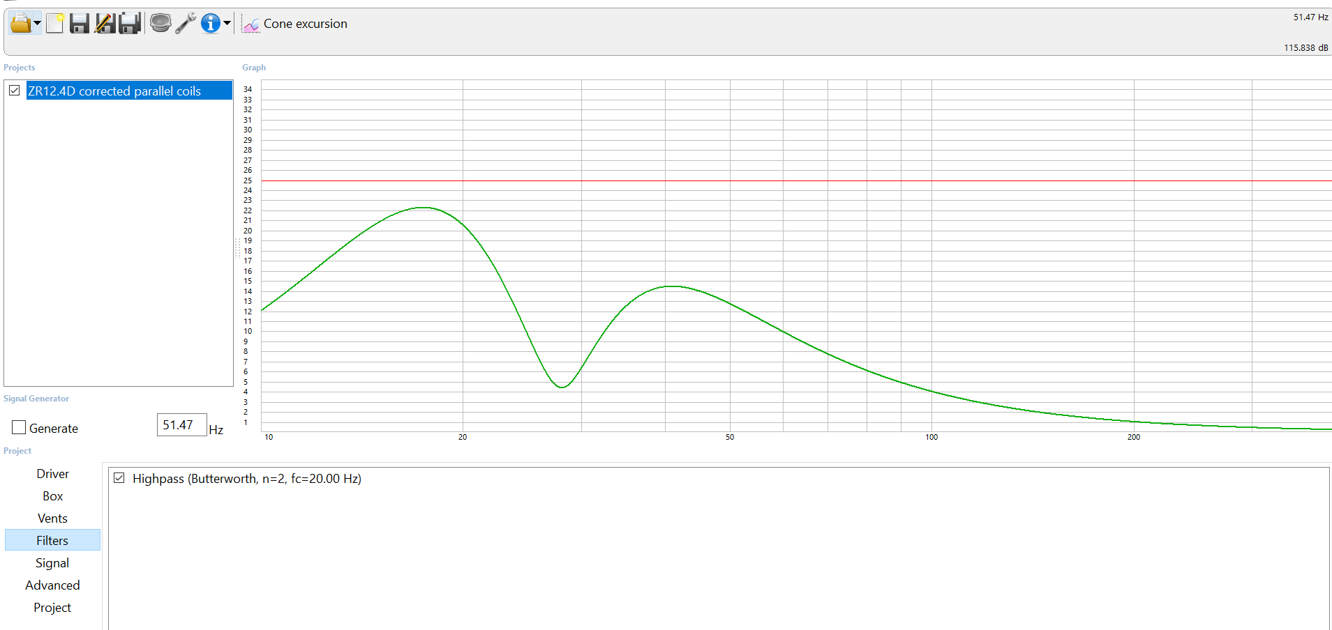

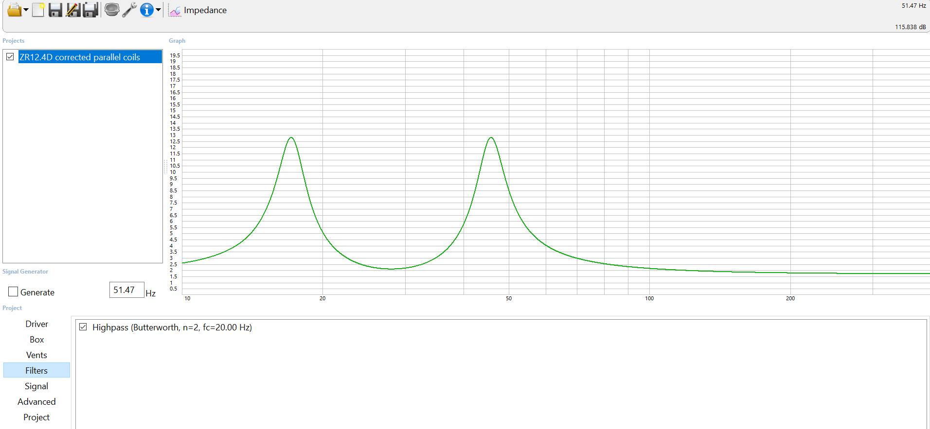

Let's run the mule again. The red trace is the corrected one. That's a big difference in output and response
The mule kicked 112dB over the band! That's 27dB headroom over THX base 85dB and exceeds THX reference headroom by 7dB. Not bad out of a 22L working volume. This now shows the potential to build into a tiny but potent true subwoofer. Hmmmm looking forward to running a fresh sim on the ZR6.4D armed with corrected specs. I wonder if the baby mule can kick too? @weltersys Art, the robot head may work now 😀
How incredible was that, I had just made up some wild assumptions based on instructions for HR and plugged in what I thought would be 'corrected' numbers, and returned to the thread to see your attachment. That pretty much confirms @1 coil specs need adjusting for WinISD parameters inputAll I have left is Ron E's DVC chart (attached) which I now see at a glance answer's at least some of your Qs
There is still a problem though. WinISD returns incorrect values for Bl but correct values for Vas if the Bl value is input from the datasheet, then it returns incorrect Vas. The Qes is set as Qes=Qes/2 while all this is happening. David also found this case while trying to help figure out data entry for HR, that there is an anomaly with the listed Bl
What is the weaker number? the 10.9 in the spec or the calculated 14.9? Letting WinISD calculate Bl and Vas also returns 89dB as the sensitivity
I need to understand Bl a bit better

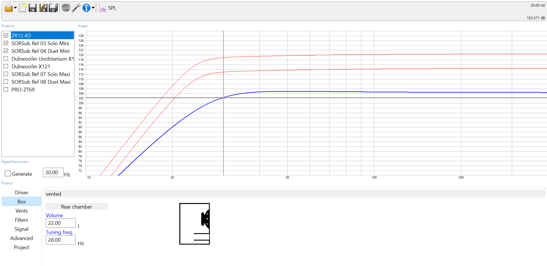

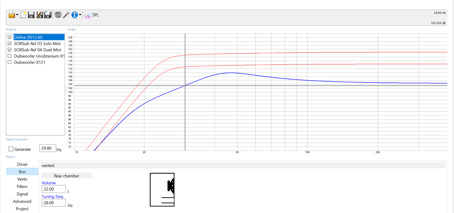

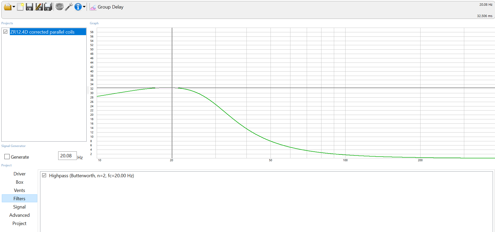

Starting with the bird in hand, the ZR12.4D, let's push it to a low extension config and a high output config in BR/PR. This is the native response with Vb=Vas and Fb=Fs. Amp is 1kw per voice coil. No Eq but there is a 20Hz highpass

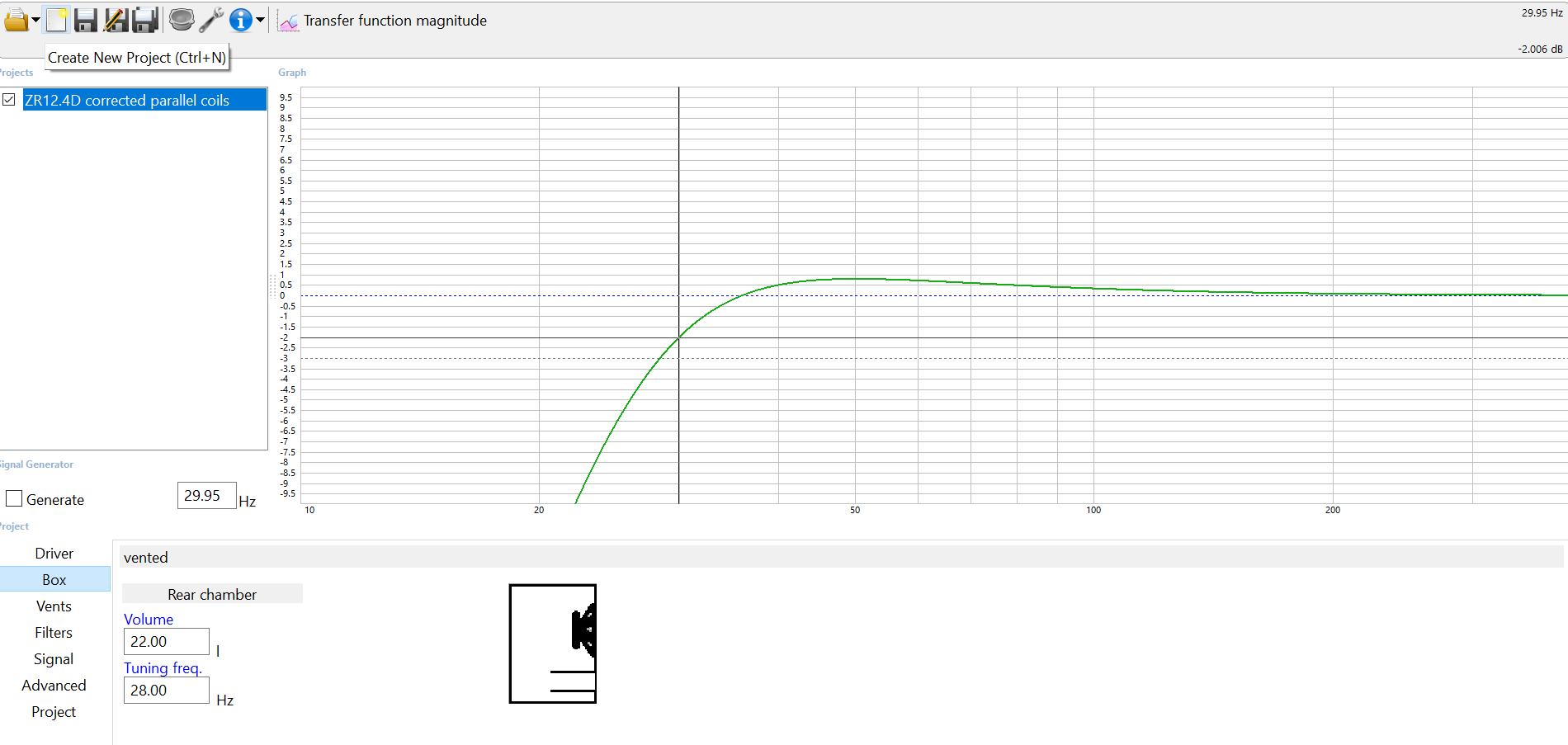

Ok, after all the corrections and letting WinISD workout the Bl and Sensitivity, this mule is kicking low and hard. 115dB is 10dB above THX reference. I won’t bother tuning this lower or with a port. This driver is destined for just enough box to wear dual opposed PRs if it is to be a true sub. With only 22L driver working volume, any low reaching port system becomes a two step TL
Can she be pushed for high output? Is there another that will beat if for 33-43Hz tune out of 30L driver working volume?

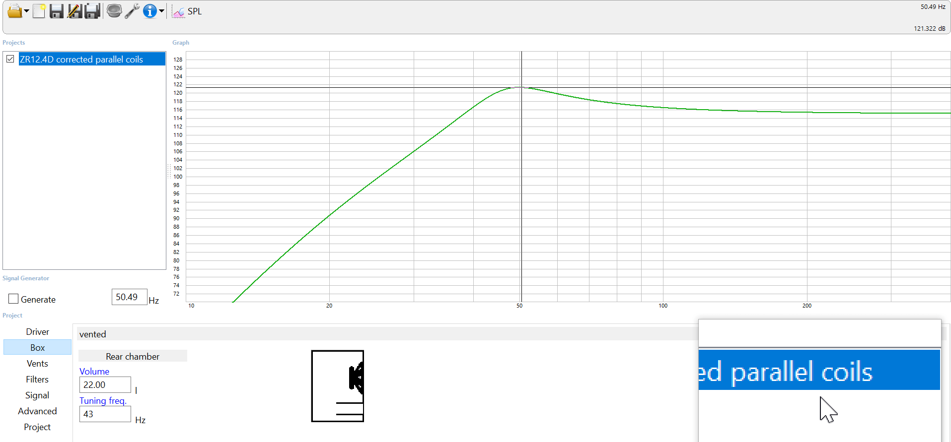

Tuning raised to 43Hz in the same 22L

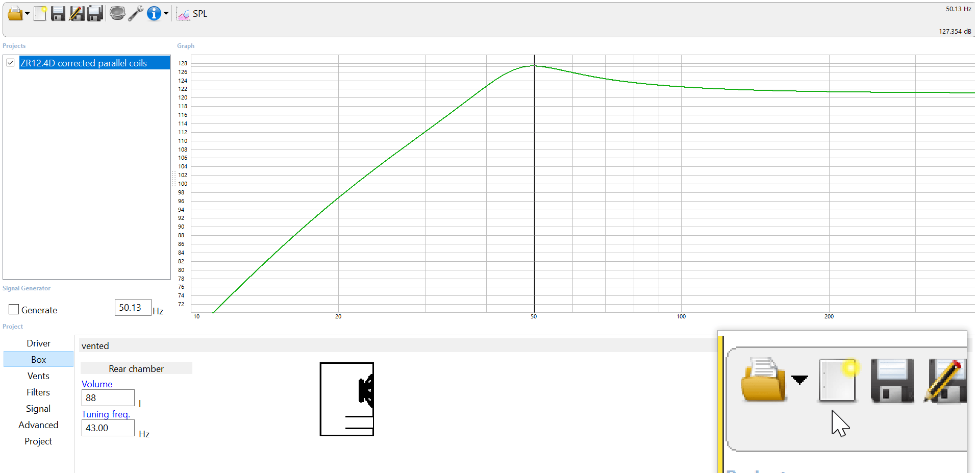

Would I be correctly looking at output for 4x drivers if I increase box to 88L? Trying to predict Twin x Twin in stereo array
