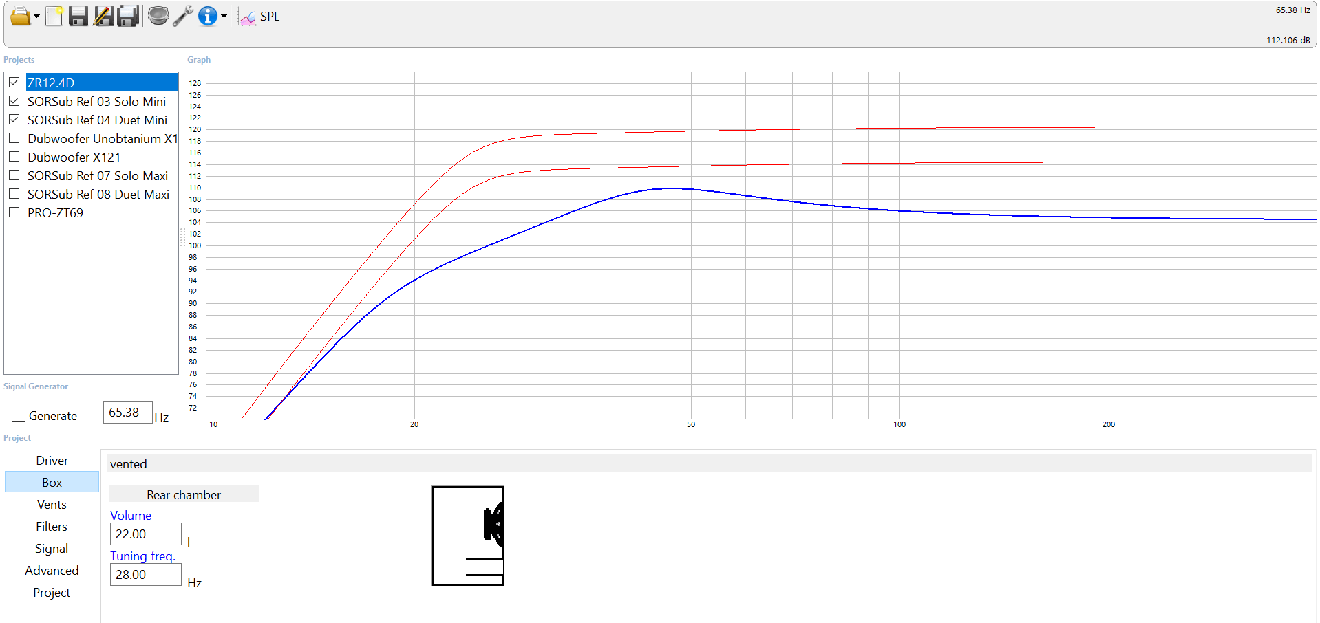

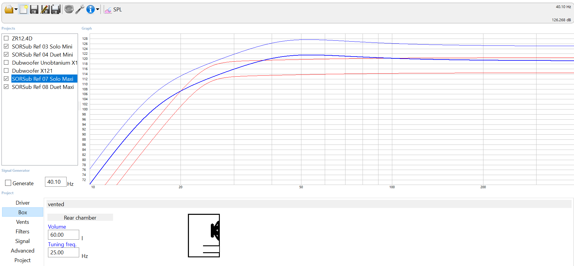

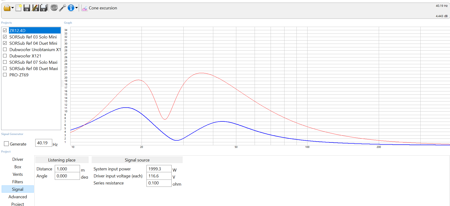

Sims of a single 15 with the 60L of the dual 12s behind it looks good enough to add as 15" virtual reference. Thats the lower blue trace with the same power as the single 10 in lower red trace. The top blue trace is the dual 15 with 120L and the same power as the dual 10 in the top red trace. So four virtual reference subs now and I think at some point I want to hear a TL with these 15s

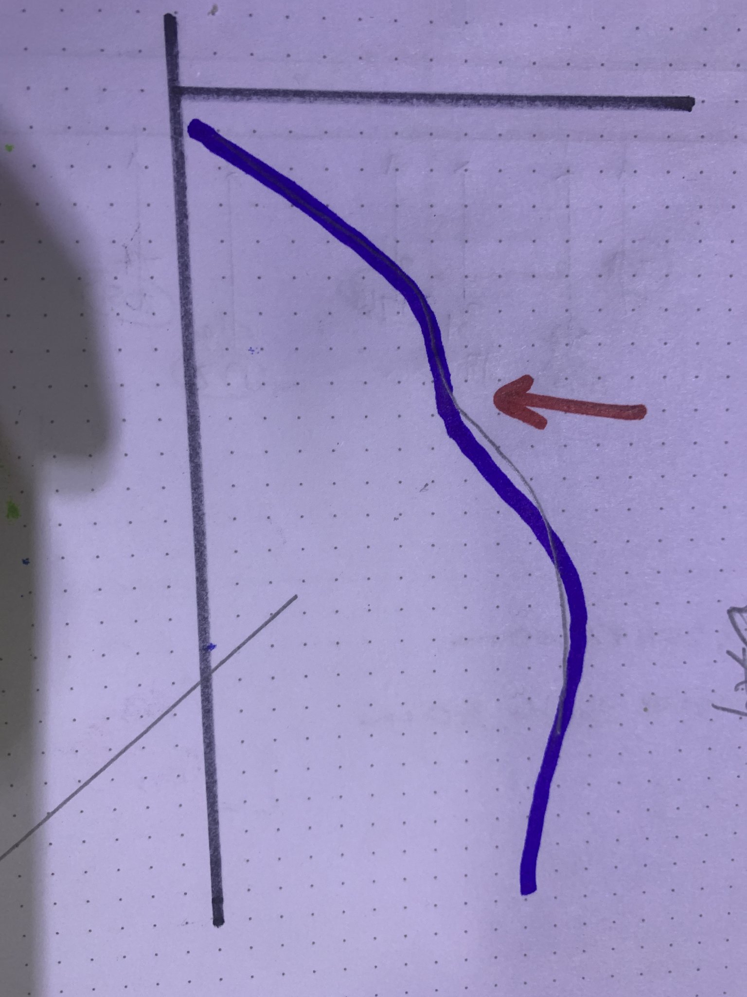

Hey band pass man, what do you think? Can the dropping response on either side of the hump on the ZR12.D be lifted by bandpass port either side of the driver? I mean the driver would have to be enclosed with a ported volume either sideBandpass for life!

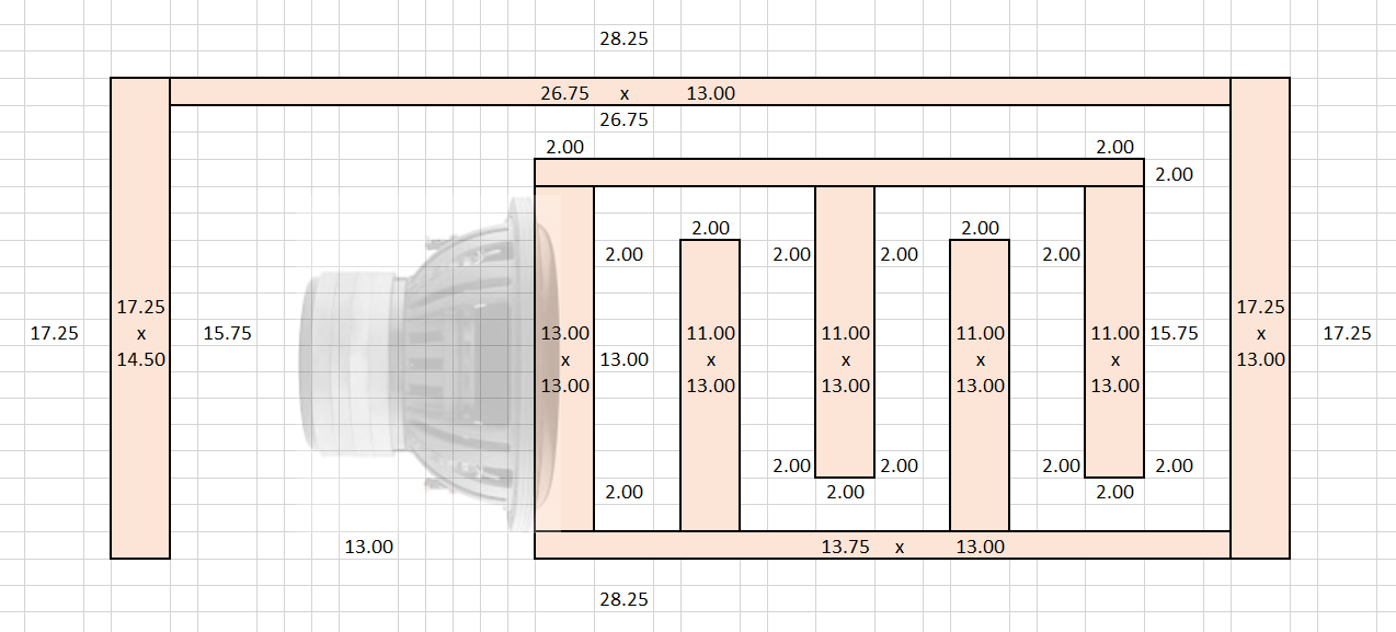

Any fold will increase turbulence, so the effectiveness (linear output for enclosed volume) of the flared port would be reduced.Thanks for the tip Art. I can't help but wonder if a rectangular cross-section with those twin flares can be folded in half without suffering?
That said, it would still be more effective than a non-flared folded port.

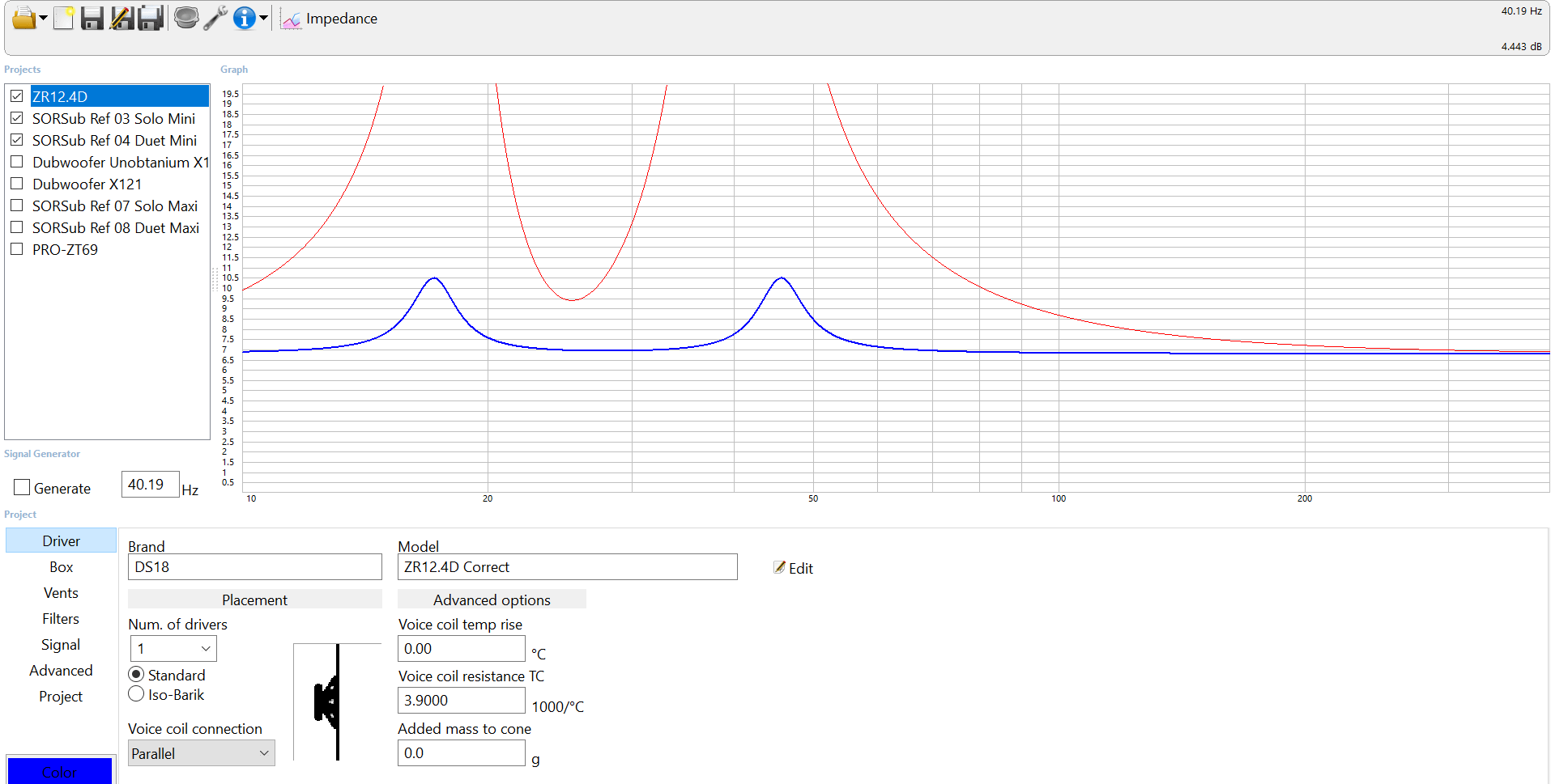

The blue trace in #37 reads lower than the others.Also, am I reading the larger ZR correctly as being too quiet for a 12"?
It looks like it's box may be undersized, and the tuning is lower than the red traces.
Too many variables (what is "full power", Fs, impedance, excursion,HP setting etc.) to say more from the screen shot.
Ok, thanks. That's good to know about folding. That just might get me the look
Full power is driver Wrms rating, or each module is 1kw when the driver w is higher. One module per voice coil, so four modules for the dual driver systems so lower red trace is 2kw and upper is 4kw. No Eq on any of the models and all running high pass 20Hz
The ZR12.4D opening trace in WinISD was so dismal and the response so hard to flatten that I didn't bother with going into too much detail. Let's see what ails it
With a 52.8 EBP, the driver should be used in a Sealed or BP4 enclosure.

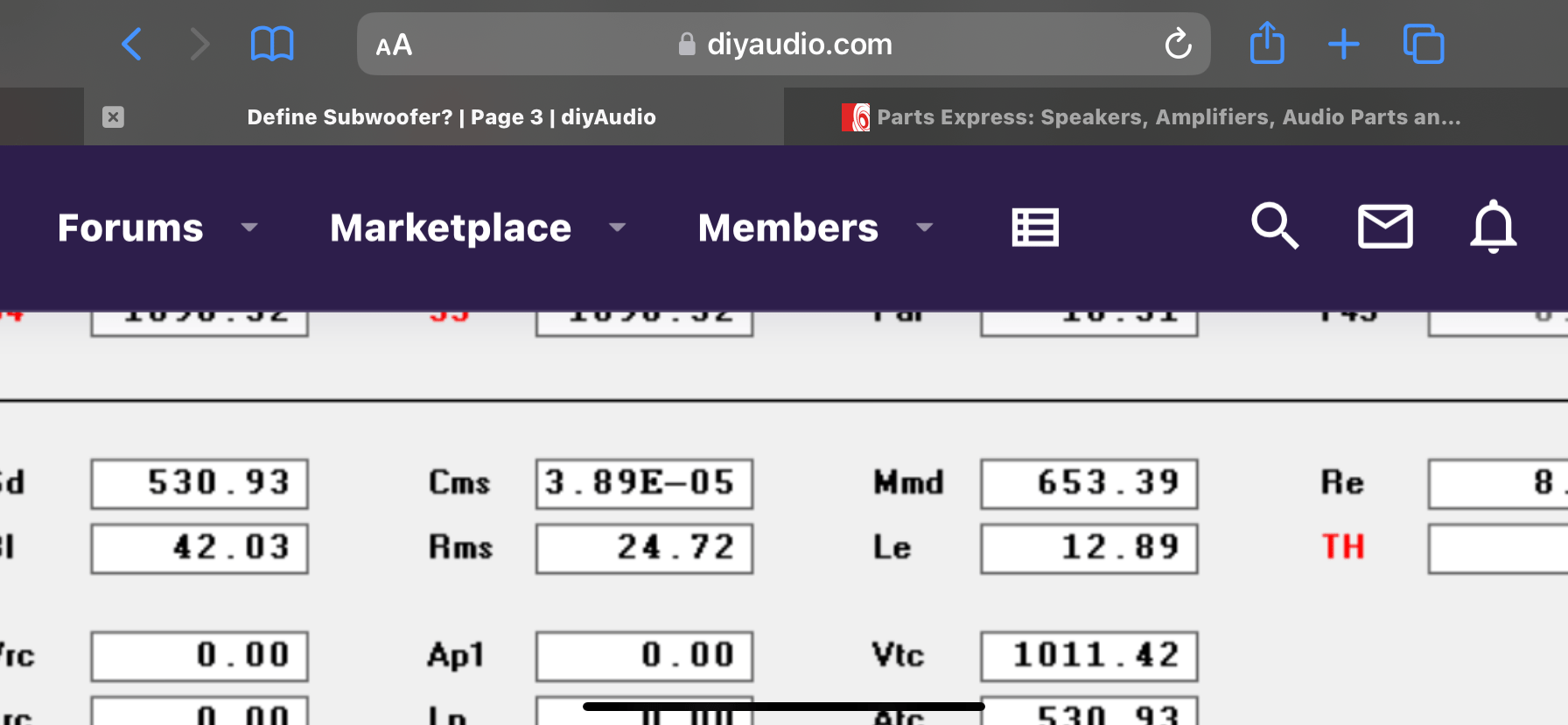

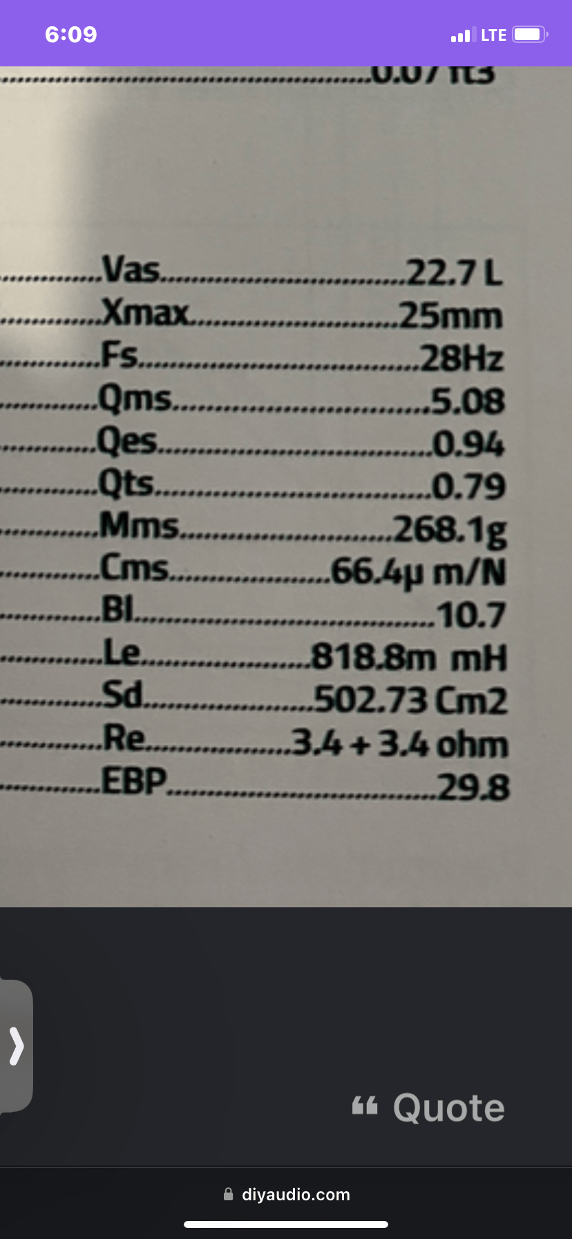

Hey man, thanks for running those, but that's not the driver. The mulish one is the ZR12.4D. I wonder how to provoke it to kick. Anyway, those numbers look good, but there is plenty of alien stuff with HR. For one thing, whats going on with that format for Cms, how does one convert to that? And so on
The box was set =Vas or 22L and tuning is = Fs or 28Hz and manipulated in all directions, but she refuses to let the 'unchit' down. !kw module on each coil for power headroom for any DSP work. The Virtuals are running 30L and 60L with 25Hz tuning

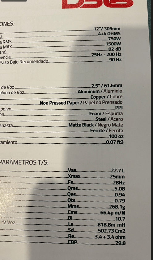

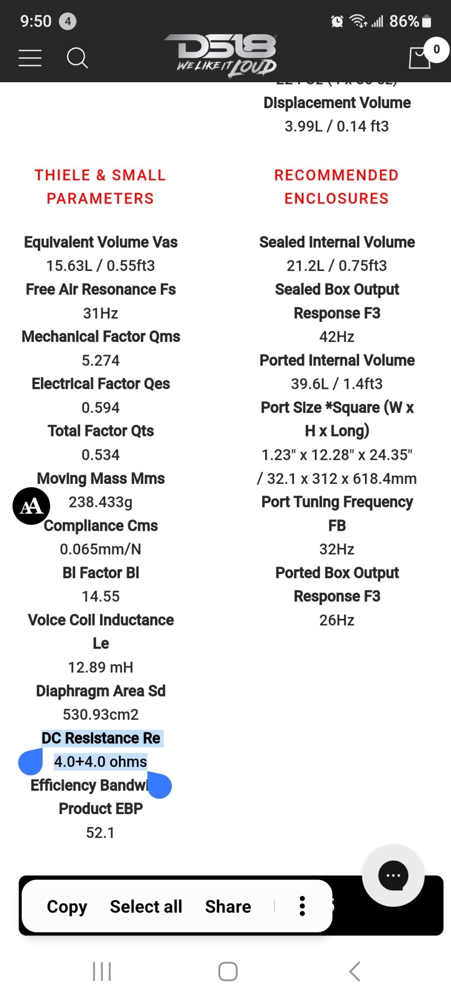

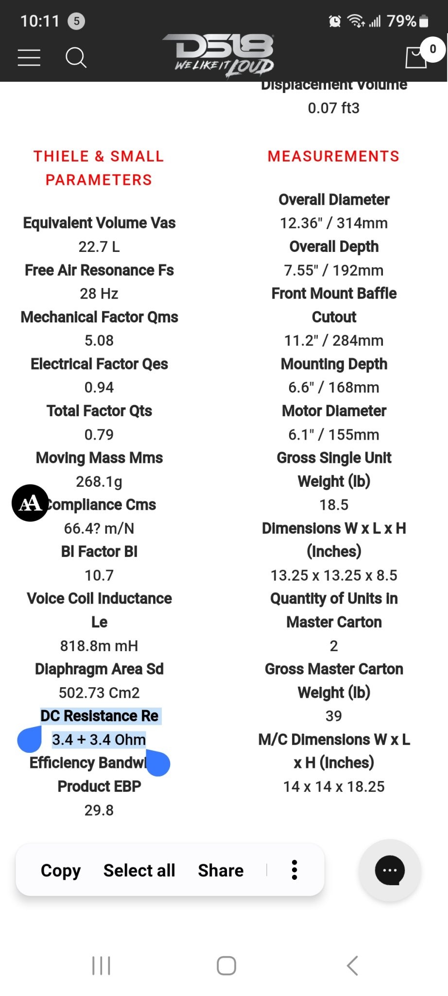

‘attention patients: will the real ts parameters please report to the nurses station for a full cavity search and inspection’ 😝. Are these supposed to be ‘real’?
Right! The DS18 website only gives 4+4 ohm for Re. I had to go to another website to get the 32mm xmax.
The DS18 website still doesn't show the 25mm xmax for the ZR12.4D.
At least Re looks more realistic with 3.4 + 3.4 ohm.
https://ds18.com/cdn/shop/files/ZR12.2D_-_ZR12.4D_-_SUBWOOFERS_MANUAL_WEB.pdf?v=360461080284055225

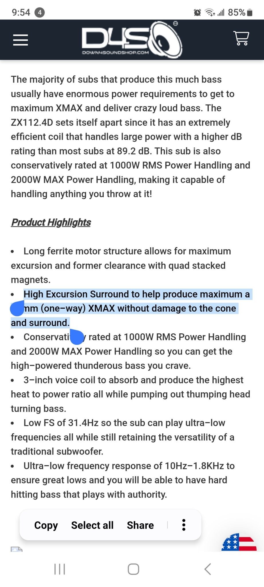

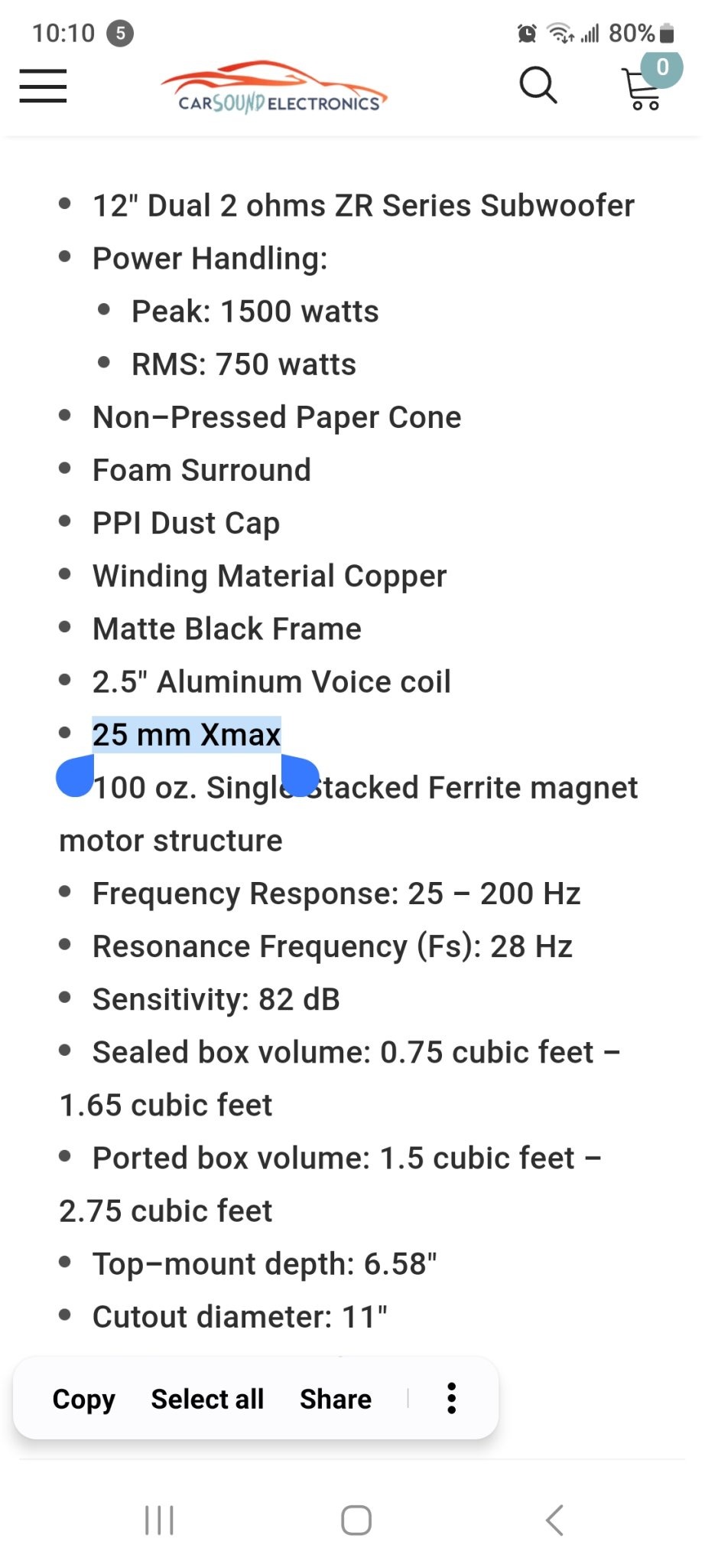

The datasheet shows correct values for Re for both 12.2 and 12.4 model but missing the Xmax. Earthquake Sounds way of listing Xmax makes the one way rating used by DS18 look bad!
The manuals have recently been updated online. I have saved some older manuals containing Xmax for some of their other drivers that I am interested in and these have the Xmax info
Better yet, there is a manual in the driver box

She is chunky for sure but that low 82dB sensitivity? I think I should have paid more attention to that. I was so focused on finding the smallest Vas, that I missed noting that 82dB

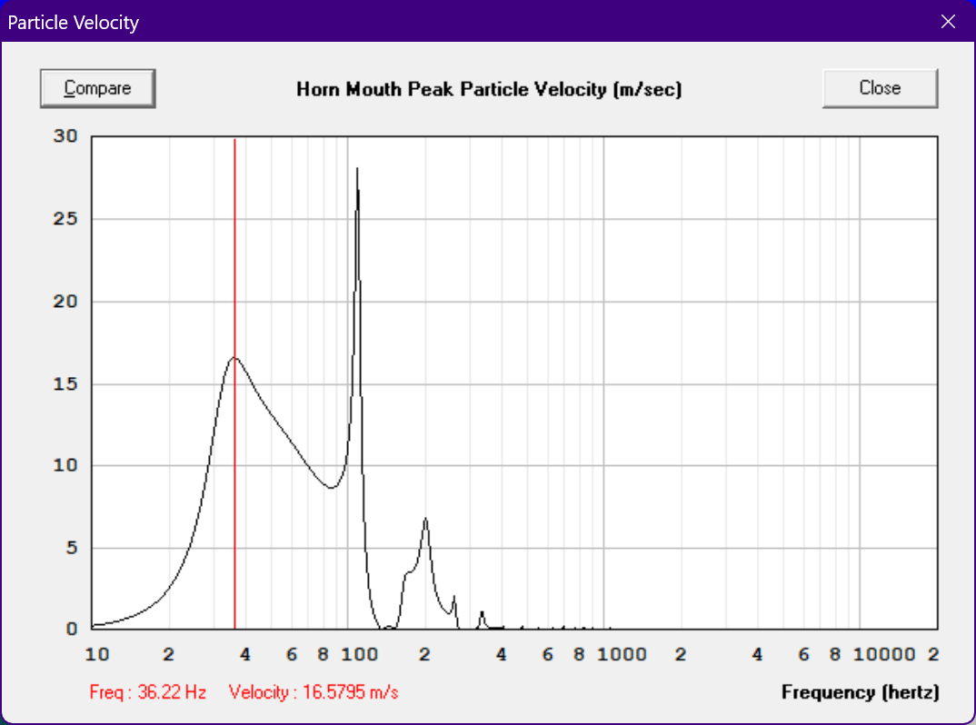

- Subwoofers
- Define Subwoofer?
