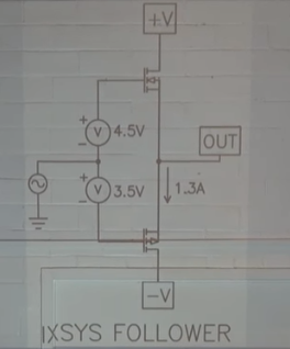

What about the mosfet route- depletion mode mosfet?

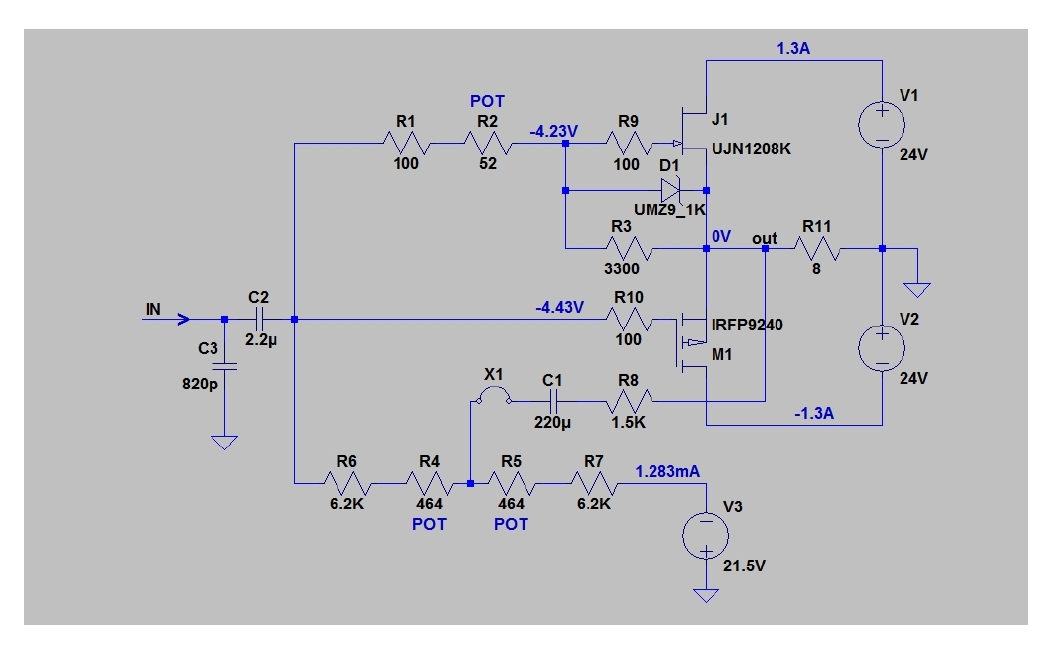

Hi Vince, I also find the UJN interesting. I try a follower topology sim with the help of a couple of pnps.Can this jfet work?...
And this makes it difficult to match to a P-ch enhancement mode mosfet...
But you could easily use a conventional bias voltage network to get
what you need, attaching the P ch Gate to positive and so on.
The same approach that was applied to the IXYS Follower can be applied to a less than perfectly matched depletion mode N-ch jfet and P-ch enhancement mode mosfet? Only drawback is that it's not as simple and self-contained as the schematic in post #1?

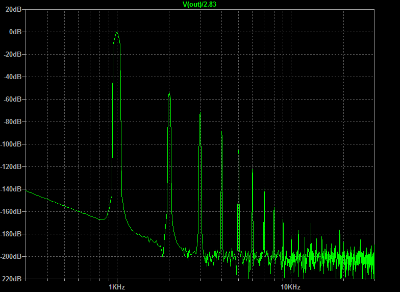

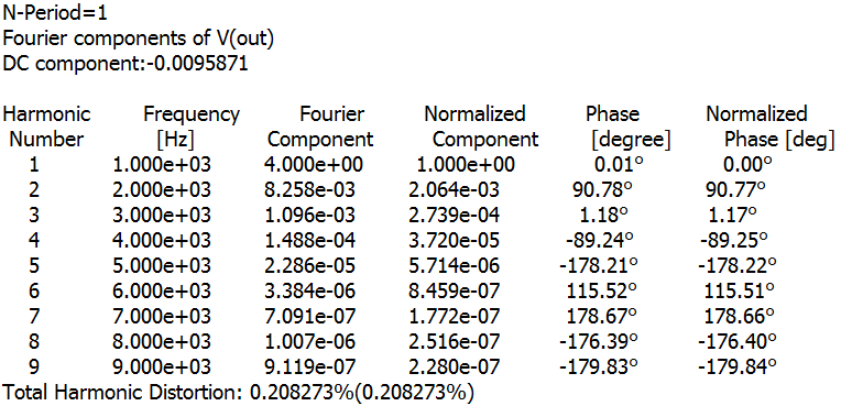

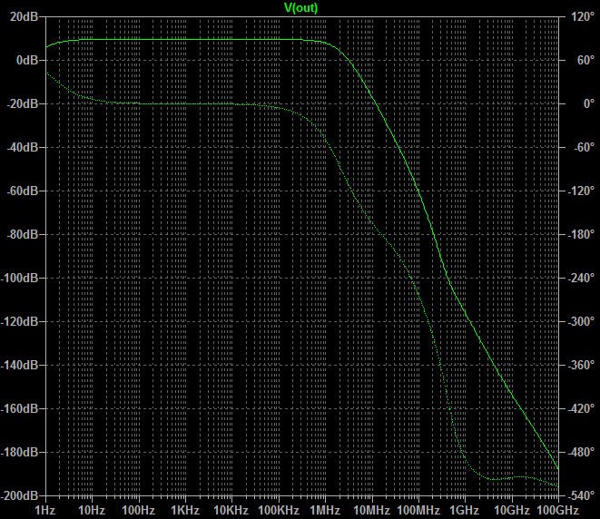

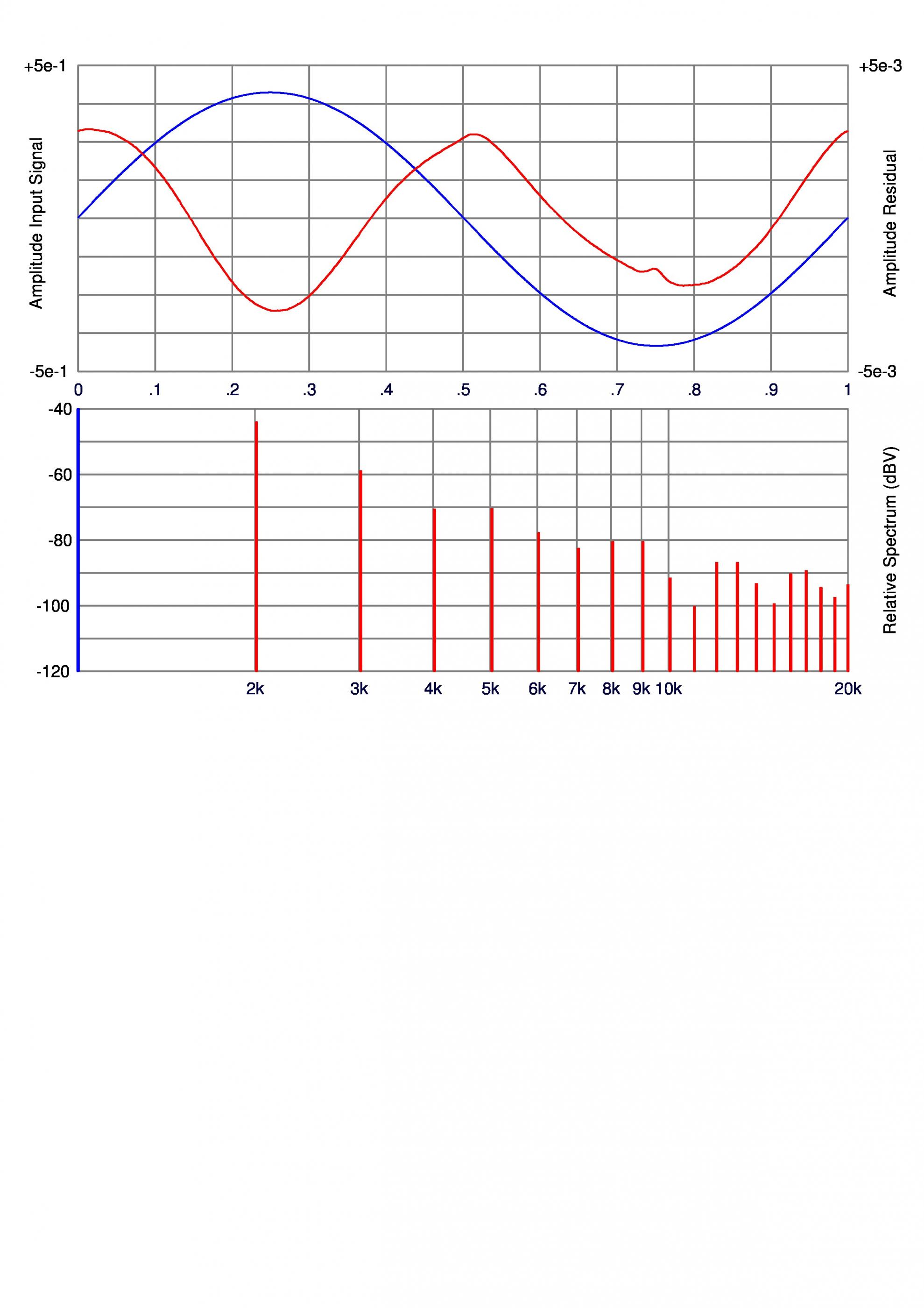

Hi vdi_nenna, this is my last experiment with a DEF amp. I hope it help you. The thermal coefficients of the two FET and the resistor network stabilize the amplifier. The main harmonic until the clipping is the second(Vout=10.55Vrms).
The Vgs of the JFET can be a problem. See post #149.

The UJN120K is at end of life. However, there are two suggested replacements on right side of the web page at Mouser Electronics. Can one of these be a suitable replacement?
UJN1208K UnitedSiC | Mouser

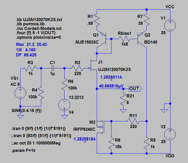

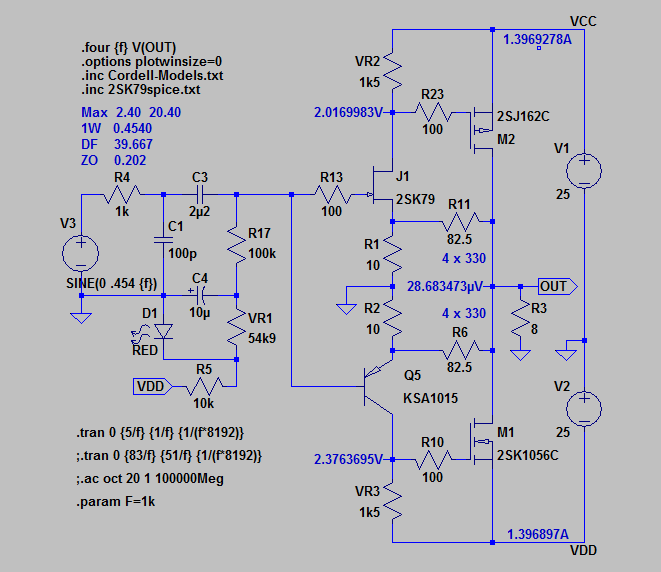

F5 topology, 2SK79 SIT DEF style at input, Lateral output
Good news guys, I found another one to spook you. Currently just a sim, a small SIT 2SK79 paired with a bjt DEF style performs well in the F5 topology with the lateral MOSFET at the output. H2 / H3 is predicted to be close to SIT3 with damping factor ~40.
