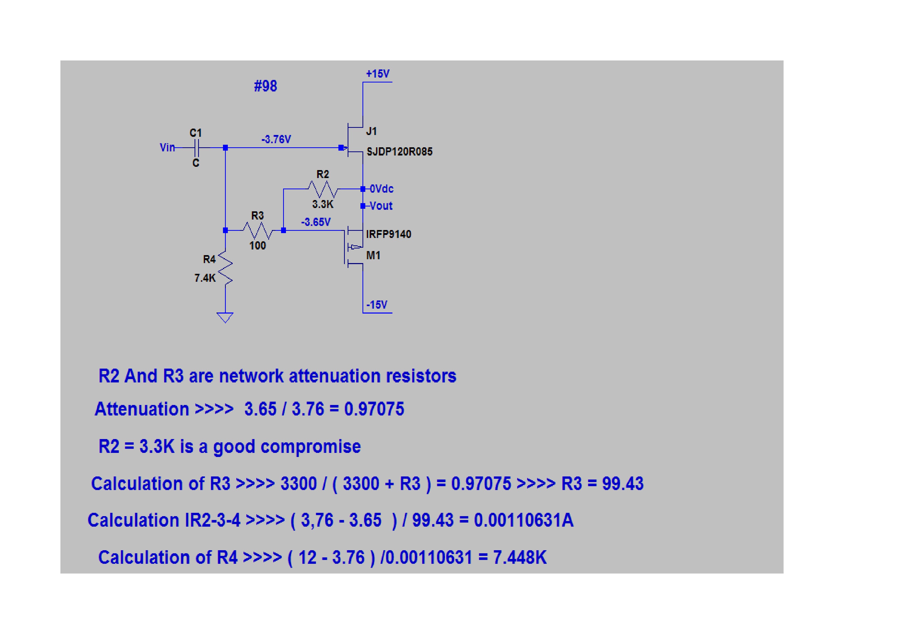

Hi chul, The resistance network illustrated by Mr Pass is a simple and elegant solution.
I hope this helps.
Thank you Claudio,
Now I see how the calculation. 😀 May I ask more questions?
Vdc at output is 0 not to use the capacitor. But you need to adjust the Iq to some value, say 1.5A, which is subject to other conditions like Vds. So these affect each other..? Are the -3.76 and -3.65 are fixed values that are determined before?
What if I just use output capacitor? Does this make it easier?
Thank you in advance.🙂🙂

Hi Chul, Vds and Id are initial project data. I chose +/-24V and 1.3A. With the two data have to measure the two Vgs. The test circuit is in posts #90 and #93. You have to wait at least 30 minutes for everything to stabilize. The two Vgs must be as close as possible. Before building the DEF, try to simulate it. It's not important which NJF you will use. This will allow you to understand that to reach 0Vout a precise resistors value is necessary. As shown by Antoinel it will be necessary to add a small trimmer to R3.
Imput impedance will be low. This will also be evident in the simulation. To increase it you can use the bootstrap capacitor and increase the -Vdc of the resistors.

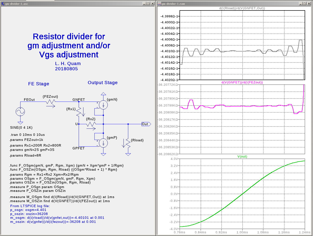

Here is a way to see the gm of the output stage and the input impedance. Look carefully at the expressions in the top two plots, the .measure commands in the .asc file, and the resulting log file output.
Thank you, very very interesting

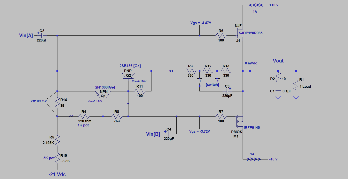

New DEF Schematic
The attached is a new DEF schematic. Some details are:
1. I used a fixed +/- 16 Vdc PSU. Idle drain current for each FET in DEF was 1 Amp.
2. DEF can use Vin[A] or Vin or [Vin A] plus Vin simultaneously. The line amp sourcing the two identical Vin[A/B] is a CD player's headphone output. It has plenty power drive.
3. The hypotheses therein circuit are that the BJTs do error correction, bootstrap and possibly introduce positive current feedback [PCF] inside DEF. If this hype is valid, the added complexity beyond that of the basic DEF by Mr. Pass [meaning no BJTs] maybe accepted as valuable.
4. This DEF embodies several operational variables. For example by using Vin[A] or Vin or Vin[A+B] to name a few. May have a positive and/or perceptible effect on performance.
5. DEF sounded great [as an example] with the input signal simultaneously injected at the gates of both FETs [why not for a change?]; meaning {Vin [A+B]}. And the output capacitor [220uF] was also engaged at position 1 of the switch. This cap is believed to alter the gain of the BJT complex.
6. The shown BJTs are both Germanium. Delta Vgs of the FETs was ~0.75V. It is also called the [Vcb] for 2SB186. I felt this Vcb may be too low to allow for the proper operation of a typical Silicon BJT; like 2N3906.
Best
Anton
