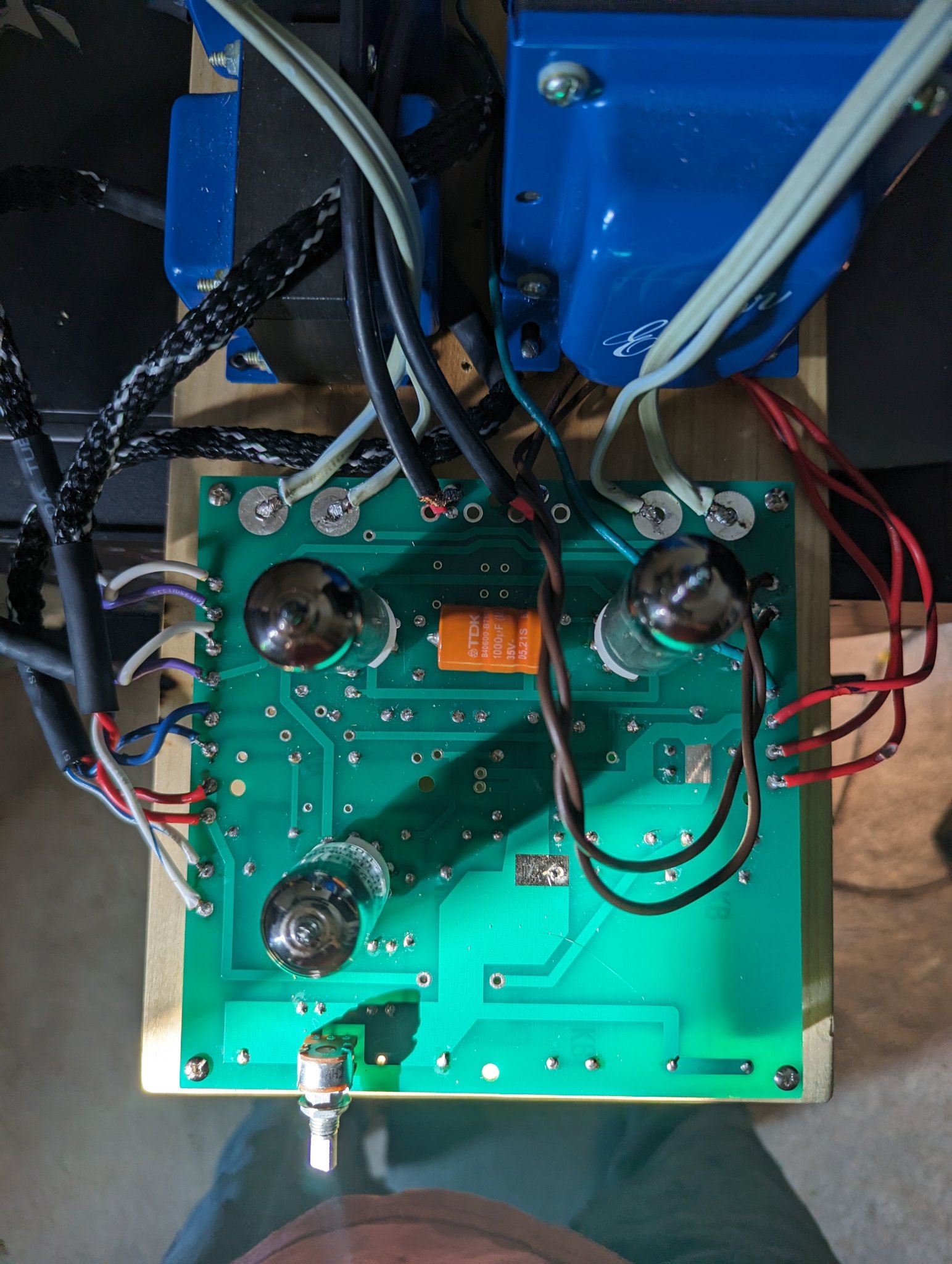

At this point I would resolder the two filament transformer wires, even though the sockets seem to have 6VAC.
The fact that the input tube has plate voltage, but does not conduct, seems to indicate there is no filament voltage.

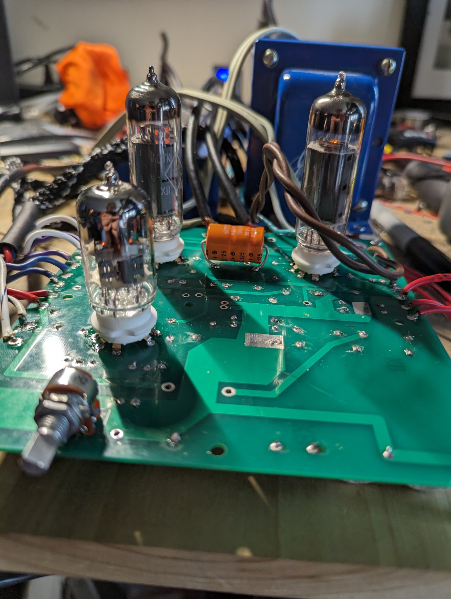

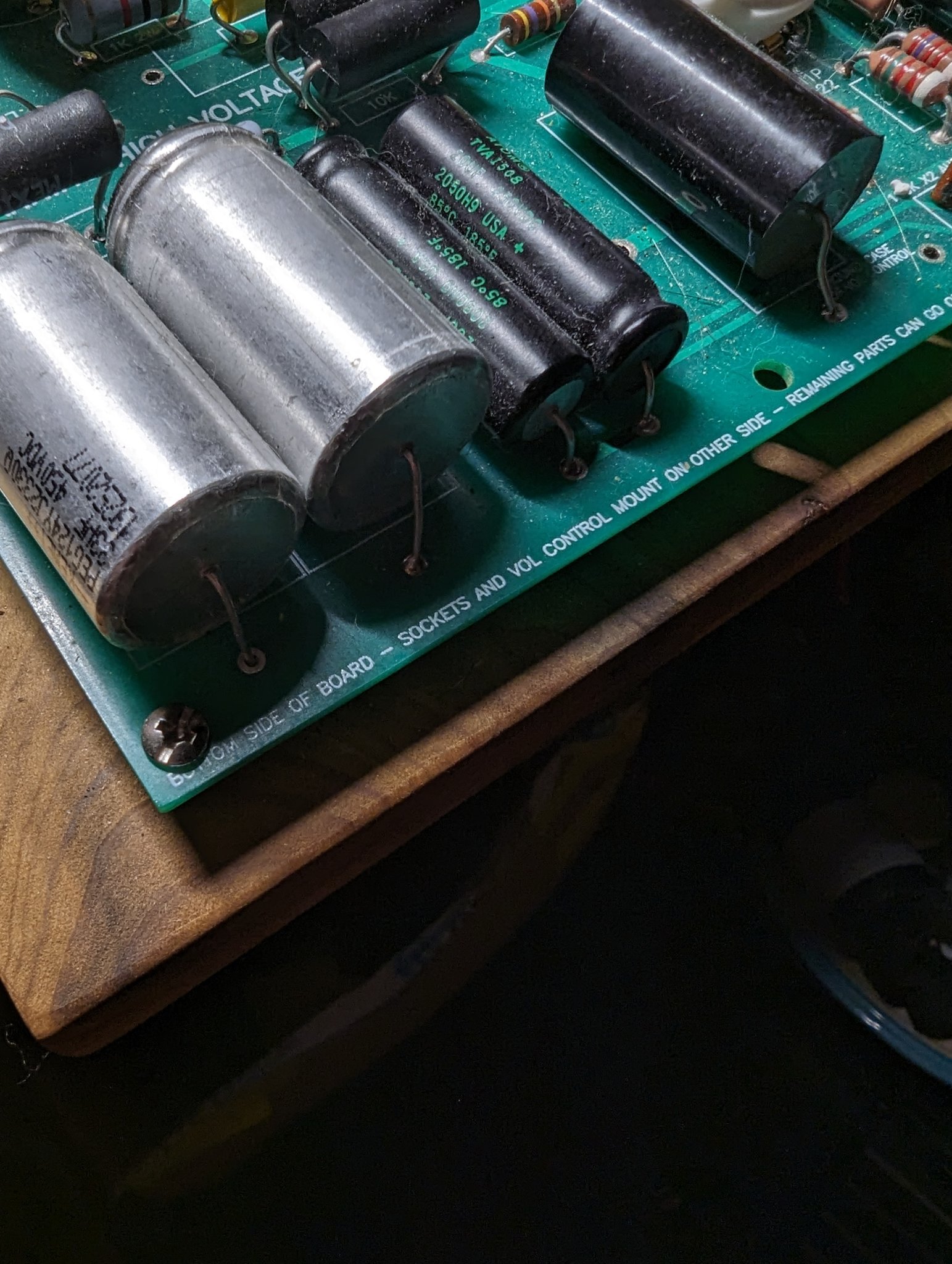

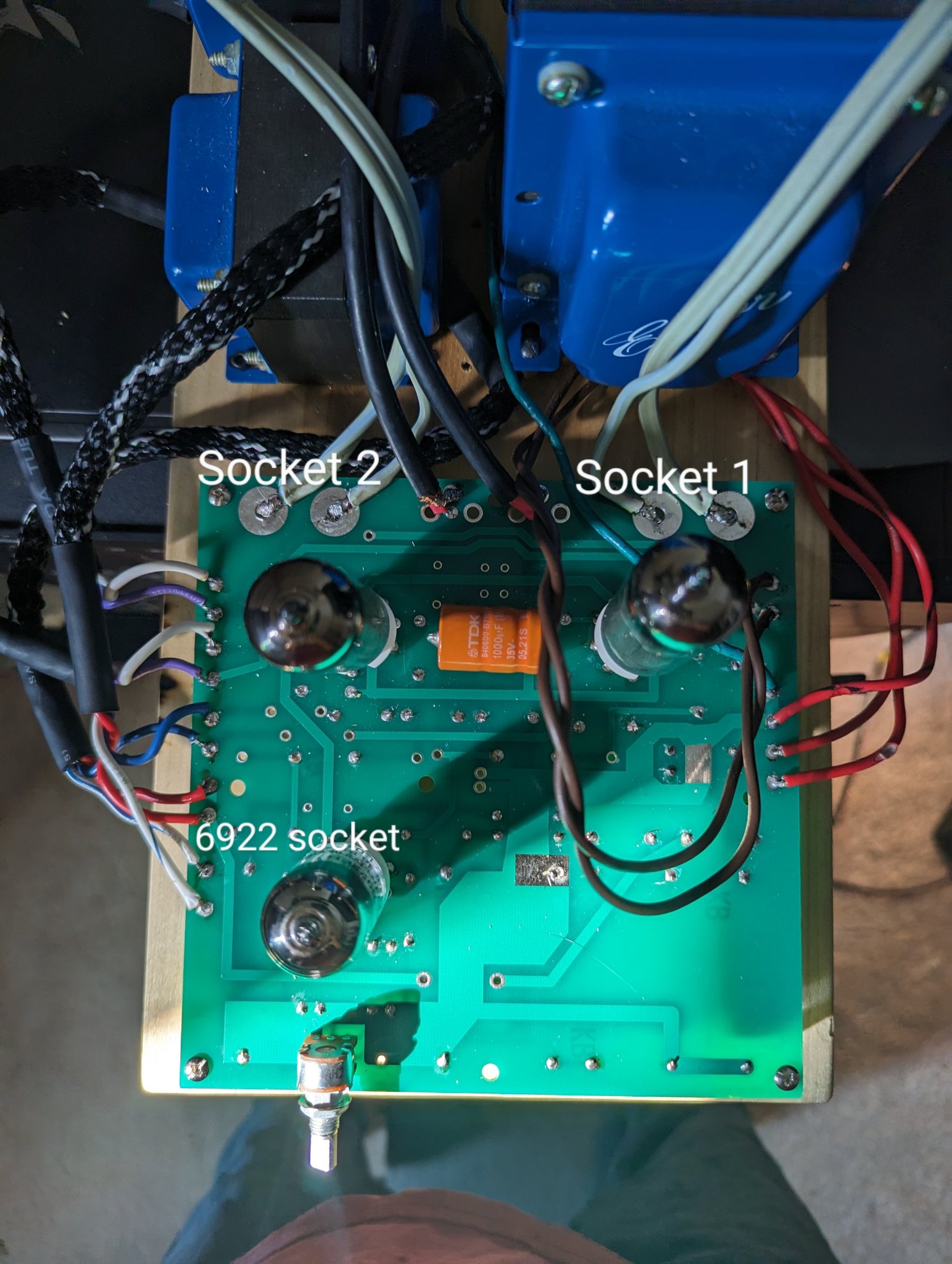

I just noticed that I have these boards populated entirely upside down, including the tube sockets. Would this not change the pinout of the tubes in relation to the board? Am I an idiot?
I figured I'd ask before going to the work of somehow removing those tube sockets and flipping them to the other side.

Wait, the parts are on the wrong side of the board?
That won't work since the tube pinouts for the sockets are not symmetric.
Parts with two leads will not be affected.
Check again to be certain the sockets are on the wrong side of the board.
If so, remove them and mount on the correct side.
Volume control as well, since it is not symmetric.
Reactions: Ixnay

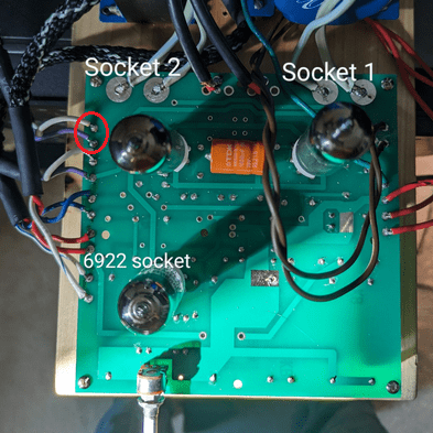

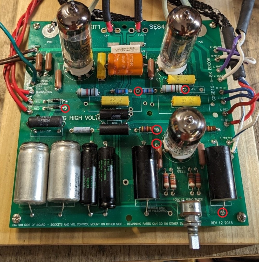

So I got that dumb mistake fixed and now all the tubes light up as they should, but test point A has 380VDC and test point B has 415VDC, C measuremes zero volts, D on the 1.5K resistor measures 50 millivolts and the 2.7K resistor measures 4.2V.
Something still seems to be off, but this is an improvement.

Sorry for the delay, measurements of the tube sockets below
Socket 1
1= 0
2= 600mv
3= 0
6= 15mv
7= 62mv
8= 5mv
9= 70mv
Socket 2
1= 0
2= 30mv
3= 0
6= 0
7= 830mv
8= 0
9= 830mv
Socket 6922
1= 143v
2= 0
3= 4.3v
6= 0
7= 55mv
8= 53mv
9= 0
The only number that makes any sense is the #1 pin of the 6922 at 143v. That might actually be close to being right. And there's voltage at the cathode, so that's one triode section functioning. Doesn't appear the other tubes are conducting.

Seems to be more than one problem.
The input tube has one section dead, maybe its plate resistor is not connected.
The output tubes are dead, maybe the output transformer has a bad connection.
We know the B+ is there, just too high due to little loading on it.
Probably there is noise on the red/black connection.
