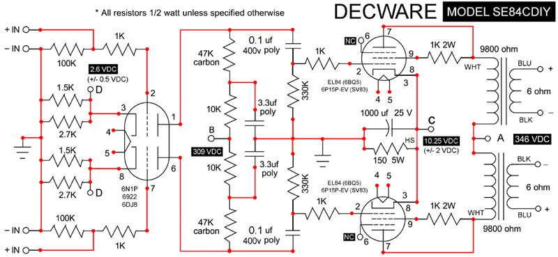

At last, a DIY Kit from Decware that's affordable! Only $299
Some changes from the regular SE84C:
Solid State rectification Vs Tube rectification
Circuit board Vs Point-to-Point wiring
Assembly instructions lack some important steps
but okay for those with tube amp building experience.
The assembly instructions also include specs from the
standard model including wording stating that the unit
is point-to-point wired while it is a circuit board model.
Looking forward to seeing other opinions on the newest
entry into the kit tube amps.
Chris

I agree. . .cheaper kits would be nice. . .since most of the cost
is usually in the labor supplied by the buyer. Unless it is very
special iron in the transformers.

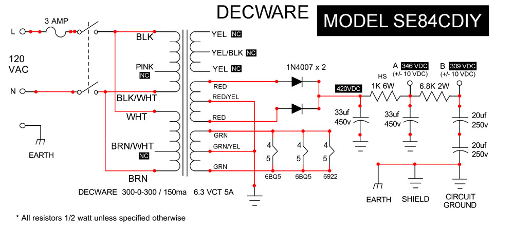

Solid state rectifiers are just as easy to change out as a tube
rectifier; they drop less voltage and run cooler.

DECWARE se84cDIY [$299 w/o tubes] +($50)
(Cost to buy individual parts)
PS
(2) 1N4007 1000V PIV 1A [$0.10 x 2]
(1) 1KΩ 6W [$0.39 Wirewound 10W]
(1) 6.8KΩ 2W [$0.50*]
(2) 33µF 450V [$5.50 x 2]
(2) 20µF 250V [$4.00 x 2]
(1) 300-0-300 / 150 ma 6.3 VCT / 5A
[Hammond 272FX $60 146VA]
[Hammond 372FX $87 150VA]
(1) FUSE Holder [$1.50*]
(1) 3 A FUSE [$0.50*]
$83.00
AMP
(2) 0.1µF 400V POLY SIGNAL [Dayton 0.10uF 400V $0.90 x 2]
(2) 3.3µF Poly [Dayton PMPC-3.3 3.3uF 250V $3.50 x 2]
(1) 1000µF 25V [$2.00*]
(1) 150Ω 5W [$0.24 Wirewound 5W]
(4) 1.0KΩ 1/2W [$0.55 10pk Flameproof Metal Oxide Film]
(2) 1.0KΩ 2W [$0.24 Wirewound 5W]
(2) 1.5KΩ 1/2W [$0.55 10pk Flameproof Metal Oxide Film]
(2) 2.7KΩ 1/2W [$0.55 10pk Flameproof Metal Oxide Film]
(2) 10KΩ 1/2W [$0.55 10pk Flameproof Metal Oxide Film]
(2) 47KΩ 1/2W Carbon [$0.50*]
(2) 330KΩ 1/2W [$0.55 10pk Flameproof Metal Oxide Film]
(2) 100KΩ POT [$3.00 x 2*]
(3) 9-pin mini Ceramic pc mount socket [$2.00 x 3]
(2) 9800Ω PRI / 6Ω SEC
[Hammond 125DSE 10 Watts $35]
[Hammond 1638SEA 30 Watts $120]
$90.00
TUBES
(2) EL84(6BQ5), SV83(6P15P-EV) OUTPUT [$15 x 2]
(1) 6922, 6N1P, 6DJ8 INPUT [$13]
6N1P-EV military spec
(6N1P=higher filament current than 6DJ8)
$50.00
$223 + case/power cord/feet/RCAs/Binding Posts/board would
probably be more than $300.

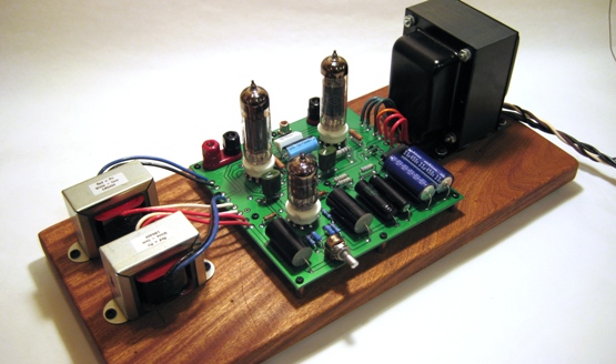

Steve has put together a great kit. It includes the
board but lacks the tubes. . .so Steve's kit would be close
to $400 with tubes and shipping!
PS attached
