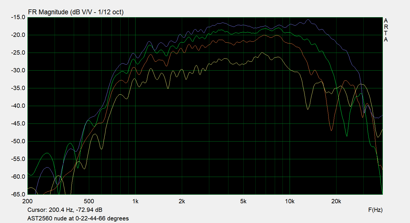

measurements of nude ribbons and a dome-dipole
To save you the clicks, here is the frequency response family and distortion data taken at 90dB@1m:
Looks good to me when crossed at 2kHz. What more could you want?

Actually in terms of the response pattern, the two domes that SL used when designing the LX521 is worse compared to a good dipolar AMT type driver. I wrote about this more in this post:
SL was very focused on other aspects of the drivers themselves, especially on low HD, IMD and energy storage. The tweeters he used are excellent, but together they just don't make for a very good dipole except at very high frequencies. As a result, he has to push the next lower driver all the way up to 7kHz, where it also is not a good dipole. IMO these are weaknesses of the LX521, but speaker design involves tradeoffs. It doesn't make it "bad" per se, but he chose one thing over another because he could not have both.

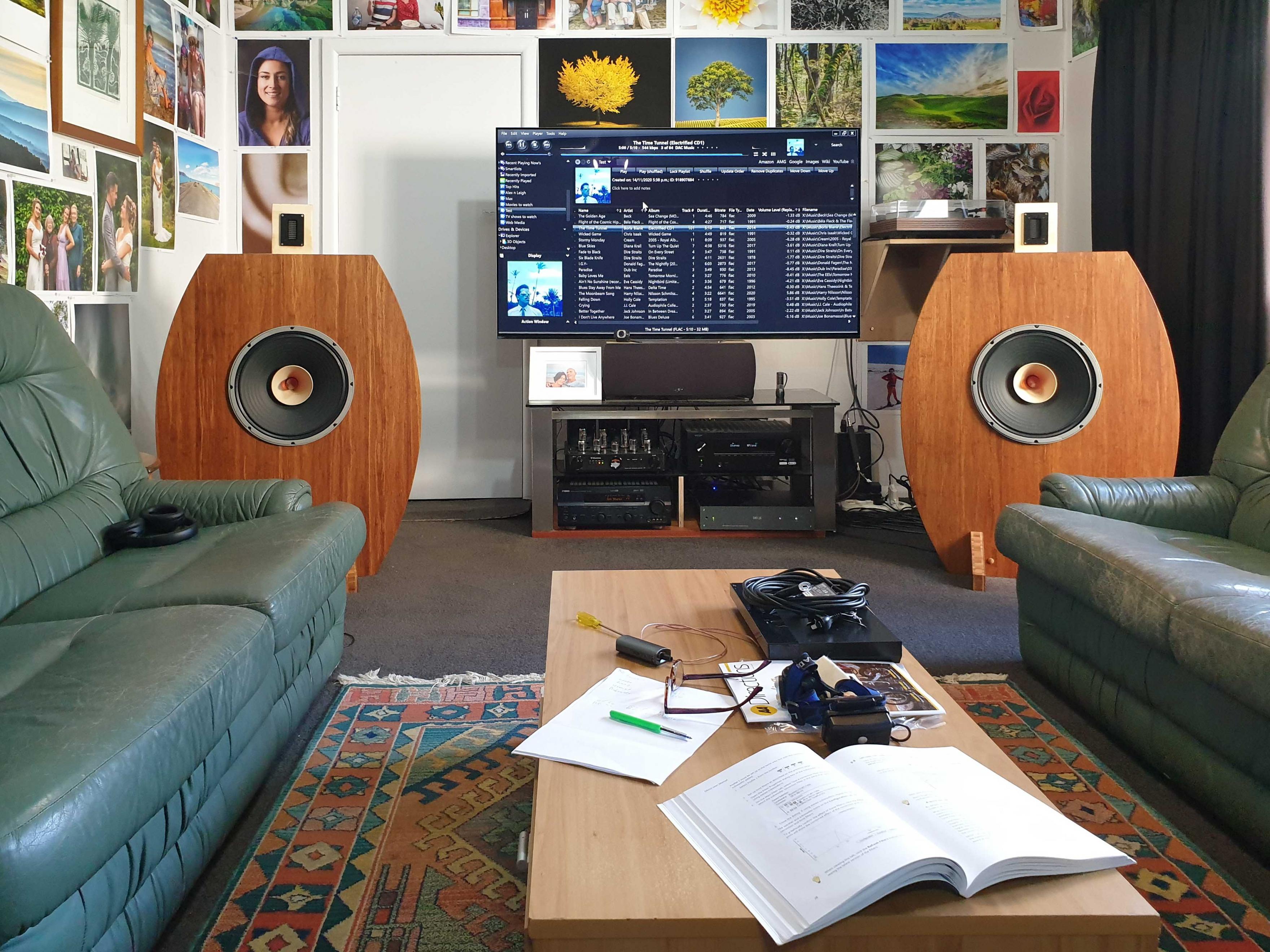

Took the gamble ;-)

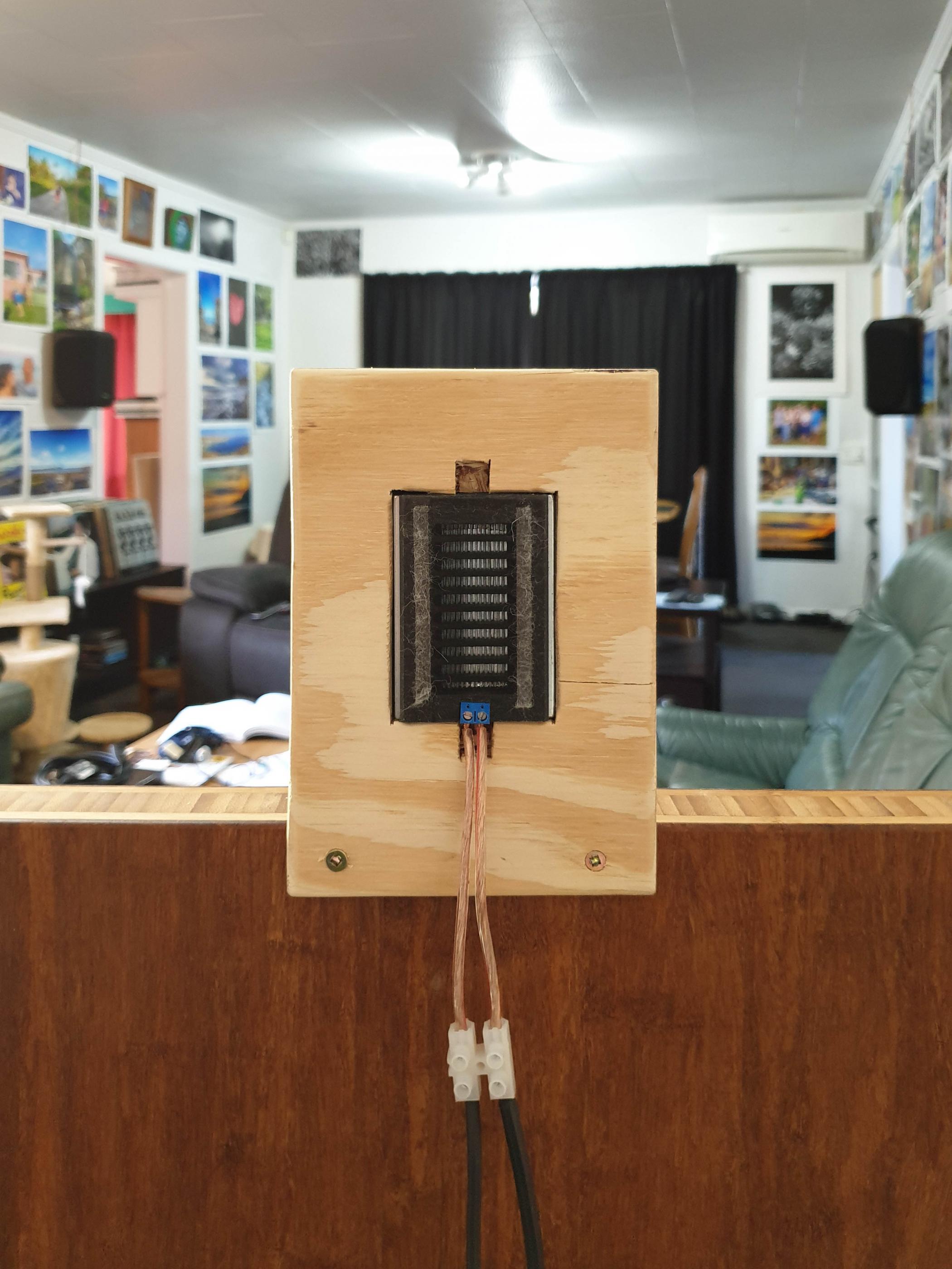

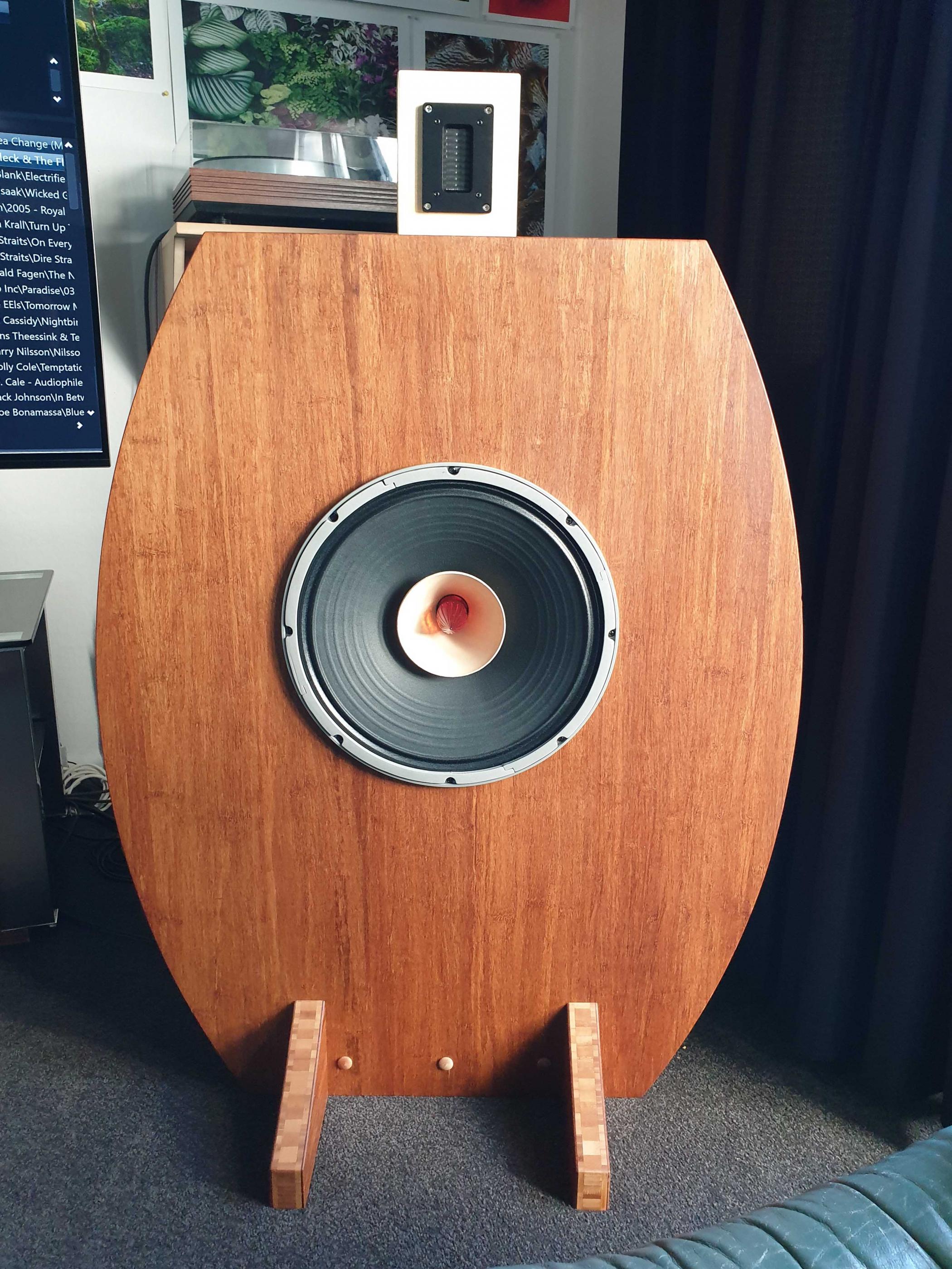

I received the tweeters yesterday and mounted them temporarily on plywood which I screwed to the top of the baffles. I wasn't able to source suitable tweeter-protection capacitors due to our current state of lockdown, so I decided to risk driving them with a 2006 Yamaha receiver. I set the crossover to the tweeters at 2000hz and 48db in the Deqx. I set the Yamaha's gain to 0db which resulted in a pretty good balance with the full-range Lii 15 drivers (sensitivity 97db compared with 95db for the tweeters). They are sounding surprisingly good considering the lack of fine-tuning, the temporary positioning, the un-calibrated Deqx profile, the Yammy receiver etc. I imagine they would only gain cohesiveness if mounted on the baffle near the Lii 15 driver, at ear height. I didn't want to cut a hole to accommodate them until I had some positive feedback from a less than ideal mounting. At present they are about 200mm (8") above seated ear height. They also seem to be remarkably non-directional (non-beaming?). I can move quite a bit (both vertically and horizontally) without seeming to lose the sweet spot, something I most definitely couldn't do with the Maggies. I my have lost some positional definition though - some players don't seem quite as nailed down as they did. Still, it's early days, but an encouraging start. I also have yet to experiment with removal of the faceplate - I did remove one and the inner ribbon slid out of the housing, which felt too vulnerable to me so I screwed the faceplate back on. That didn't secure the inner ribbon though - is that how it's meant to be? (I'll take some pics showing what I mean when I have time)
That looks wonderful.

Great installation in a handsome room. It is unlike 95% of the rooms posted on this forum that have spare furnishings and must sound awful, you have a carpet and stuffed furniture.

If you put the tweeter in the baffle the response will actually get worse. Keep it on top. Reduce the mounting parts to a bare minimum so that you only have the tweeter's own flange. I use this tweeter with the mounting flange removes and it is excellent with the reduced baffle footprint but that makes it challenging to "mount". As long as you don't sit closer than 2m the pathlength difference between drivers will not be too exaggerated and since you are not dialing that in with measurements anyway, why worry about it?
I can hear the F15 singing the 'straights tune "you're so far away from me". I'd think 2k xover would want the tweeter butt up against the flange of the F15. Yet, you cant mount it into the baffle - it has to be "nude" flying in space with nothing about it. How's that going to be solved?

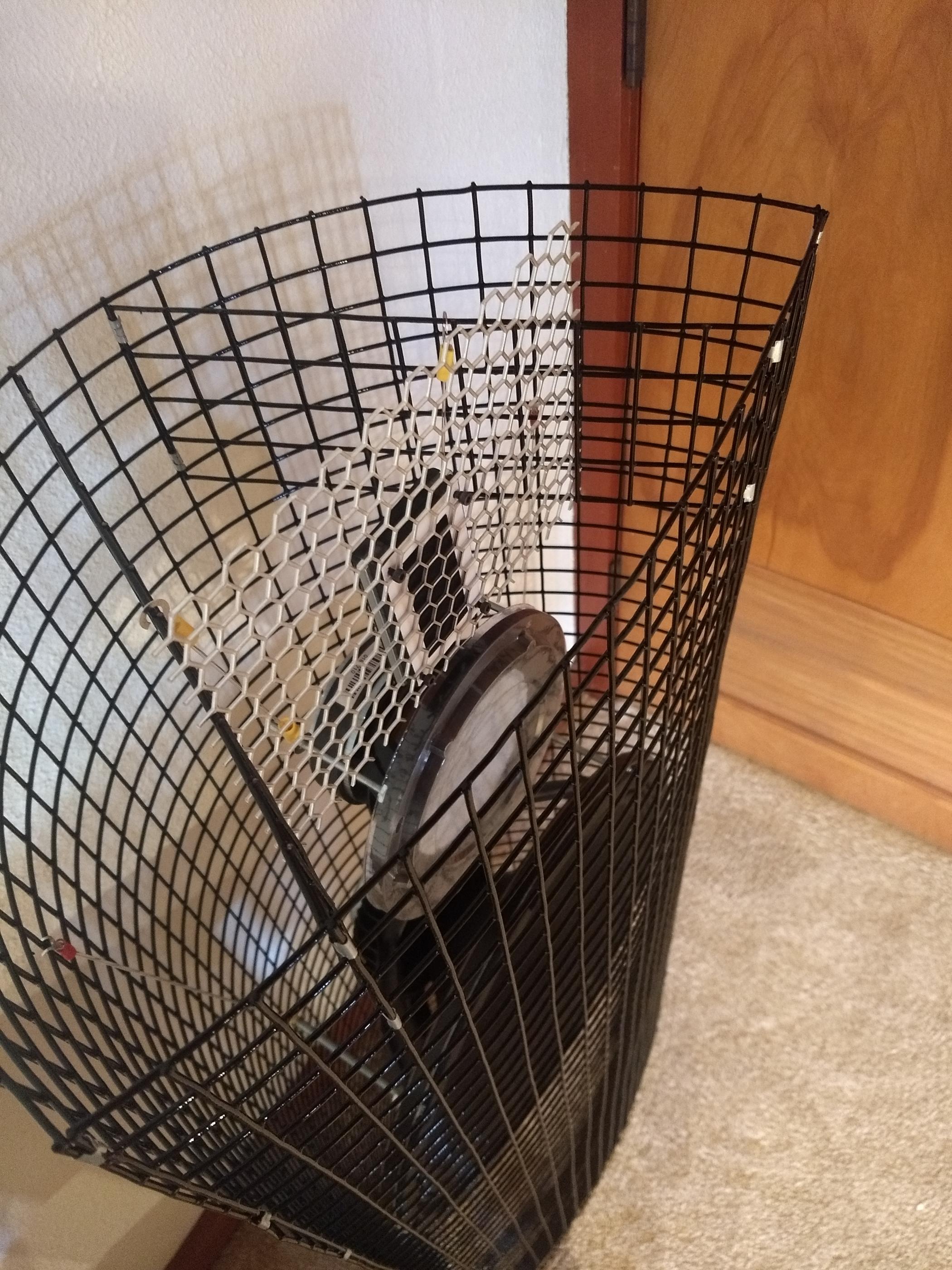

You could slice the barrel, say 1.5" above the F15, then mount that piece at a right angle (with the top now facing the back of the room) That would help with the bass leak around the otherwise non-existant baffle surface. Now the tweeter is ~10" from the F15 center. I've no idea what the hard baffle plane below and behind the tweeter would do, or if any effect from that could be solved using some kind of absorbent material.

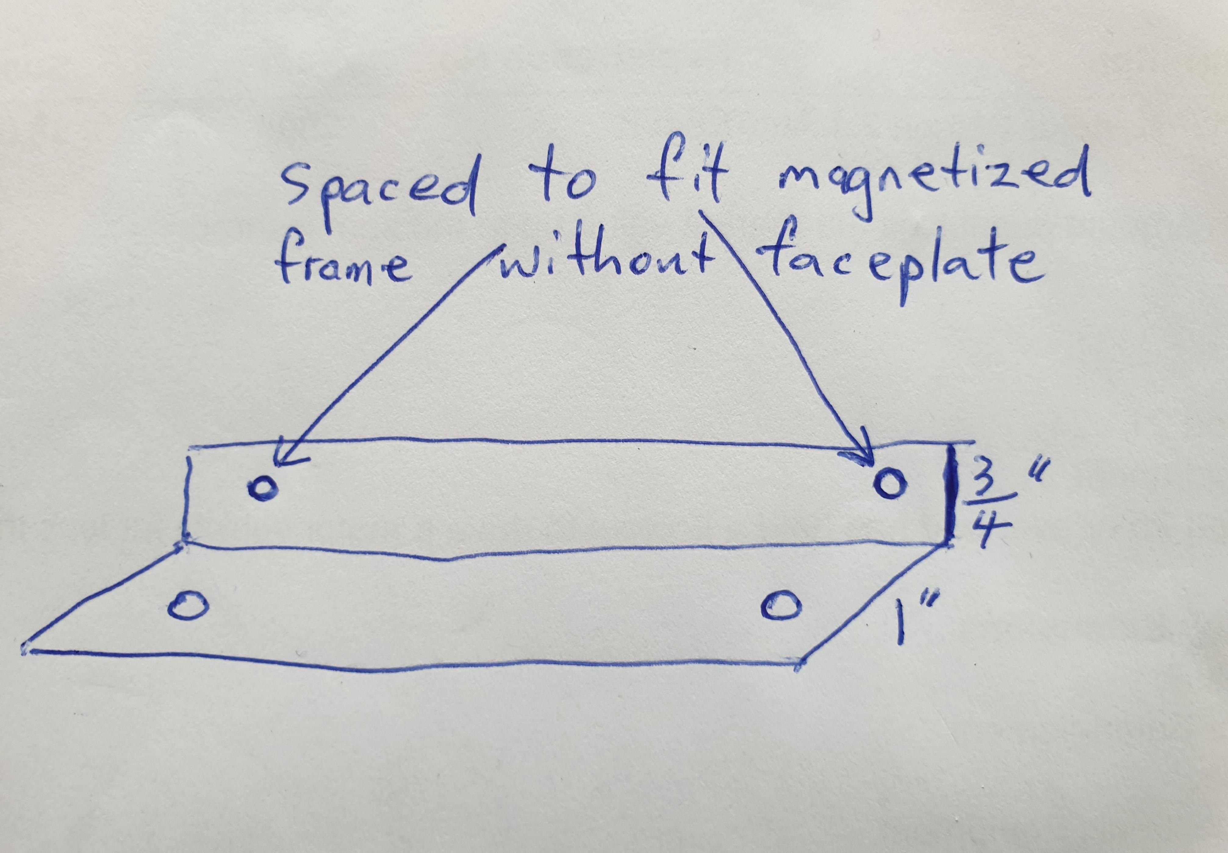

@CharlieLaub - I will try your suggestions. If it's not too much trouble, could you please provide closeup pics of your mounted tweeters, and a description of materials/methods used to mount the bare flange? That would be so helpful!
@jjasniew - I'm having trouble visualizing your suggestion. Any chance you could attach a drawing?
I don't mount the flange. I remove the flange and the rear felt of the tweeter in my application and just use the inner parts. Instead of "mounting" that I hang it using wires or fasten it against some perforated aluminum mesh with 0.5" openings. You have to use something non-magnetic to do that because there is a lot of stray flux from the magnets. See the attached pic - its a speaker that I am currently working on.
Anyway, you can certainly use the tweeter and flange as-is. I think you can just sit it on top of the existing baffle and use only the bottom two mounting holes to keep it in place. There is no need to add another baffle just for the tweeter.

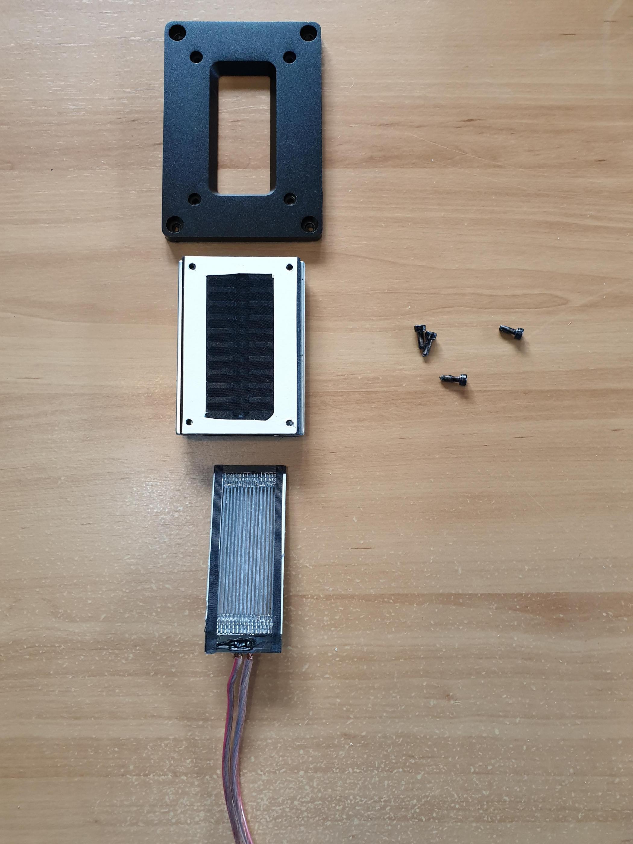

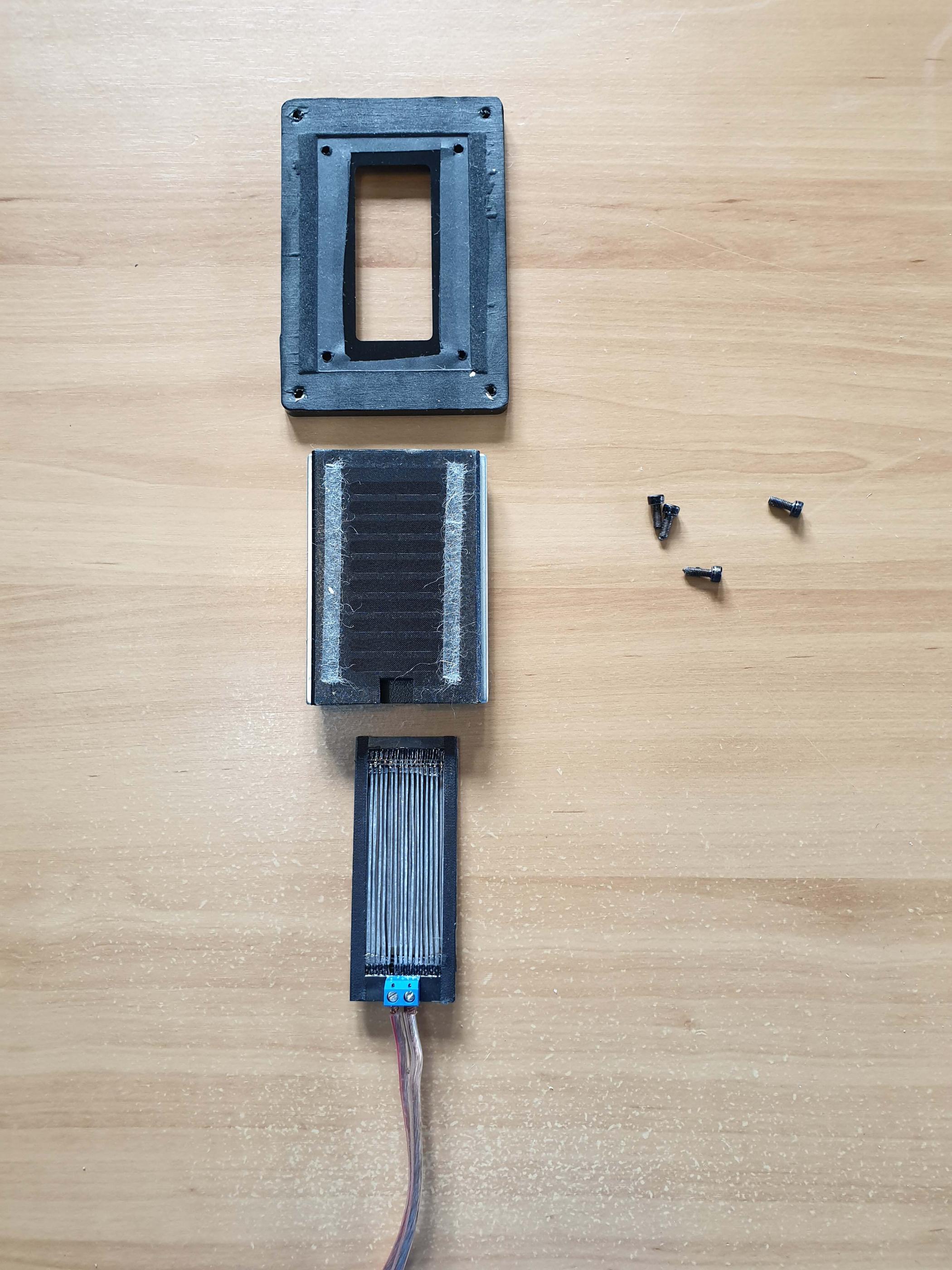

The following pics show the component parts of the tweeter after removing the faceplate and felt (front and rear views). The ribbon assembly slid out under its own weight when the faceplate was removed. Is this how it should be? I would have imagined that it would be gued or otherwise securely mounted in the magnetized frame - or is it like this for easy replacement? It appears to be designed to be installed with the cable posts at the bottom, which means the ribbon assembly will tend to slide down as far as the surrounding topology allows. What would you recommend here? And would it be ok to mount the tweeter (minus felt and faceplate) on a right-angled piece of light gauge sheetmetal as in the attached sketch?
The inner part with the wires connected to it is the part that actually moves air. It is meant to be replaceable but it is easy to hold in place inside the magnet assembly with some tape if it is loose on your units.
While you can use the tweeter that way, for your application it would be easier to just keep everything assembled and sit the magnet on top of the baffle with the mounting flange just sticking down in contact with the front of your baffle. Would that work/have you tried it, or did you just want to try the "without flange" mounting?
