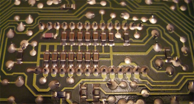

Thanks for the tip on the decoupling caps. More pads to solder but with a new PCB I can definitely make use of them especially since they are conveniently available from farnell.
You are quite welcome.
Some may think them "bloody expensive voodoo cap's", but try them on a suitable > 100MHz bandwidth analyser.
I guess you could use a bunch of 0402 cap's in parallel, have fun soldering.

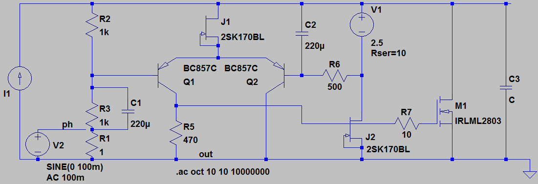

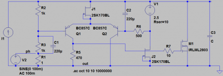

I've attached a draft schematic here of a discrete shunt reg I have not thoroughly optimized it in any way but the general topology gives a wide bandwidth and a very flat output impedance (Which I likely have to degrade in order to get good phase&gain margins).

Not really. If you lower the impedance of the 431 (for example by adding external transistors) you must lower the bandwidth, TANSTAAFL ...

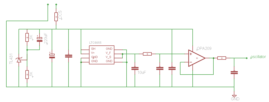

I'm aware of the LM329 buried zener reference but its 6.9V is somewhat unconvenient. Linear have a pretty new reference LTC6655 that is available in different voltages and has very low noise.
I'm thinking a TL431 set to 5V as a prereg followed by an LTC6655 and an OPA209. This could give a decently small low noise supply.
Why? Divide it down to 5V (or even 3.3V) and use the divider as first part of the filter. It is a long established part and very easy to find.
Noise is comparable to LM329 divided to the Voltage.
The shunt before all of this is not really that useful. Use an optimised LM317 as pre-reg, throw in some chokes.
I would probably stick to "old faithful" LM317, LM329 and NE5534 for the job, the results are bound to be within "experimental error" compared to the new stuff, they are easier DIY'ed as they are all TO-92, DIP etc.
