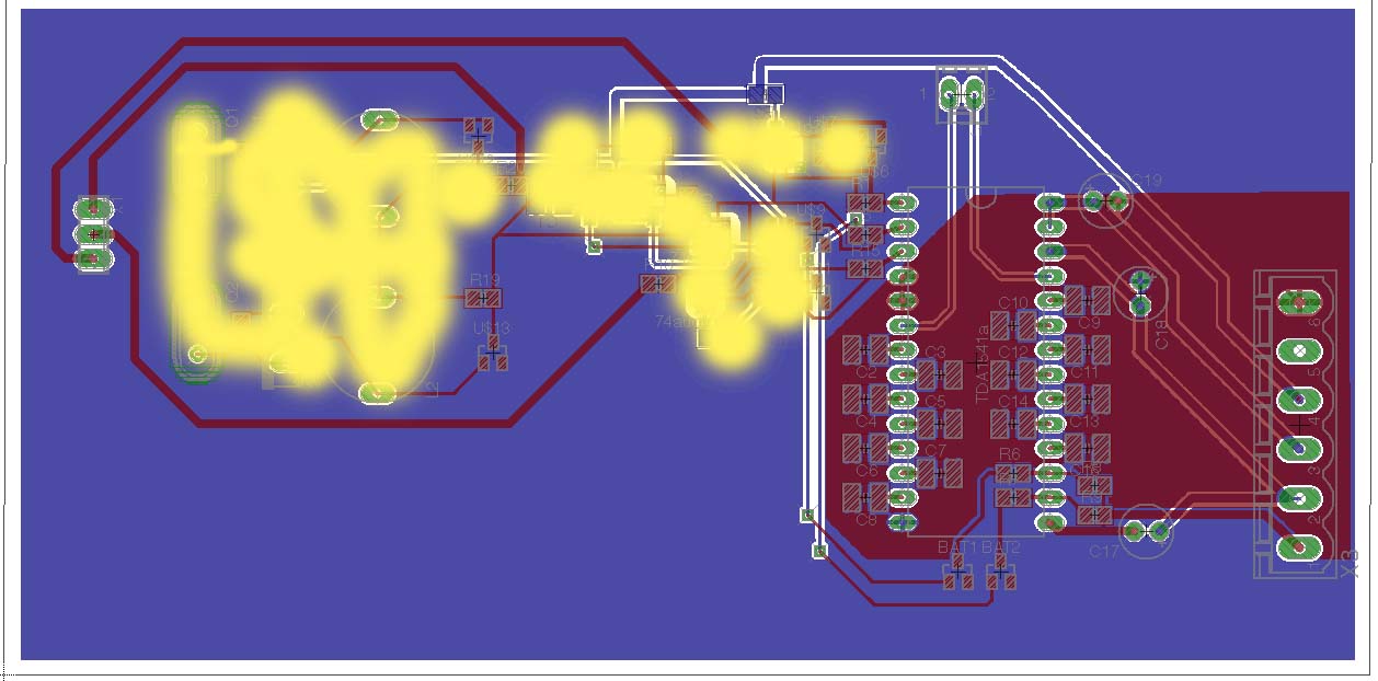

Let me give it a shot... as you see I have yellowed-out parts of the circuit, these are the clock and reclocker (on the top layer). Reason is that this is John Brown's design, and he has shared the schematics but his dac design he uses commercially so I didnt want to reveal exactly how I have placed everything (John, if you read this and find it still inappropriate, please let me know and I remove it).
Soooo... what have I done:
Top layer (in RED):
-clock
-i2s attenuator
-i2s reclocker
-dem reclocker
-tda chip + decoupling
-analog ground plane
Bottom layer (in BLUE)
-digital ground plane
-decoupling of the reclocker flipflops
Yes, it's a bit of spaghetti, I am not a professional layouter and it shows.
But... I have never really understood that it needs to look pretty to sound good. To me, it makes more sense to have short clock lines and components placed where they logically should be placed, than to line up resistors neatly and have longer clock lines....

I would suggest placing the DEM Decoupling Cap's vertical and keep them all inside the TDA1541 pins...

Pourquoi? The 1210's don't fit next to one another, so i thought this would be a good solution. What does putting them all inside the tda footprint give?
They fit if you stand them on side, which also reduces inductance.
Fitting them inside reduces inductance...

I would STRONGLY suggest you design in a reclocker for BCK, WCK and Data and John Browns DEM Reclocking. With the I2S attenuators and the reclocker very close to the TDA1541 we do not need worry about striplines here, but reserve the stripline for the clock to the reclocker and for the signals to the reclocker...
Would you still see an advantage by reclocking close to the dac in such case the needed clocks (bclk, wckl and dem) are generated from a synchronous divider and fed back to the i2s datasource? I think such a solution can be kept very clean it would even be possible to not divide bclk at all.
But why would it matter if data wclk and bclk are a bit off as long as not horrendously so? Since ideally no digital input to the dac should change state for half a bclk clockcycle before the dac latches (in time multiplexed mode Is this not enough time for anything injected by capacitive coupling from the inputs switching to the dac substrate to die out?
better decoupling due to the lower inductance of all respective current loops. Thorstens' advise is correct.
best
Probably yes. The reclocker also acts as driver for I2S attenuators. Keeping all this very local and highly optimised for short loops is likely "a good thing".
Ciao T

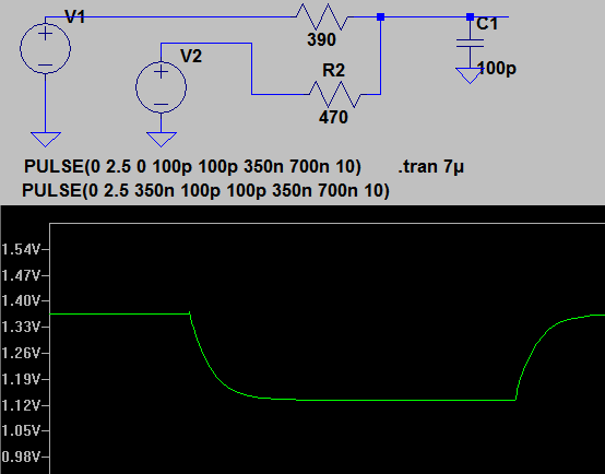

Regarding those i2s level/slew rate limiters. I looked at the solution posted by ecdesign but I did not quite like it.
I have posted this solution for consideration it allows the high and low level to be set quite freely as well as giving a more predictable output impedance (usefull for improving source termination of transmission lines altough this should not be strictly necessary for short traces and slow rise times) and the slew rate limit can be easily set by C.
Opinions?
Opinions?
They do have a distinct advantage insofar that they actually work.
Opinions?
Based on my work on the same subject and the resulting experiences, it does not seem a good idea, but by all means try it...
Ciao T
By slew rate are we refering I presume to rise time?
My concern with Tazzz option is that most PCB traces are in the region of 70-50 ohm charecteristic impedance (with a ground plane), those resistore are way above what the line impedance is and are going to cause more of a mismatch.
Again a terminology question the I2S attenuaters are level shifters yes?
It is the same thing.
I would not fit the I2S attenuators after long trace, not just because of reflections, they will cause additional current flow in the loop back to the source...
Yes, but I intended the values as shown to be merely illustrative and the circuit to spur discussion. The capacitor would muck things up as well. Placing it close to the driver would mess with source termination and placing it close to the dac would increase the loop currents. (flowing in the groundplane)
I do not doubt ECDesigns solution works but as shown but it only limits voltage swing by the clamping voltages of the diodes and if we go by Htp:s comment voltage swing could be limited even more.
I'm also pretty sure we don't have to worry much about transmission line effects here anyway. ( I specifically mean between the i2s attenuator and the TDA or in the generalized sense any case where the wavelength is long compared to trace length and the slewrate is slow) Between the masterclock and its consumer is another matter. I only mentioned it because I've made a habit of making sure any digital trace which changes state a lot is properly terminated.

Essentially, yes. Any large circulating currents (which may be more than just the supply decoupling) and currents always "circulate", should be contained in the shortest possible loop and not use the ground plane any more than unavoidable.
In my view, ideally the ground plane only carries signal return currents and minimal error currents that cannot be completely eliminated and DC.
Also an extremely quiet ground plane can only be beneficial on the analog side as well.
Digital too. Check Meitners AES Paper on Logic Induced Modulation (LIM)...
The Pin Layout for modern SMD IC's often makes this job a lot easier...
If we combine this with a 4-Layer approach with groundplane (same plane as IC), signal routing plane and power planes) it is possible to make very complex and very quiet designs...
Ciao T
- Digital Source
- decoupling TDA1541A
