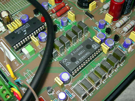

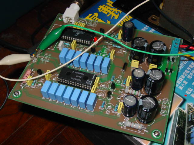

Hi all,
I have tried Philips MKP (130nF) and Siemens stacked film (470nF) for those decoupling caps. Both sound smooth and natural. Personally prefer Siemens stacked film more (may be the value?)
Will try BlackGate N, Nx soon.
Below pics showing the board using Philips MKP. 🙂
pics for Siemens stacked film will follow.

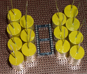

I have tin foil 0,15µ, but they are 15mm diameter 🙁
IMHO it is very important that the rolled film caps have contact material all over the flat end faces and the wires bonded to them.
So rolled MKP caps will be low inductive like the stacked Siemens MKTs.
But better because they are MKP.
If the wires are just sticked into like old or cheap styroflex, they will be inductive and also the electrical contact will be not so good.
15mm tin foil caps:
15mm tin foil caps:
Bricolo said:Isn't it better to place the caps this way, rather than to align them?
The path seems shorter with this configuration
No.
Foil caps are mostly long.
And this way the path is prolonged by the lenght of the cap.
Only useful if you want to use very fat 1µ Siemens MKT stacked foil caps.
They are short.
