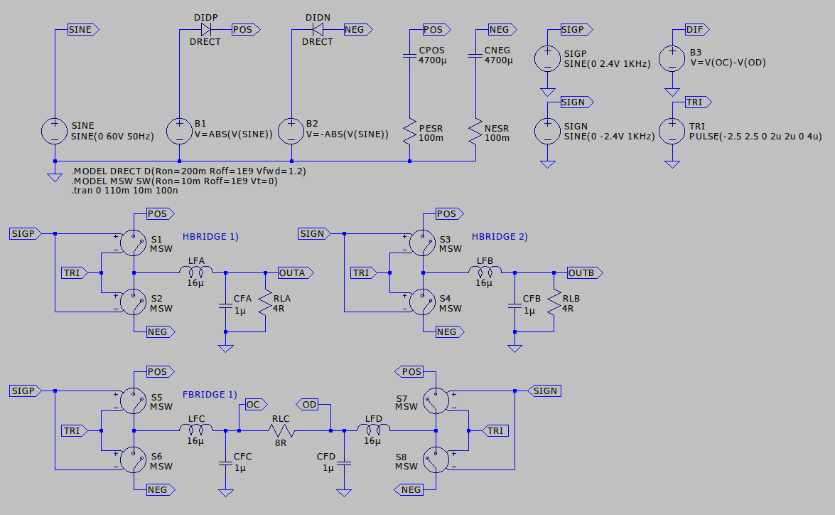

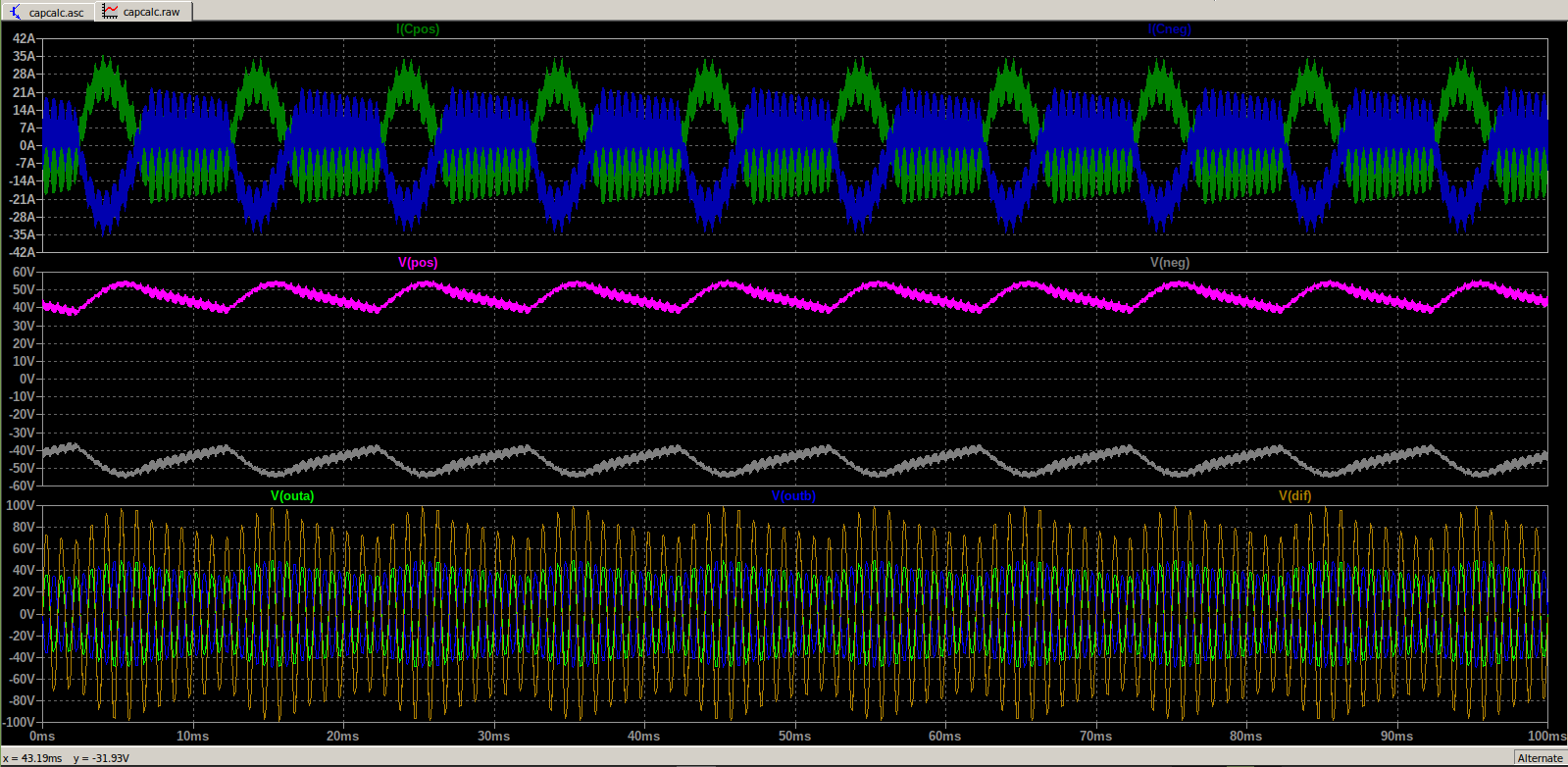

If in doubt throw LTSpice at it. For the moment ignoring the fact that these amplifiers are being supplied by an SMPS start off assuming lump of iron and bridge rectified supplies. Mess about with the attached model and measure ripple current in the capacitors to get the feel of things. Copy and paste the Class D sections to suit your configuration mix. Adjust signal levels for output conditions. Later you can add some approximation of the SMPS but that will very much depend on the nature of the beast.
