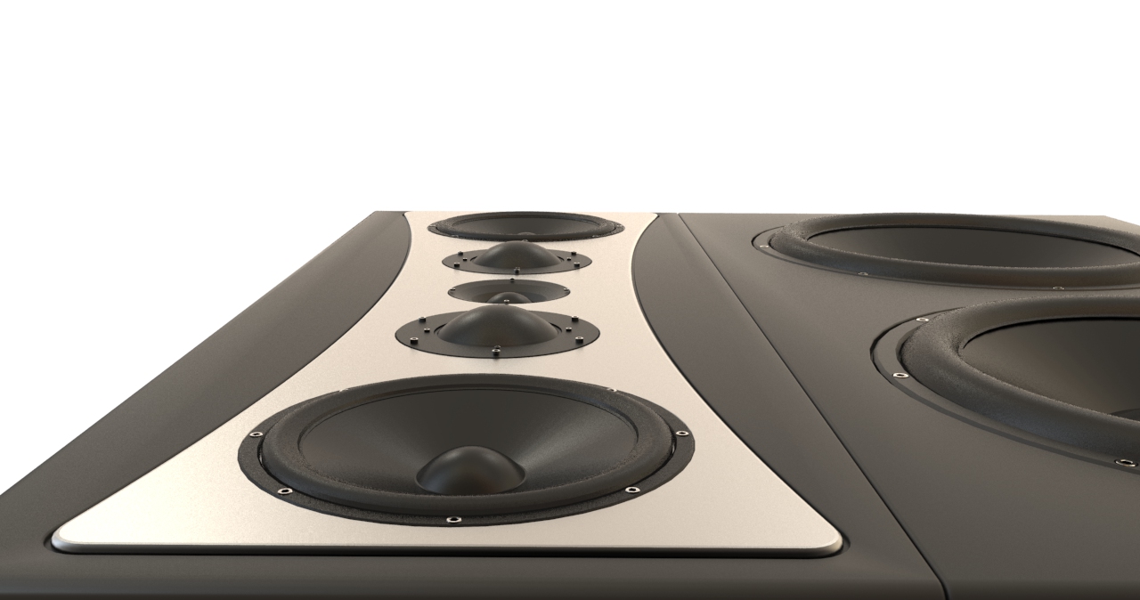

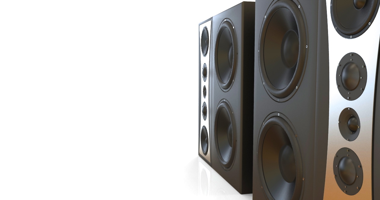

Decode this large format studio monitor...
From that photo with scale...
Dayton RSS390/Seas CA22/RS52AN (blech!)/SS D3004-6600
He really does NOT need the mid-dome with those other drivers.
If you want to play loud you certainly do, or be prepared to exchange tweeters all the time. Apart from that, how do you get directivity right with only the 8"'s and the tweeter? That is, if directivity was of concern when Mischa designed this.
So many of these big speakers claim average SPL of over 120 dB. Just can't find a dome midrange or tweeter that can take the hit. The Volt 3" dome midrange can hit average SPL of 110 or 113 dB, depending on how you calculate... even two of them can't hit the 126 dB claimed by this Dynaudio...
