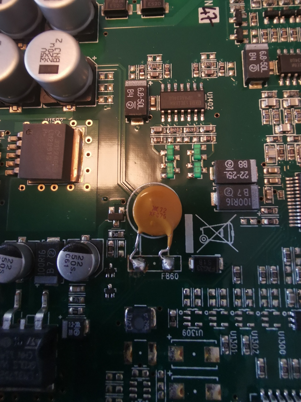

There is a resetable fuse in the middle of the main PCB (see attachment). I found the datasheet of this part here:
https://m.littelfuse.com/~/media/el...ble_ptcs/littelfuse_ptc_72r_datasheet.pdf.pdf

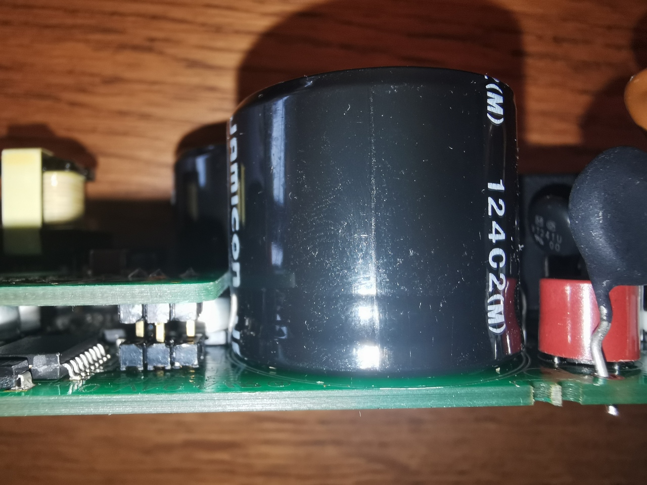

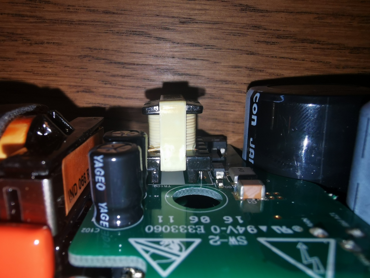

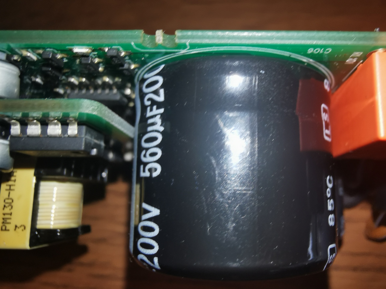

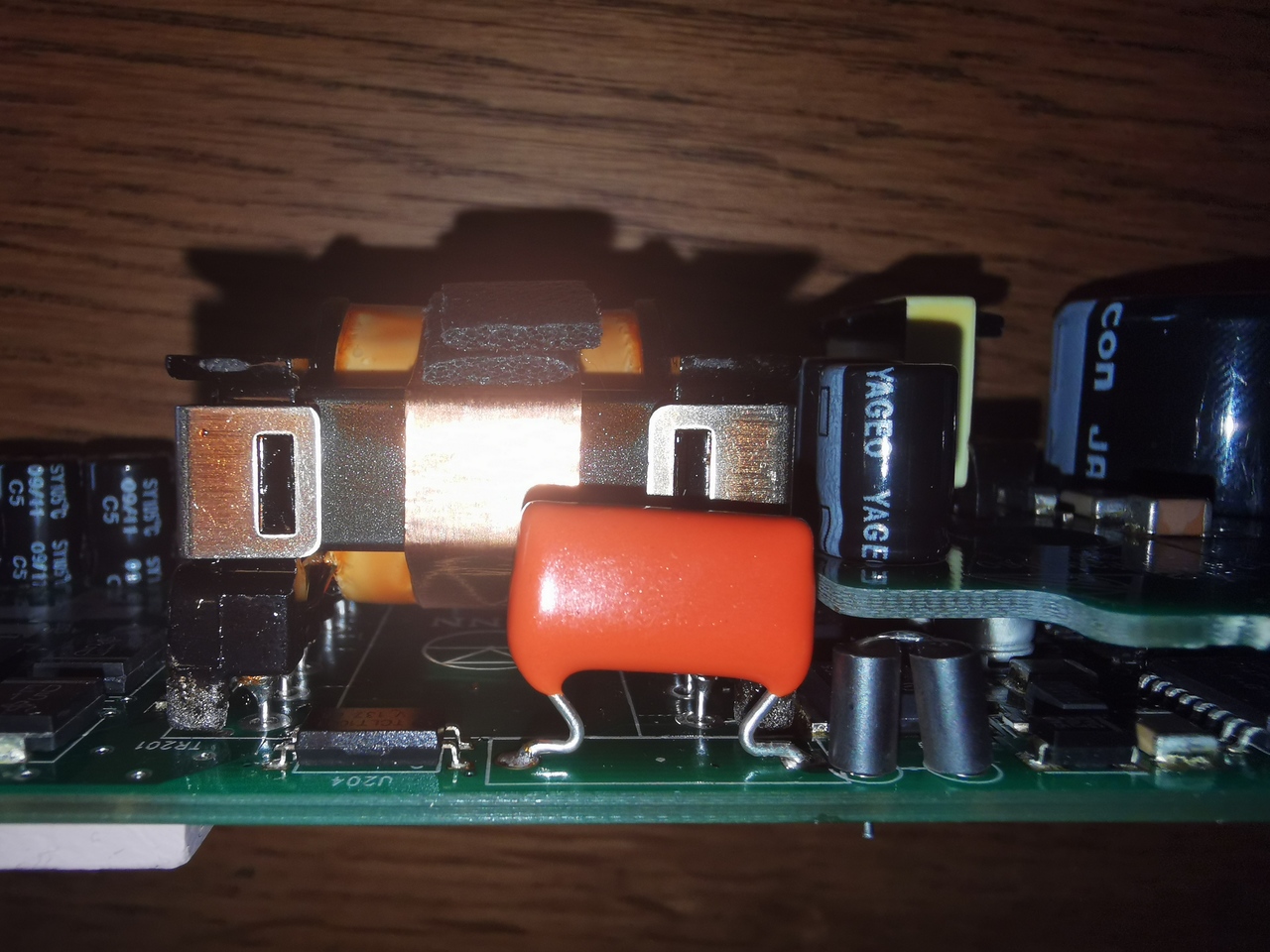

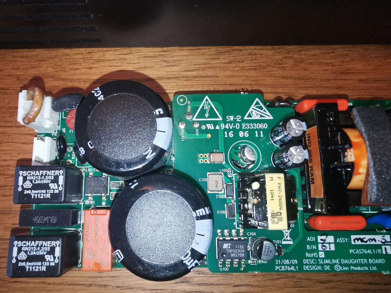

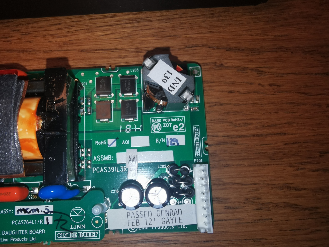

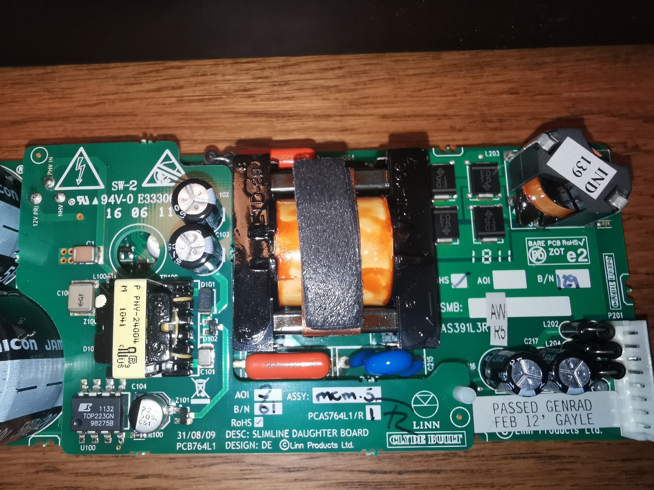

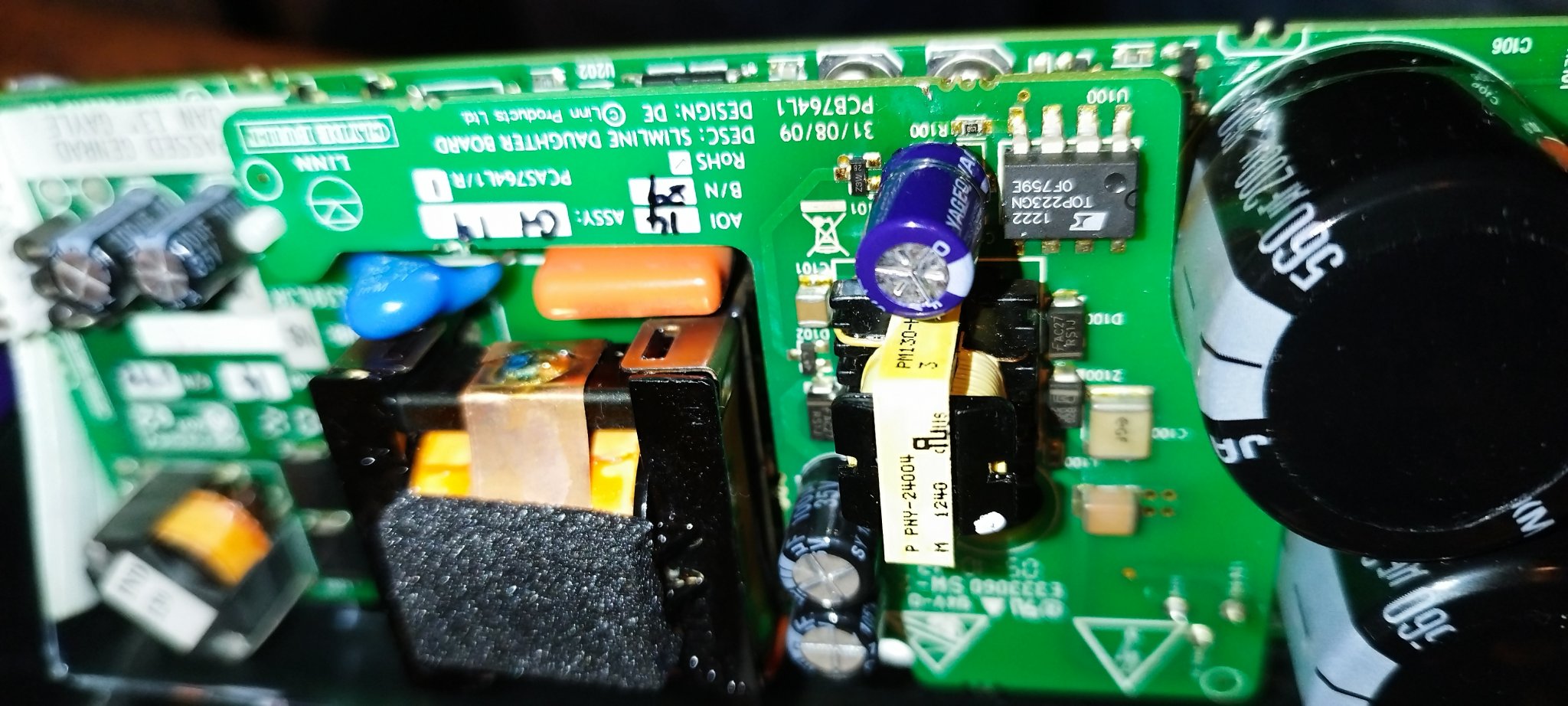

Here are some picture I just took of the power supply board.

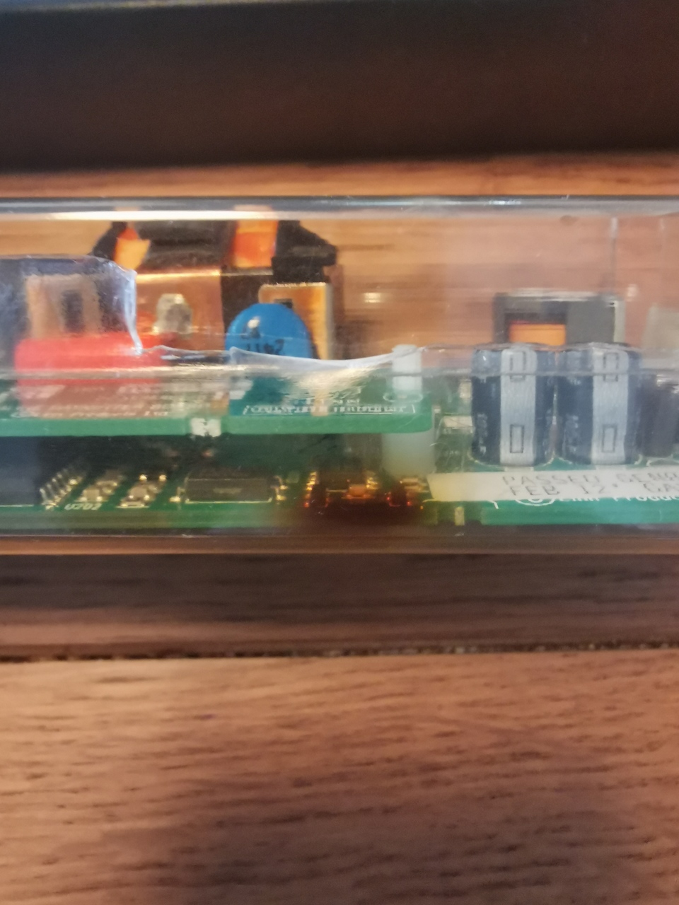

On one picture (burn.jpg), I see that something went "hot" (burnt plastic?), but when looking at the PCB itself I can't see anything obvious (no visual sign of something having taken fire, and there was no magic smoke when the device stopped working.)
I also added pictures of top and sides of the PS boards. Maybe you can see something obvious (but I don't.)
I still haven't found how to separate the main power supply PCB from the daughter one (side_4.jpg picture). I tried to pull it but with no success. Should I de-solder the pins ?

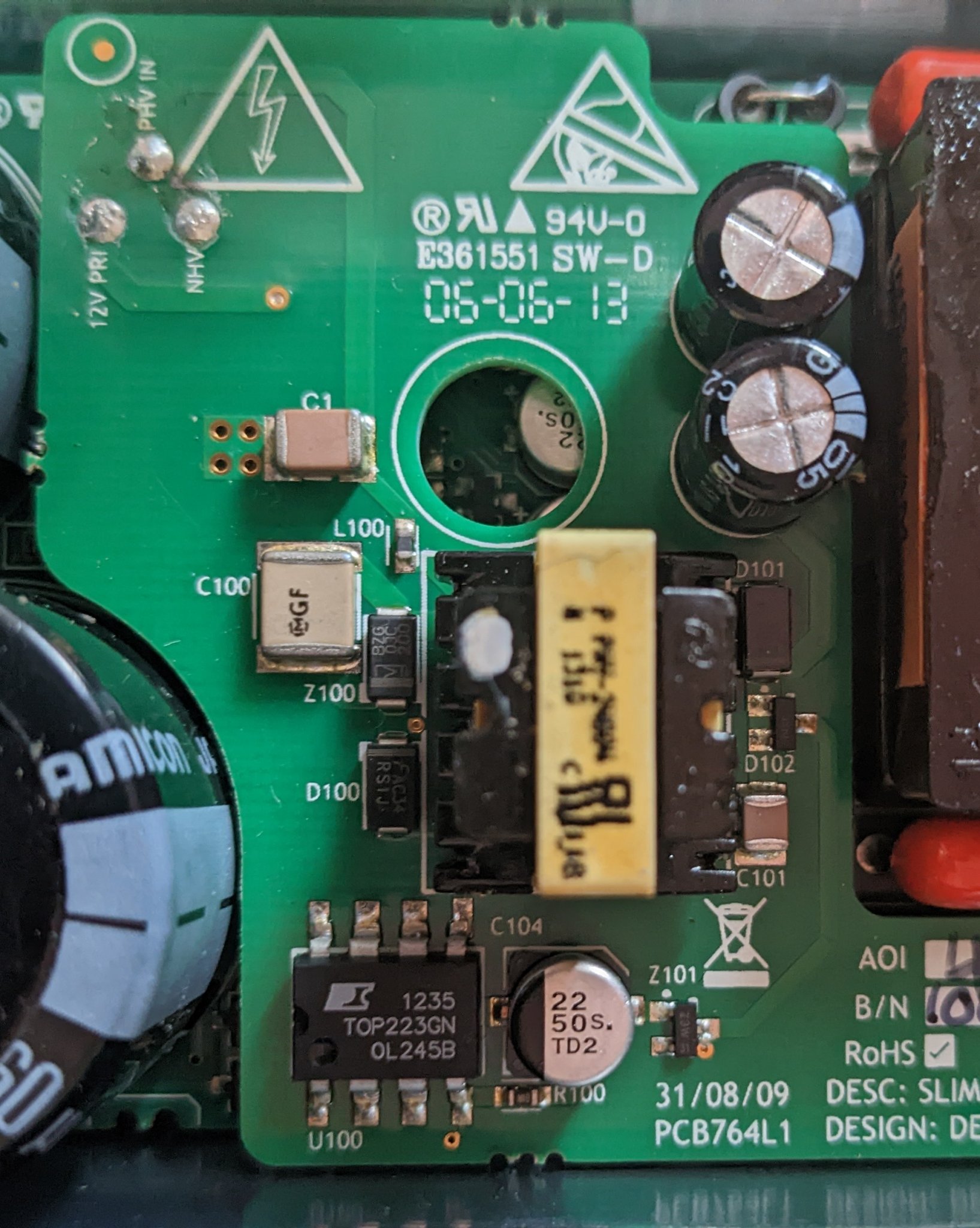

The little piggyback boards seems to be a 24V supply that is stacked on top of a multi output supply because of board space restrictions. The IC next to it is a switcher IC that is pretty straightforward and quite easy to understand.
I googled the part number of the yellow transformer and came up with this datasheet for it. http://www.premiermag.com/pdf/pny-24004.pdf from that i deduced that its likely a +24 or -24V 400mA power supply.
The burnt part of your enclosure seems to line up well with the two SMD electrolytic capacitors under the piggyback. Those somehow look odd to me, if you have a decent multimeter with capacitance measurement mode you may want to solder two pieces of wire to both the terminals and measure them for resistance and capacitance. If you have one of the cheap Chinese component testers/ESR meters at hand you can use that to test them. Good capacitors should increase in resistance value once the multimeter starts charging it.
If that doesnt solve the fault. google every IC you can find on the board, and check the power supply rail impedance. (Ohm meter over the VCC and GND pin) If the IC somehow has a FB or REF pin measure that to the GND pin. If you measure a short or a few houndred ohms report back.
That click you where hearing was likely coming from the Relay on the bottom left corner TOP1.JPG. Its the orange relay. That is likely switched on by a voltage coming from the big transformer, so if the big transformer is not getting any switching signal from the controller there wont be any click from the relay bridging the on board resistor. So i think we need to look at the controller.
My Thinking is the following: a switchmode/flyback transformer normally has a winding of 10-12VDC output to run the control chip. However there is a chicken and egg story here, as long as the chip has no power it will not drive the mosfet to produce the power it needs to run. Most designs solve this with a big resistor from the rectified mains plus to the supply pin of the controller. This will charge a capacitor over said supply which in turn gives the controller enough energy to do a burst of PWM into the Fet, getting the loop started.
Now what if one of the three SMD electrolytics is the cap over the supply pin of the flyback controller IC? If that cap goes open or shorts the controller IC won't start.
Edit i just checked the photos again and next to the TOP223 is a 22uF capacitor, I will take any bet that says that that is the capacitor over the supply pin of the TOP223

There is a Wickman T1.6A fuse on the board (3rd picture, top left of board). Has that failed open circuit?
Not in Linn devices but I have seen TOP223 being the part that failed. My habit is to replace all electrolytic caps for known good 105 degrees rated industrial ones and the TOP IC. Also check all diodes.
The TopSwitch 223 on the daughter board is only for a 12V "helper" supply, probably for remote and LAN. A max. power of 9.6W cannot be for the speakers. Should be easy to see if it still works, there is even a legend at the 3 pins that go down to the main board, PHV/NHV (rectified mains) and 12VPRI. The latter should read 12V against NHV.
The main power stage is on the lower board with the bigger caps and transformer. Cannot comment much as it is mostly hidden, but it could be a half bridge since a flyback needs no bridge rectifier and filter coil (L203, top right pic), not even for bipolar output.

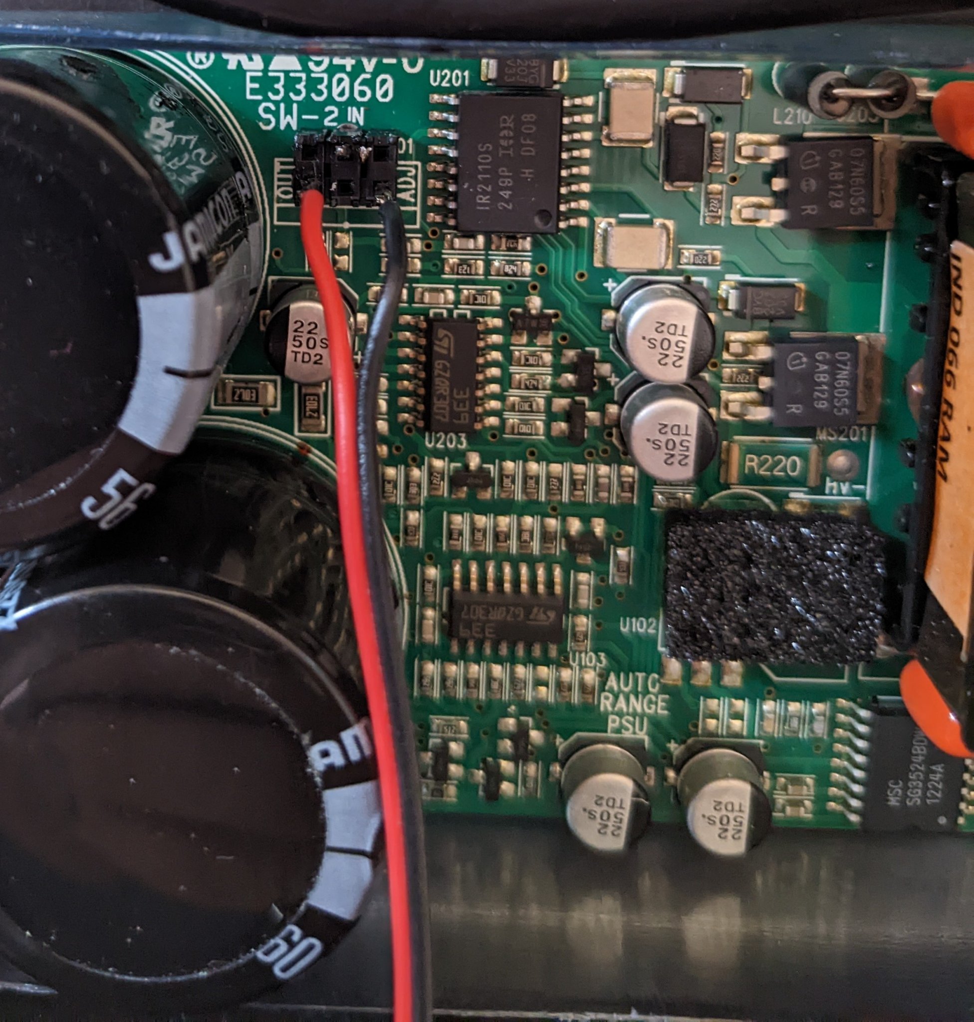

Hi all,
Bit of a hijack of the thread since I have a Sneaky DS with the same symptoms. No longer turning on, no relay click noise when plugging in.
No obvious visually sad components/magic smoke release visible on the boards.
Thanks v4lve lover, jean-paul and Holmer for great hints in this thread.
It seems like the 12V helper supply is dead in my case.
PHV IN - NHV reads 320V DC on my multimeter.
12V PRI - NHV just 0.56V DC, so something is wrong here.

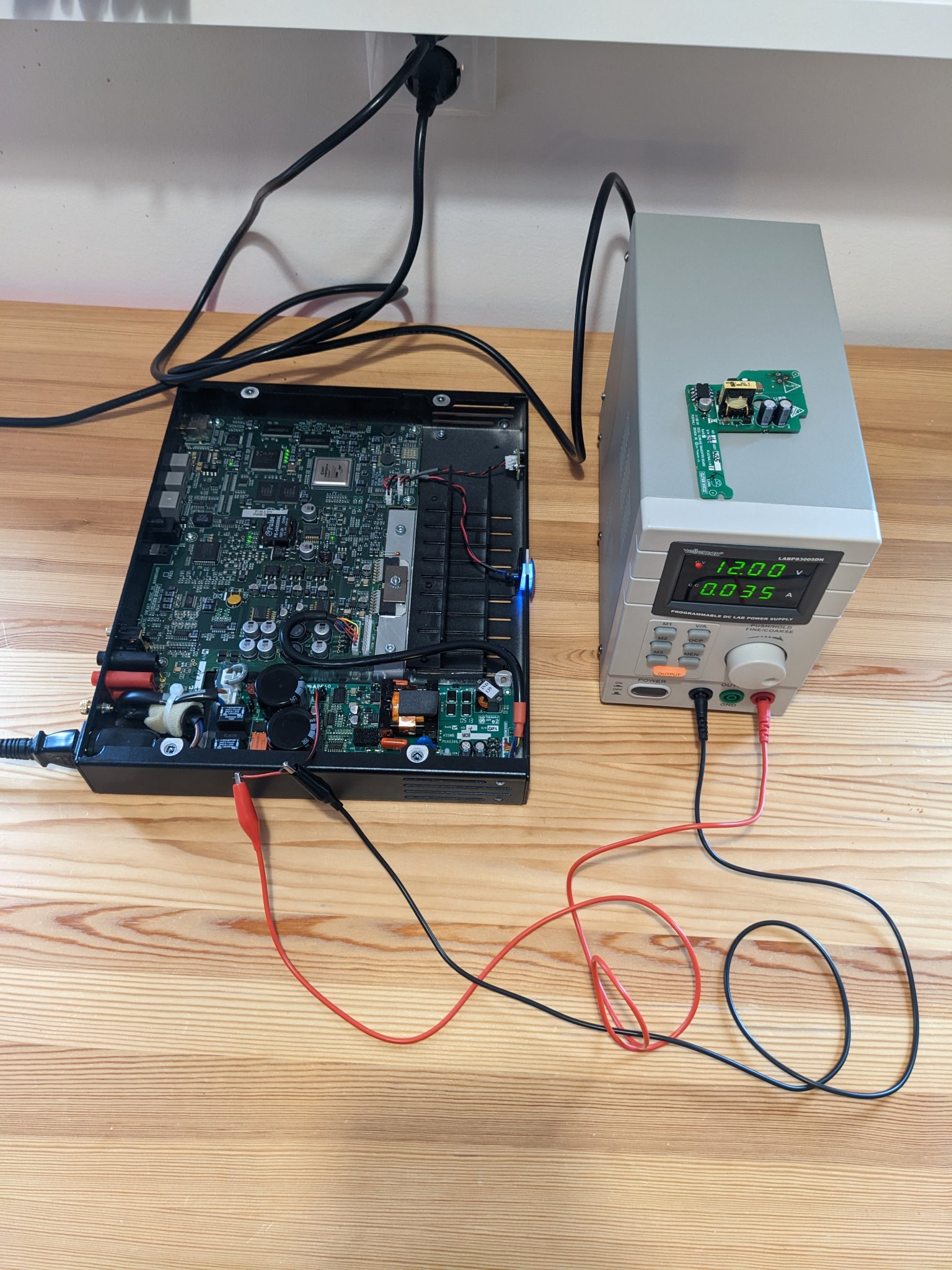

I tried injecting 12V DC between 12V PRI and NHV from a bench supply, it felt dirty but hey, it was already dead. And then it boots and plays music again. Pulling just 40mA from the bench supply. Promising!

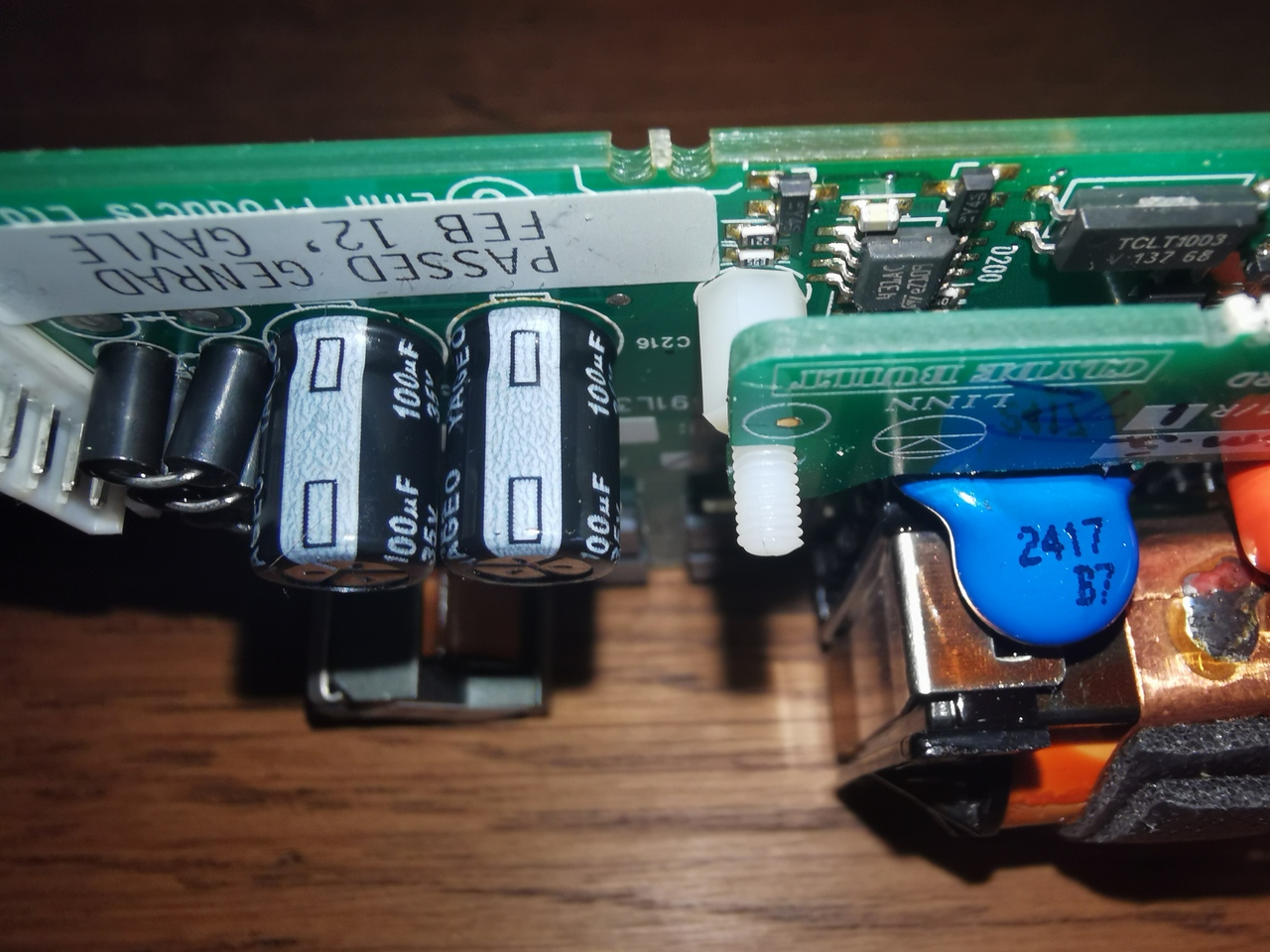

So i tried ordering a new TOP223 and replaced that and the two 100uF electrolytic caps. Sadly no improvement, still 0.56V at 12V PRI.
I feel that I'm in a bit over my head and unsure what to try next.
Mailed Linn support with details and pictures and asked nicely to get forwarded to one of the tech people for schematics or component details on the daughter board. But sadly customer support is a "Talk to your nearest Linn reseller"-wall.
Contacted my nearest reseller and they are like, "Yea sure. We can take it and mail it to Linn and they will fix it", for 300€ ... T_T
Any thing else you would recommend i try?
