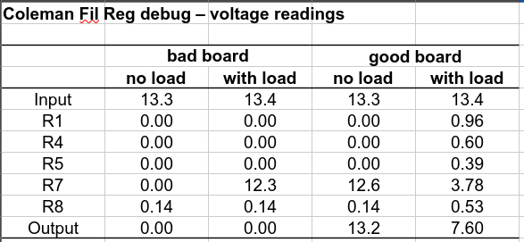

Here you go! Measurements taken from both the bad and the good board. Without load/tube and with load/tube. Values in V.
The difference between the input and the output is high - near 6V .
This is more than the guide maximum, though even that level can be managed with a large heatsink and checking of the temperature according to the PDF manual.
But it is good to drop some more voltage in the CRC of the Raw DC to get the input into the specified range 10.1V - 11.2V max. {Loaded)

Yes, the raw-DC input is high in my measurements. It was closer to the recommended 11 V when both boards/tubes were up and running. Also, I may have set the variac a wee bit high during the test, which would add to the high raw DC. The power transistors are mounted to the base plate of the chassis, and things never got very toasty.

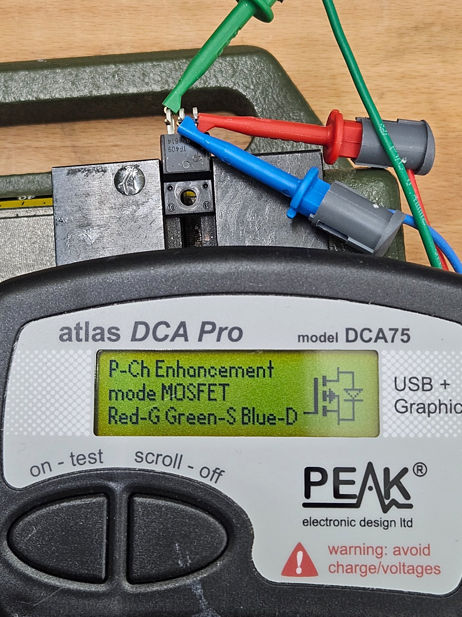

I removed the TF409 from the board and it tests fine in the transistor tester (see attached photo). Can you provide the circuit schematic so I am not fishing in the dark? I am hoping to not have to reverse engineer the PCB traces...

Unless the tester operates at Ampere level, it may still be suspect.
The only other possibilities are solder joints: input and output connectors, or R1, or R9. The Q5 drive voltage (R7) was present and correct in your measurements, so no other components are involved.
