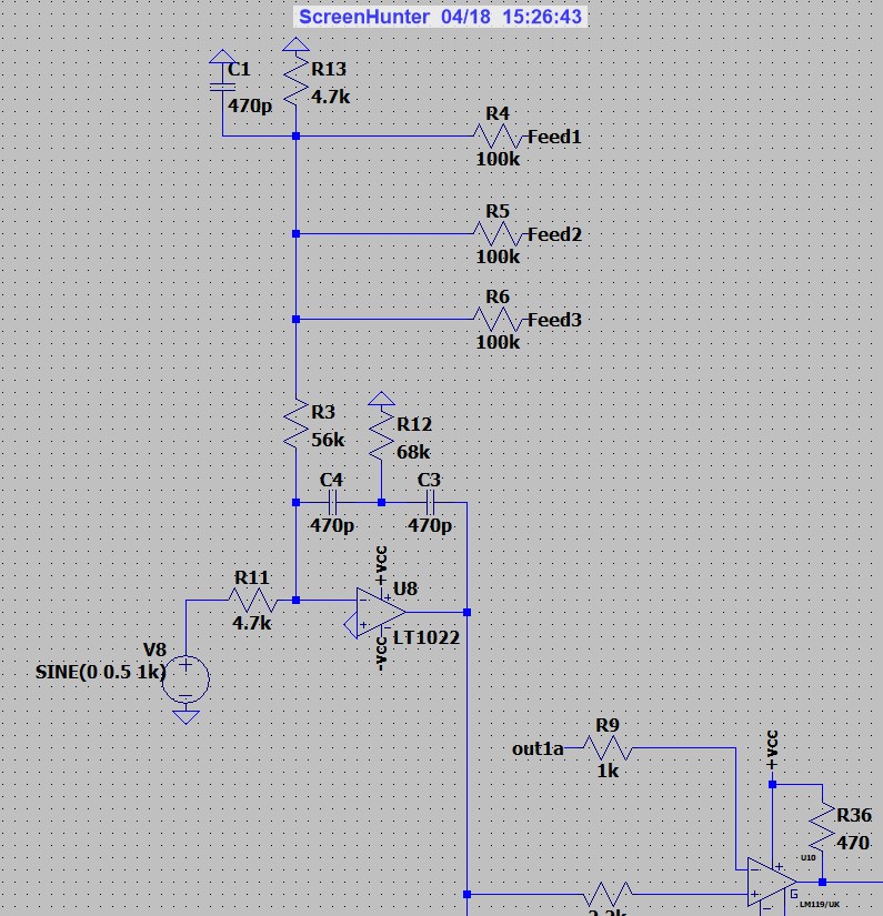

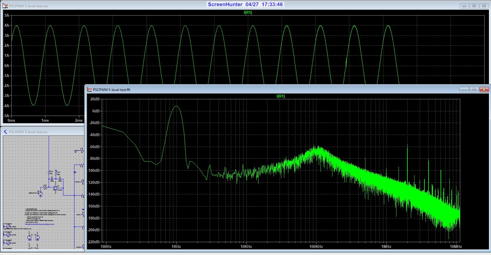

Hi Newvirus.
I have play some with your attachment from Karsten, I had a mail contakt in past with this author because of feedback
circuit he did had on paper.
I see three coils are needed, and I need a feedback from three outputs, I did use a adder for this with resistors three times bigger
to low pass.
I did try the K facktor in LTspice, idea was one ferrite core with three parallel windings on it so I have to use just one coil, it did
simulate fine, If I have sim oke but real live not, I need for 5 level 4 coils, because I do use high frequenties these coils are small.
As you say, yes this circuit is much more stable, and more easy to control. But it needs 4 low pas coils for 5 level, and flying cap just one,
seen the low cost of the coils and maybe to use two separate windinds (or three) on one core will proberly work. Feedback is more
challenging because of the three or more outputs, I use resistor adder who works fine..
see pics.

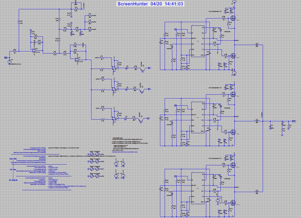

That's a 3-phase common-mode coil, you need three separate ones ..I did try the K facktor in LTspice, idea was one ferrite core with three parallel windings on it...
Sure, but did you check how many MOSFETs, gate drivers and capacitors the 5-level flycap inverter needs ?But it needs 4 low pas coils for 5 level, and flying cap just one ..
Of course, not all class-D is PFFB.It was class D with a second order integrator no postfeedback.
Oke, all with all, the version with three bridges and coils I go try. I need indeed less electronic parts.
Because I am quite high in switching frequency I need not such big coils.

You need separate chokes on separate cores, if I understand correctly. CM choke only gives a small leakage inductance between its windings (that are usually tightly coupled) and this small value is often not enough to suppress circulating currents between legs. These currents would worsen the efficiency and EMI performance of the amplifier.
The rest of what you've written (unity-gain point, Nyquist distance etc. ) I do not understand.
In EE, we generally take what we can have as we cannot always get all what we need.I need indeed less electronic parts.

Unfortunately, what you mean is 5 phases / 5 legs switching and not 5-level switching .. It may be better to get off pseudo technical jargon or you'll remain on the simulator even after months have passed, not being able to graduate to anything real.when a 5 level do switch, the frequency is multiplied, so with 250 khz mosfet switching I get 1.25 Mhz.
Here I have test the 5 level.
the phase shift do let multiply the frequentie on output, and suppress the triangle frequenties.
I have now other challences to do, and not much time to set up all.

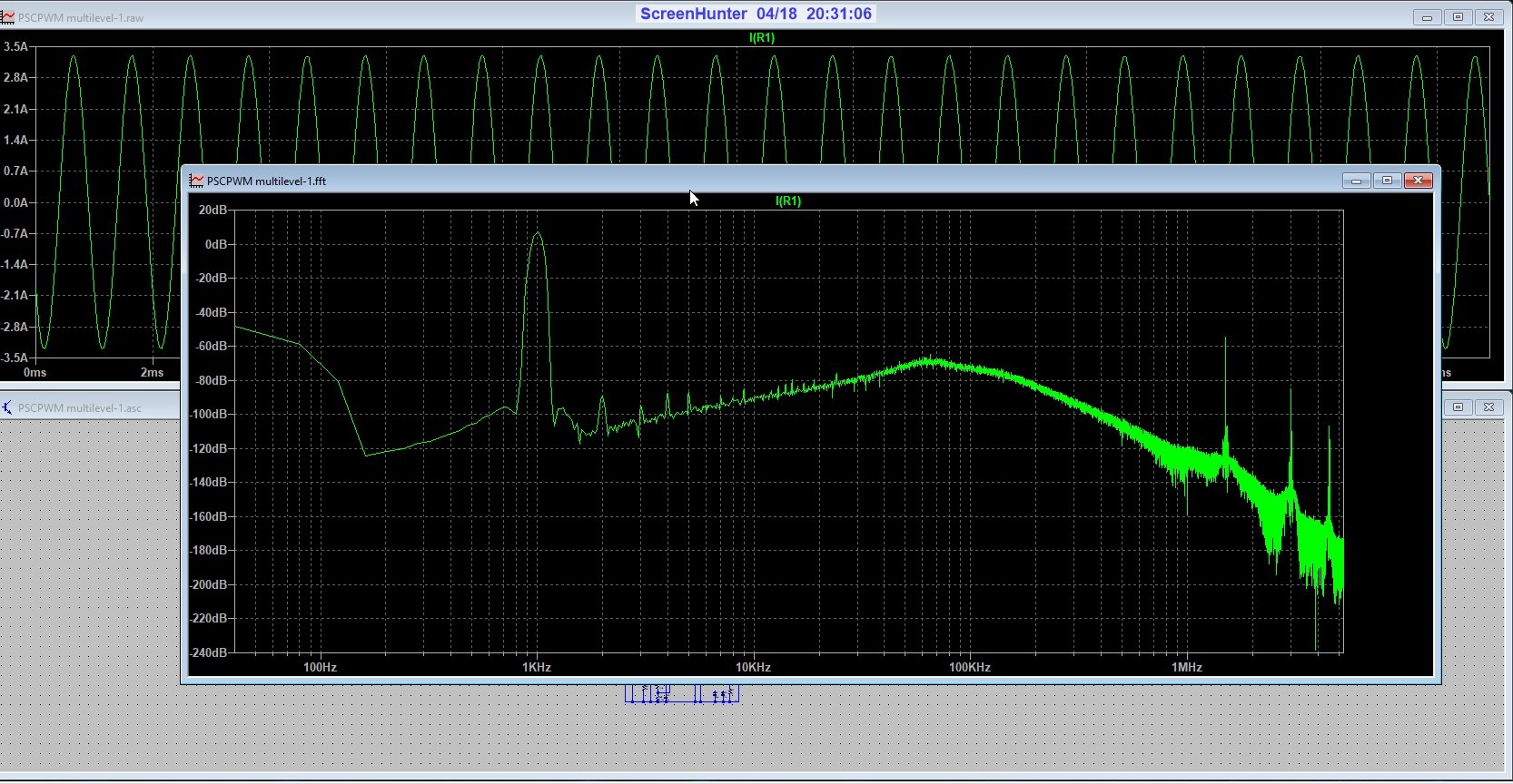

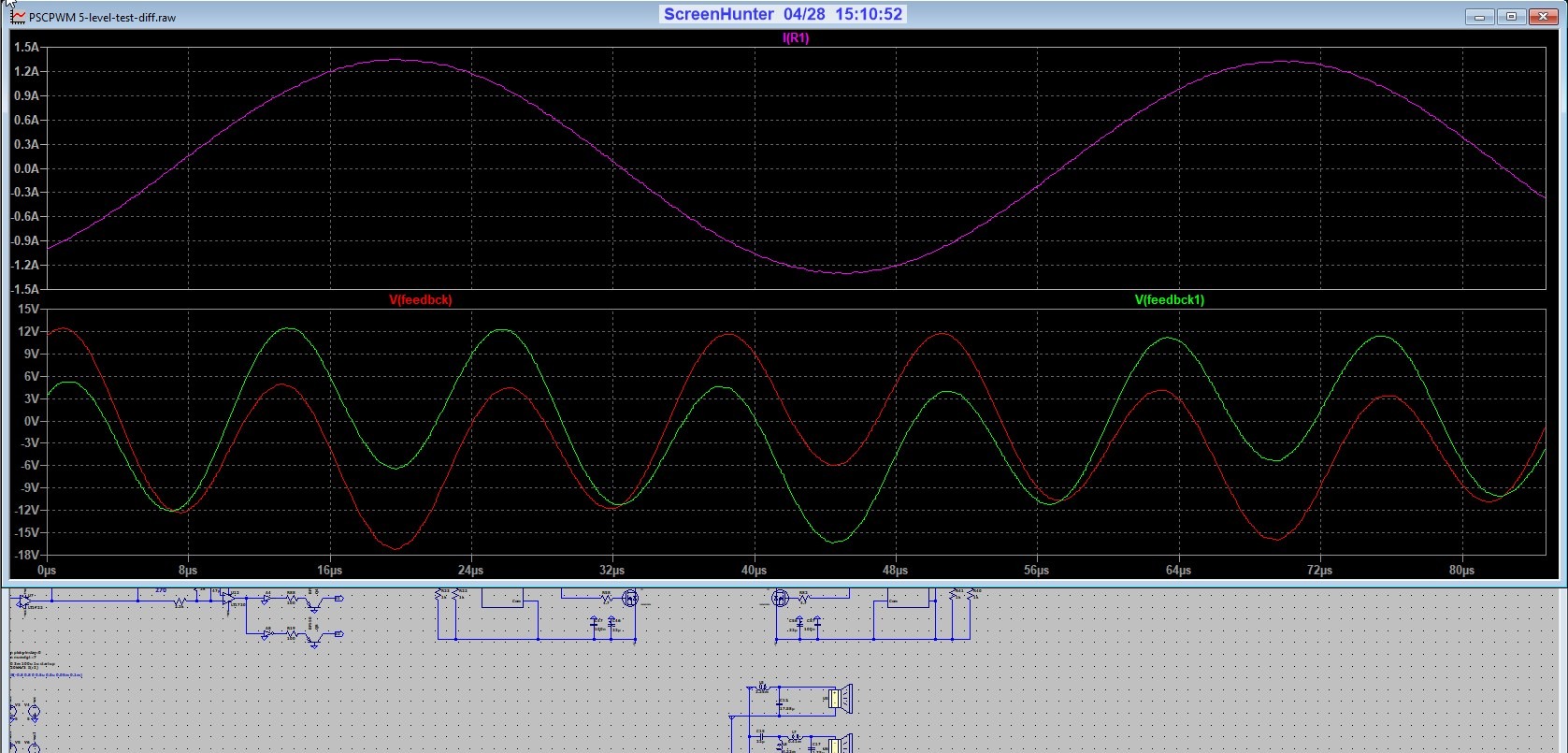

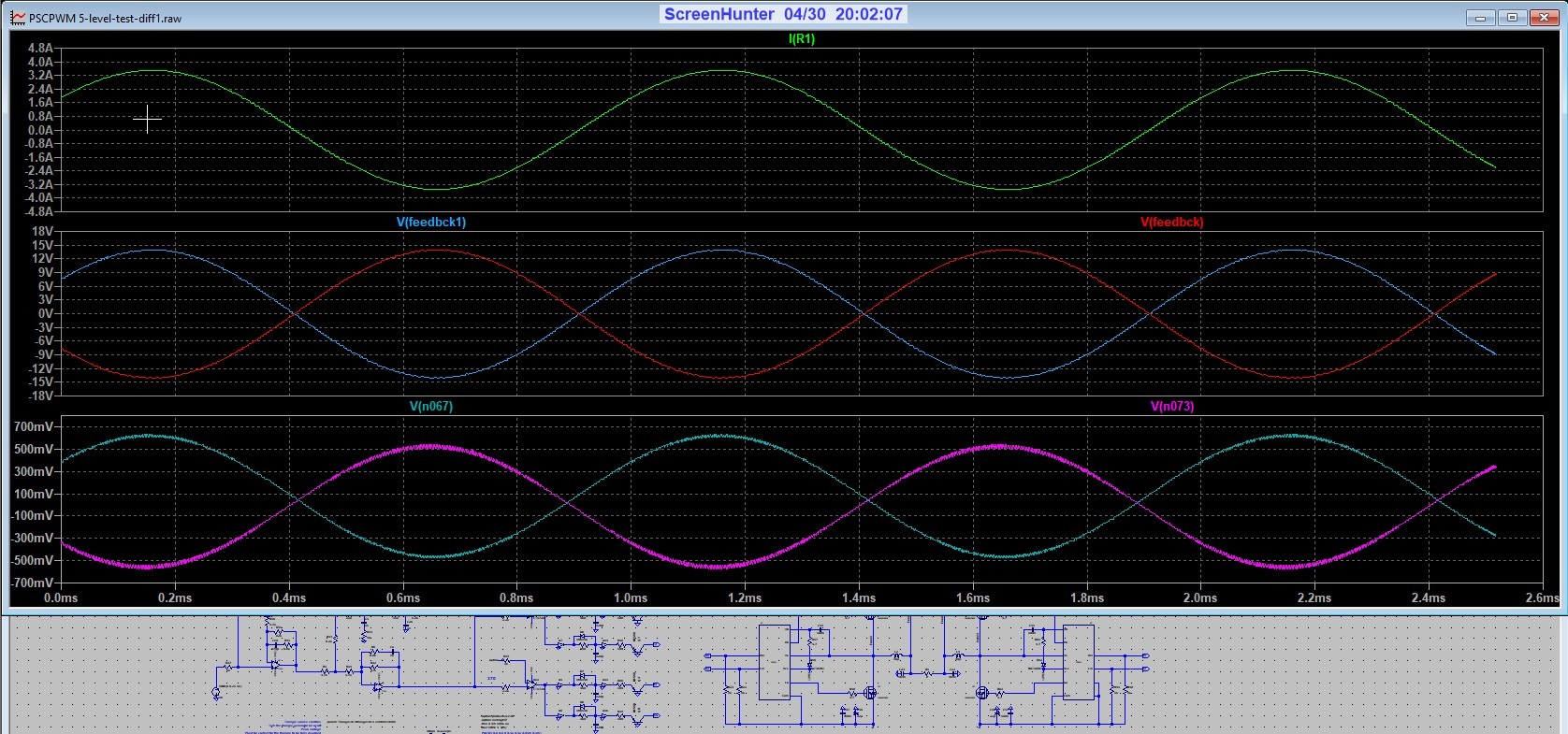

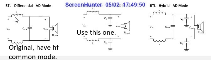

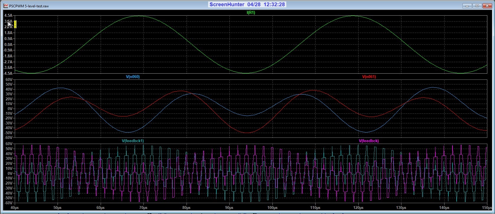

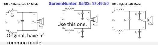

Hi
I have did some sims with the idea from the paper you did send me from Karsten Neilsen's paper on Parallel PSCPWM.
I did have a uge common mode voltages and see the pulse on the speaker with the differential mode low pass.
Calculating the coils is different because these are paralell, so double the inductance.
The only way to tackle this is using common mode low pass as this is normal used for BD systems.
on pic,s you see it. If I use only prepost feedback I get also common mode voltage problem with this low pass.
So did a design for the feedback using Pi, and that did remove the common mode voltage.
Multilevel flycap has not this problem also by the way.
Oke as seen in plots, using a single ended version from nielse is a way, however generating 60 degree triangles
meet a problem, 90 degree is not a problem. Maybe I can use a johhson counter, set to 12 x output signal frequencion,
dividing signals can be very accurate.
regards

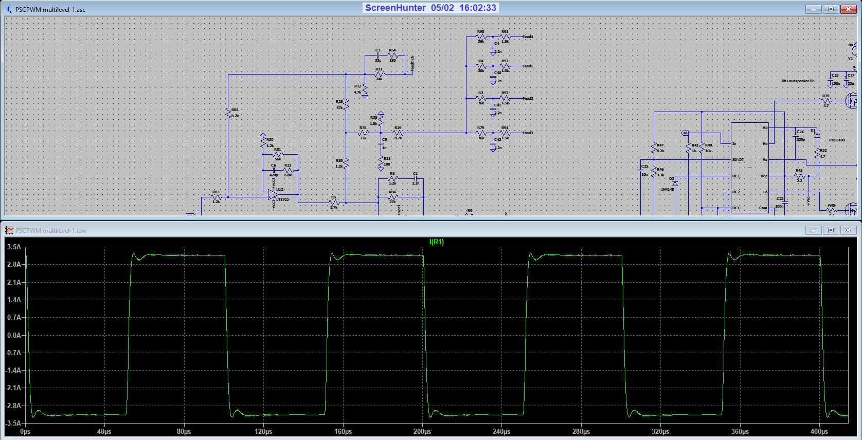

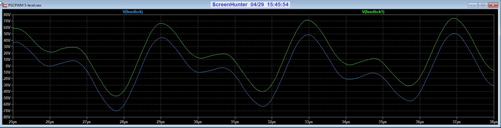

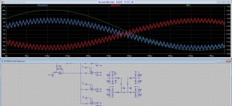

Here is the single ended 5 level, input 500 khz, output is 2 Mhz.
Becaause of it is single ended, I have not common mode trouble. Signal is so much cleaner.
Looks like btl for multilevel is not that good, except with some extra electronics and coils.
pic 1 btl, pic 2 single ended. you see noise level is quite higher in btl.

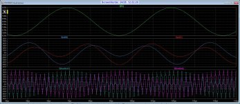

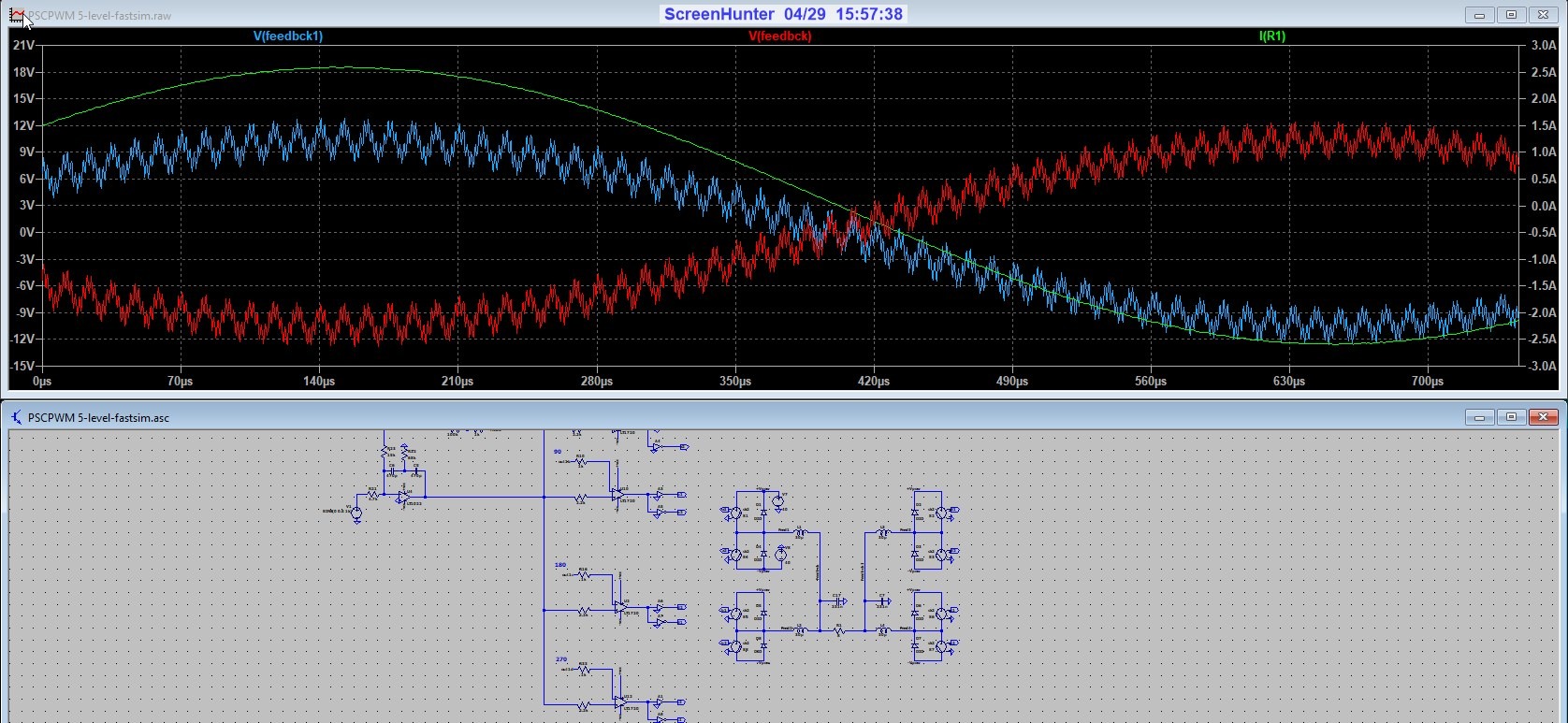

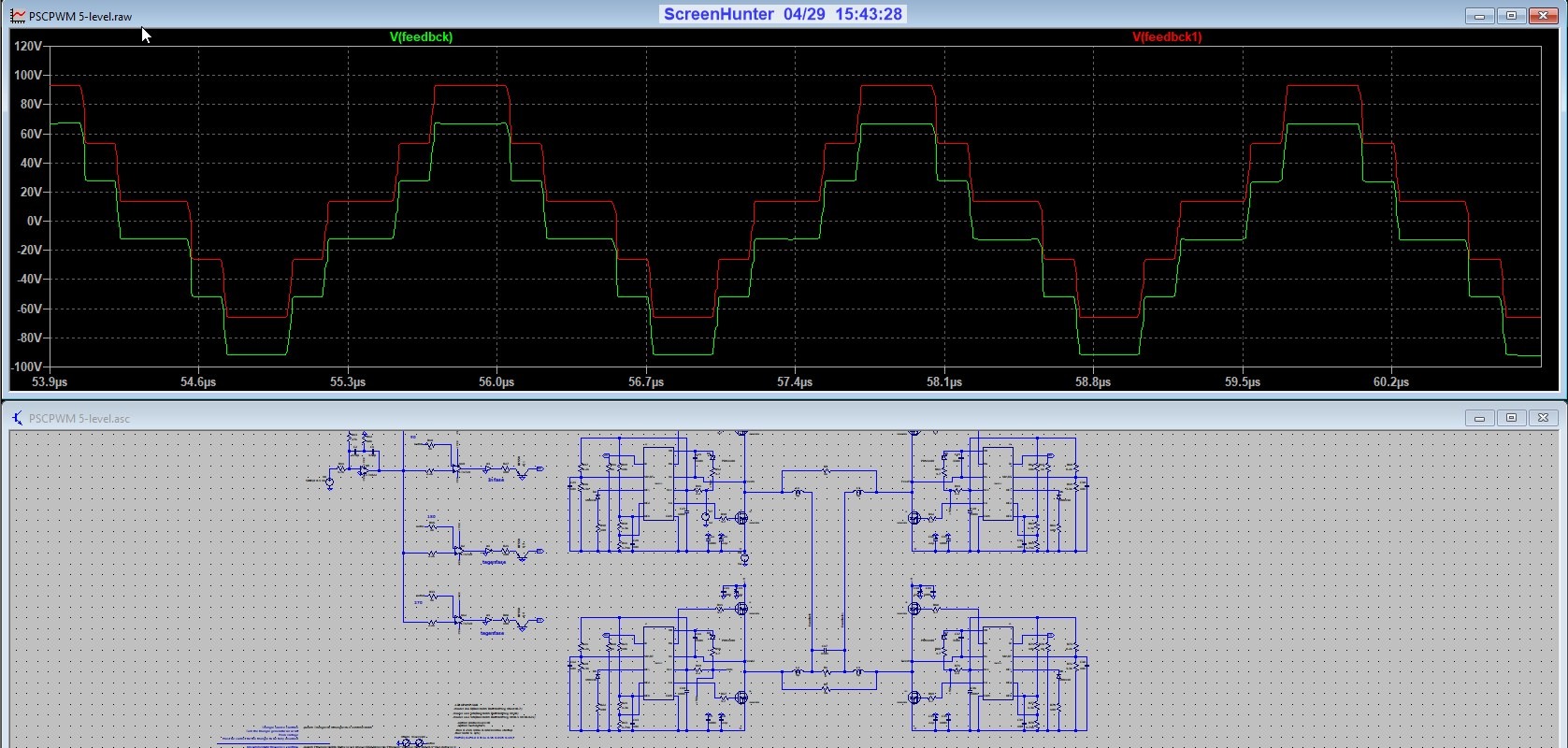

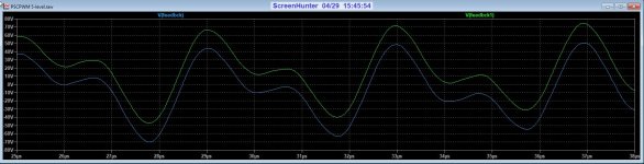

Common mode voltage, voltages between neutral, I am not shure I am confused with differential
voltages by the way..
On pic you see clearly this problem, with a common mode filter it is still present.
This problem is always present with BD pwm if there are differences in time and fase.
I did test again a postfeedback, fully differential input did removes the common mode completely.
See pic,s, where I use fast sim with perfect parts did lower the common mode significantly
with more precise delays. BD are prone to this, feedback can help.
When measuring the current over the speaker, then signal is very clean, but seeing pulses on
éach speaker terminal I do not like, these common mode voltages do give EMI through cables
possible do nothing with soundquality itselfs.
exciting stuff.
exciting stuff.
Welll, because I am not that calculate guru, I have seen that the common mode, or differential error was caused by
using a single input with btl BD stages. This problem is not present with a normal btl bridge.
I did need to set the triangle fases a other way for let this work, and that causes the differential error as a strange voltage
voltager on the output see the multilevel pulses there.
I did now use two feedback circuits and change the triangle signals such that the fases do cancel out the error.
THat means 0-180 degree for the left half bridge and 90-270 degree for the other half. When I use a single input an
common mode filter is needed.. and the fases are 0-90 for left half bridge and 180-270 for the other, audio is input
and do the 90 degree when it is inverted on one side, let it work fine.
