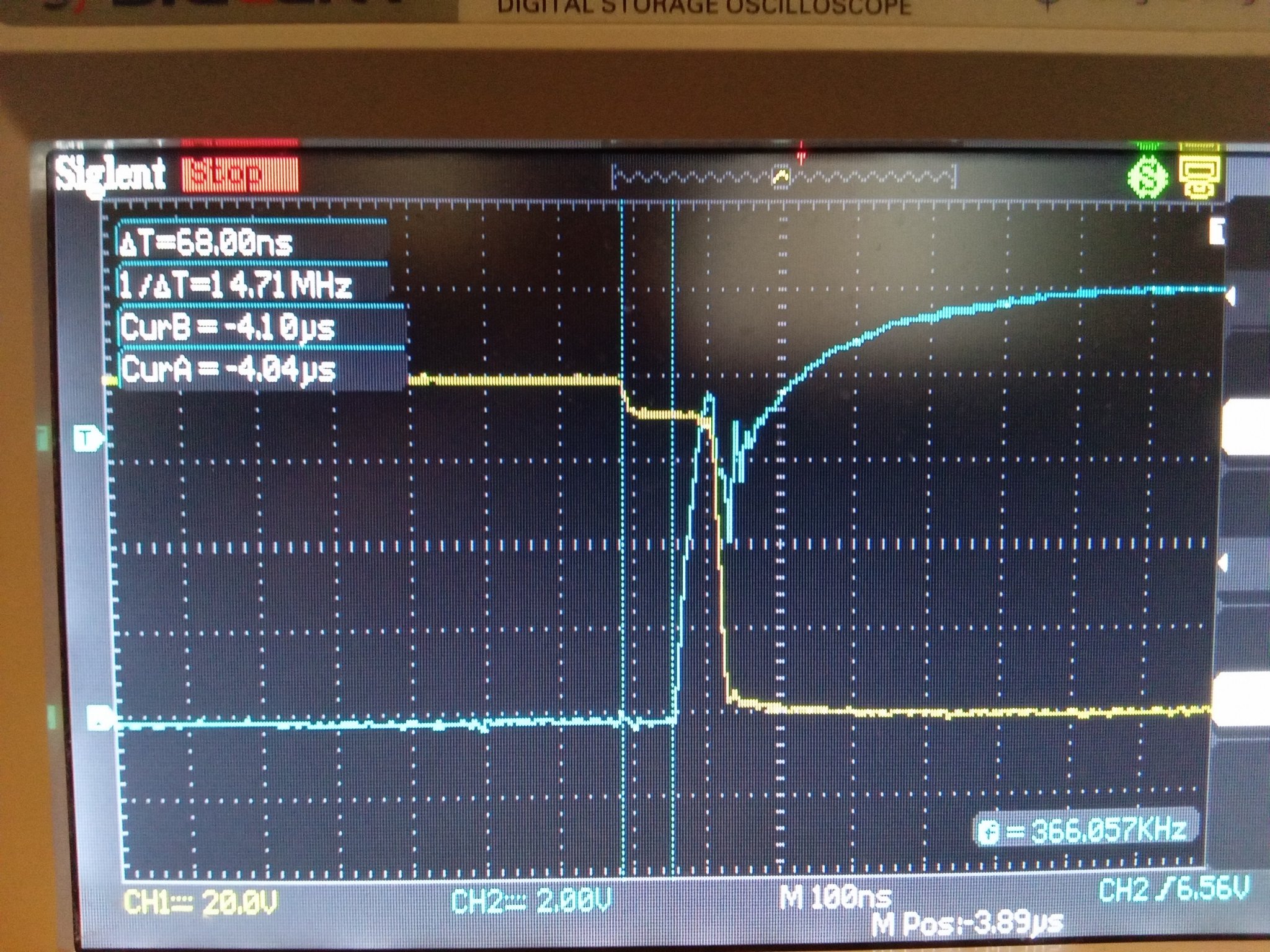

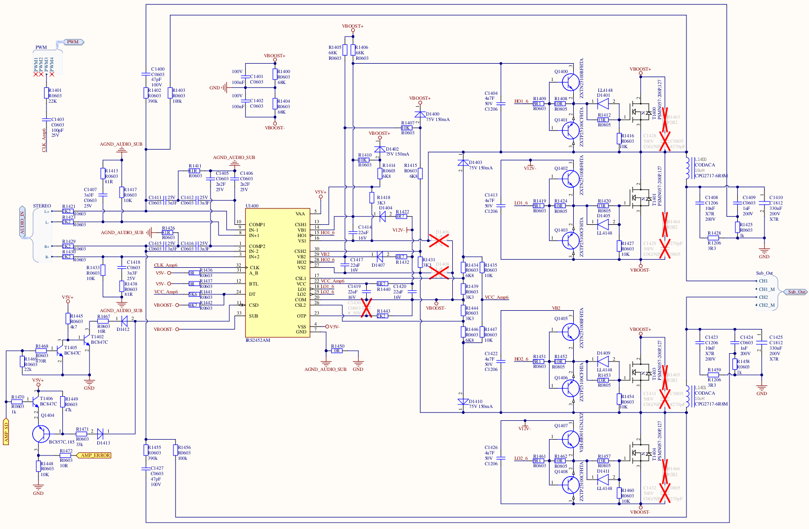

I have created an amp based on IRS2452 which is design-wise very similar to IRS2092 (has differential inputs).
It is based on IRAUDAMP23 (schematics attached). The MOSFETs in schematics have been replaced by IPP530N15N3GXKSA1 which have much lower Gate capacitance.

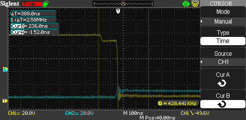

I have a problem with shoot-through when the high-side MOSFET turns off (and low-side MOSFET turns on).

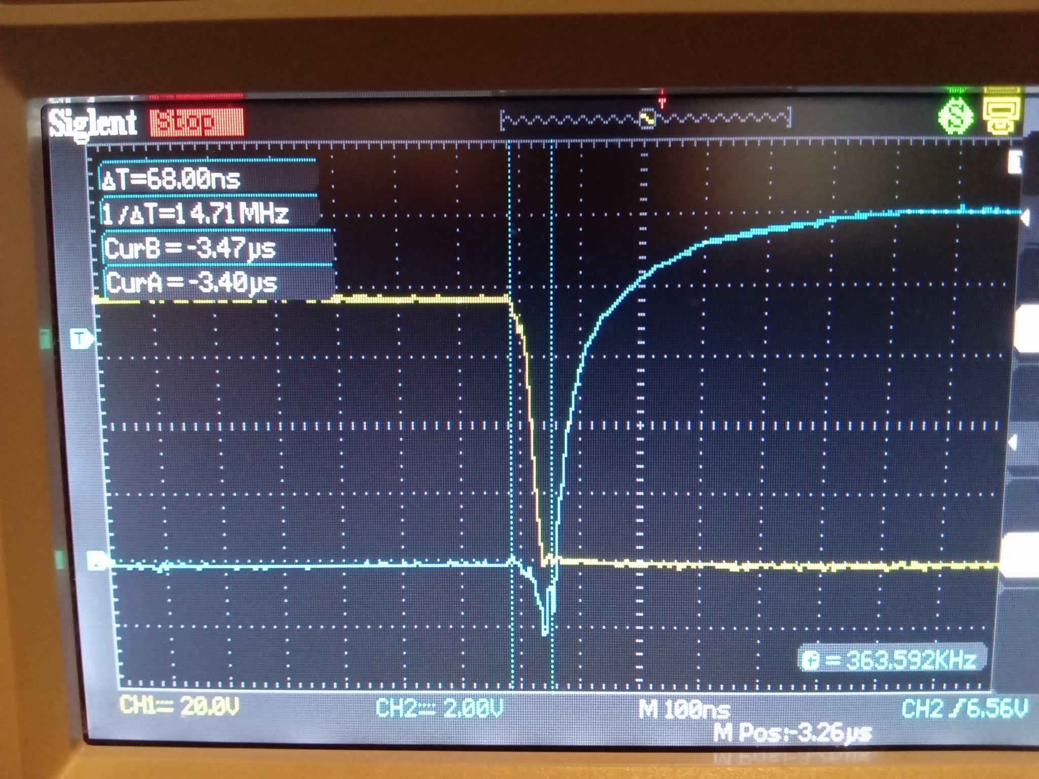

Although I have gate buffers installed, the driver inside the IRS first seems to slowly discharge to VBoost and then discharges the gate(or the gate buffer transistors) faster. Due to this slow discharge, I get a shoot-through.
See attached photos taken between R1409 and R1408(yellow) and R1419 and R1424(blue).
Any idea what could be the root cause ?

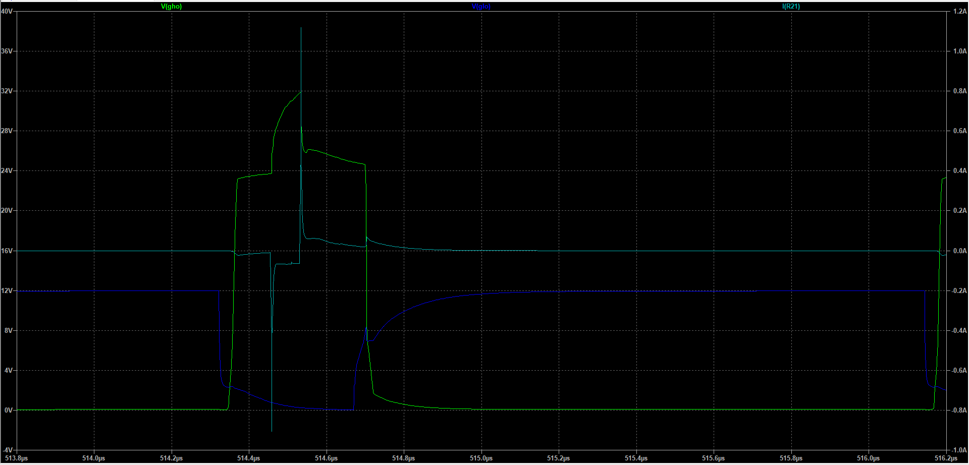

Hi Reactance!
While I'm experimenting on low supply voltages and connected VBoost +32V/-32V.
IRS2452AM is used as the driver.
DeadTime is set to the maximum value (105ns).
Load resistor 4 ohms, inductor 0.22uH, capacitor 0.47uF
The initial Cboot power supply is carried out through a 22K resistor to the buffer collector.

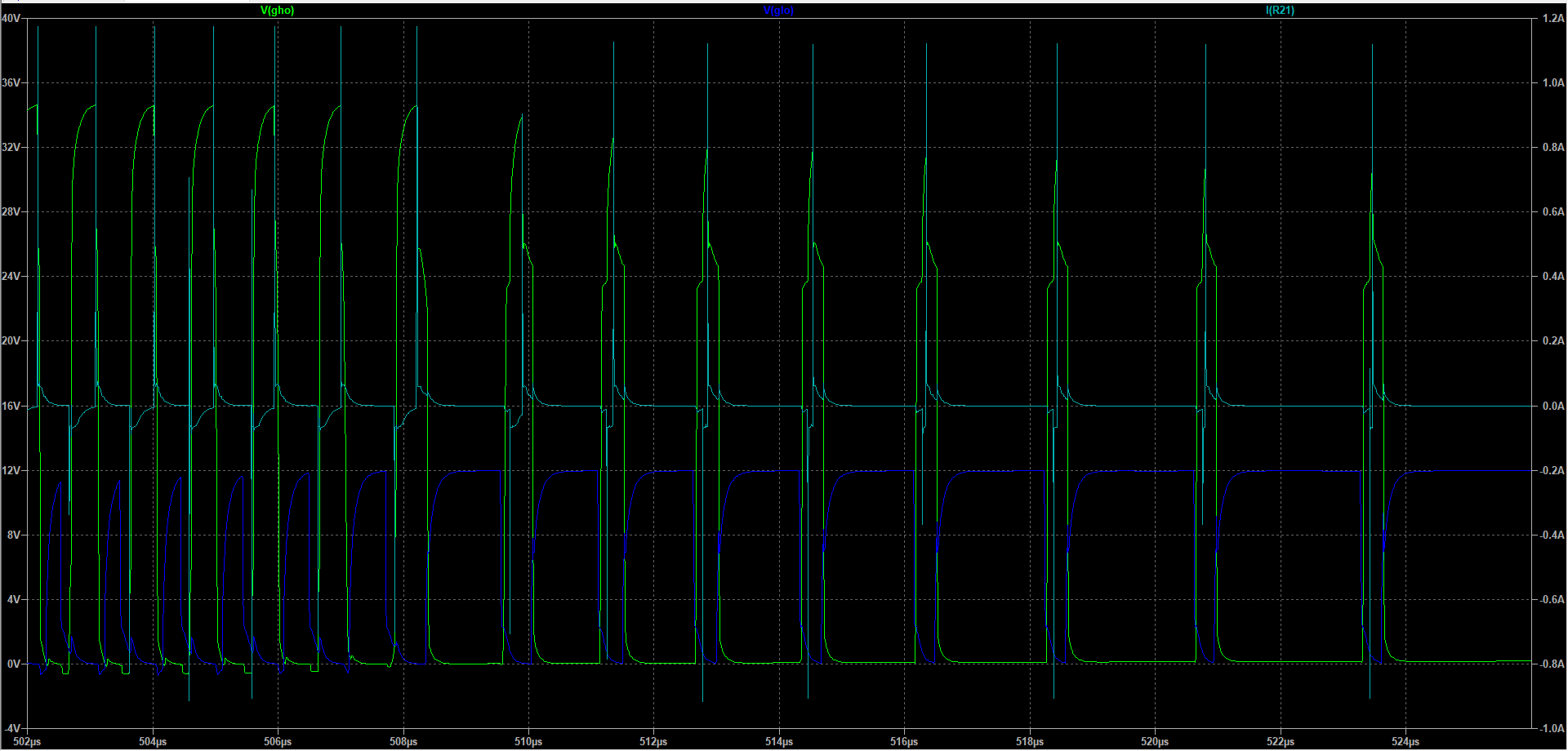

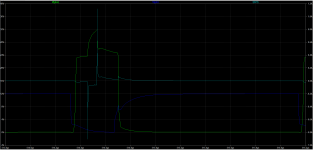

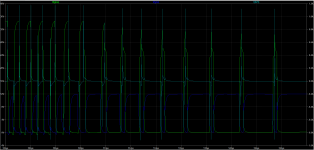

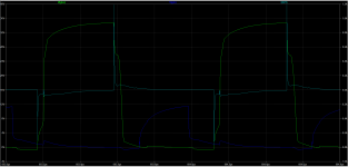

The problem is that at idle and under load, when the LO MOSFET is turned on for a long time, the HI MOSFET opens too early and closes too late.
In all other cases, the pulses are almost perfect.

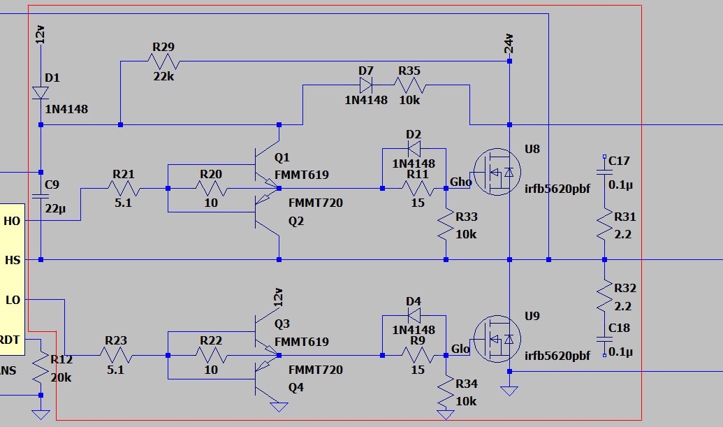

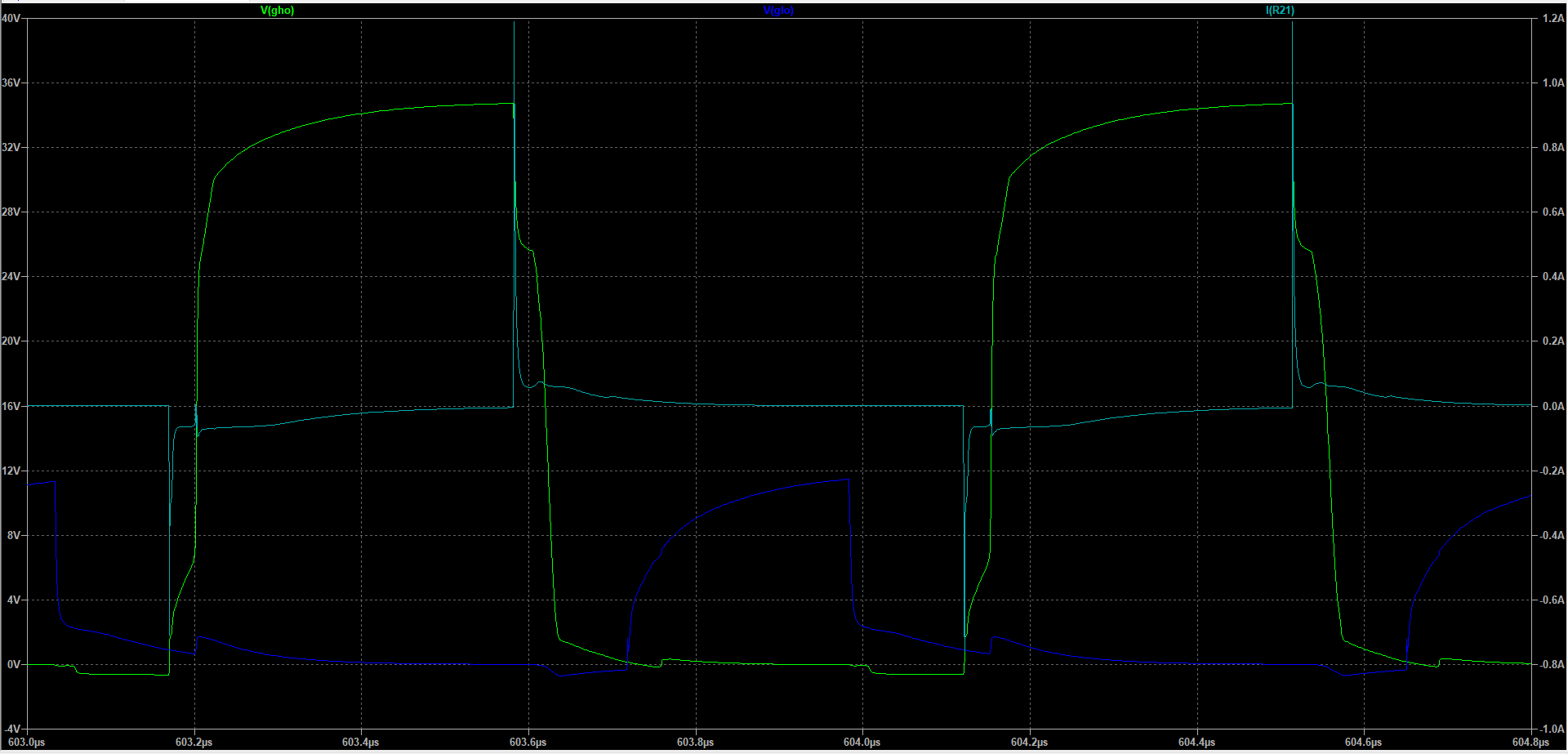

I made an imitation in the LTspice program and I got the results of the waveforms exactly the same as on the really assembled circuit, so I will give the circuit and the waveforms from LTspice.

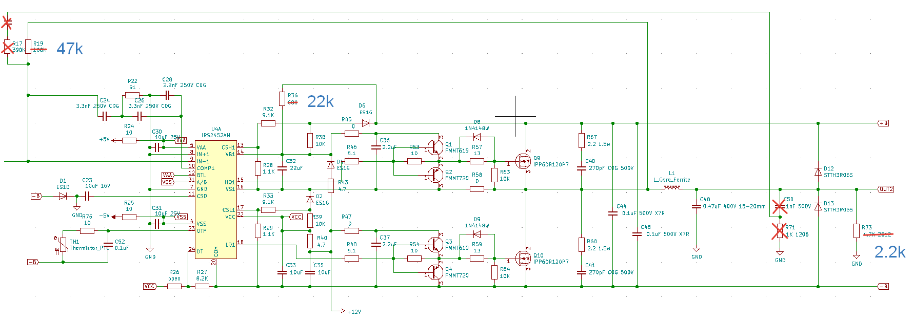

The diagram in the red rectangle exactly corresponds to the real one. Except that the power supply is unipolar 24 volts. The main thing is that the problem can be traced.

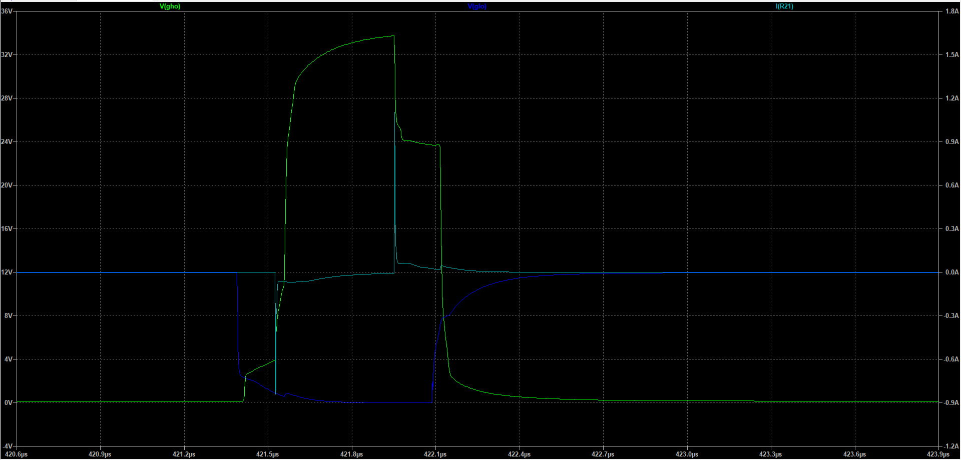

DeadTime in LTspice 140ns - as practice has shown, changing DeadTime does not affect this problem.
The waveform shows that when the LO MOSFET is turned on for a long time and the HI MOSFET is turned on briefly immediately after the LO MOSFET is turned off (without DeadTime), a voltage appears on the HI MOSFET gate that falsely turns on the HI MOSFET.
This voltage drops immediately after the LO MOSFET is turned on.
The diagram of the current taken from the resistor R21 shows that the pulses from the driver come correctly, taking into account the DeadTime.
It looks like this is some kind of voltage associated with the parasitic capacitances of the transistor.

When connecting the C17/R31 and C18/R32 snubber, the HI MOSFET is turned on correctly, the shutdown also occurs with a delay.
In any case, this cannot be a solution to the problem, since a very large current flows through such a snubber, a very powerful resistor and a large film capacitor are needed. I haven't tried this option on a real circuit.
Reducing the capacitance of the capacitor in the snubber does not solve the problem of early activation of the HI MOSFET.

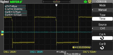

All right. Normal switching works almost perfectly, as in textbooks (see image waveform_normal in post 22).

The real scheme corresponds to the image in post 22. Diagram circled in red fully corresponds to the actually assembled scheme.
I use IRFB5620 transistors with a buffer as shown in the diagram. I also tried to connect the IRFB4020 without using a buffer with Rg 18 ohms.
I tried disabling the diode to discharge the gate MOSFET. I tried to change the buffer transistors. I removed resistor between the base and emitter in the buffer.
In all cases, this effect remains. I don't know what else to try to fix it anymore.

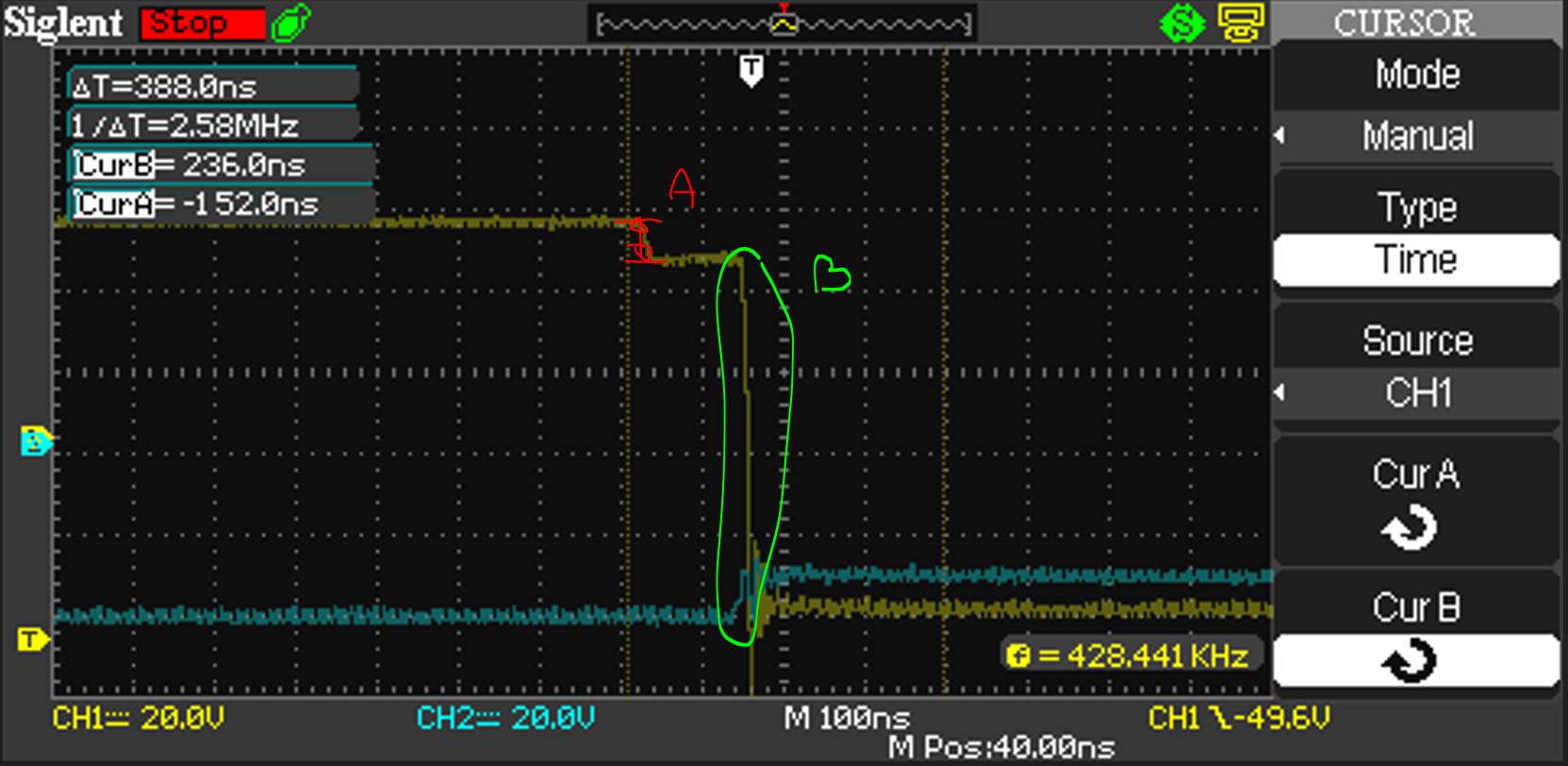

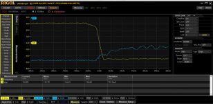

What you see in your measurement is that the first step A is the gate driver turning off (notice the step is 12V as is the driver voltage), and actually doing this really fast and text book like, then there is a delay caused by the mosfet and what ever driving circuit is in between ....
B is the voltage the gate follows, which is not the same as current running through the fet in the same way
I think what is more surprising is that you can actually see such a nice step and not a slope ...
Where is A measured ... output of the driver IC or the gate?

My diagram is quite large, so I give only part of it, but the most important

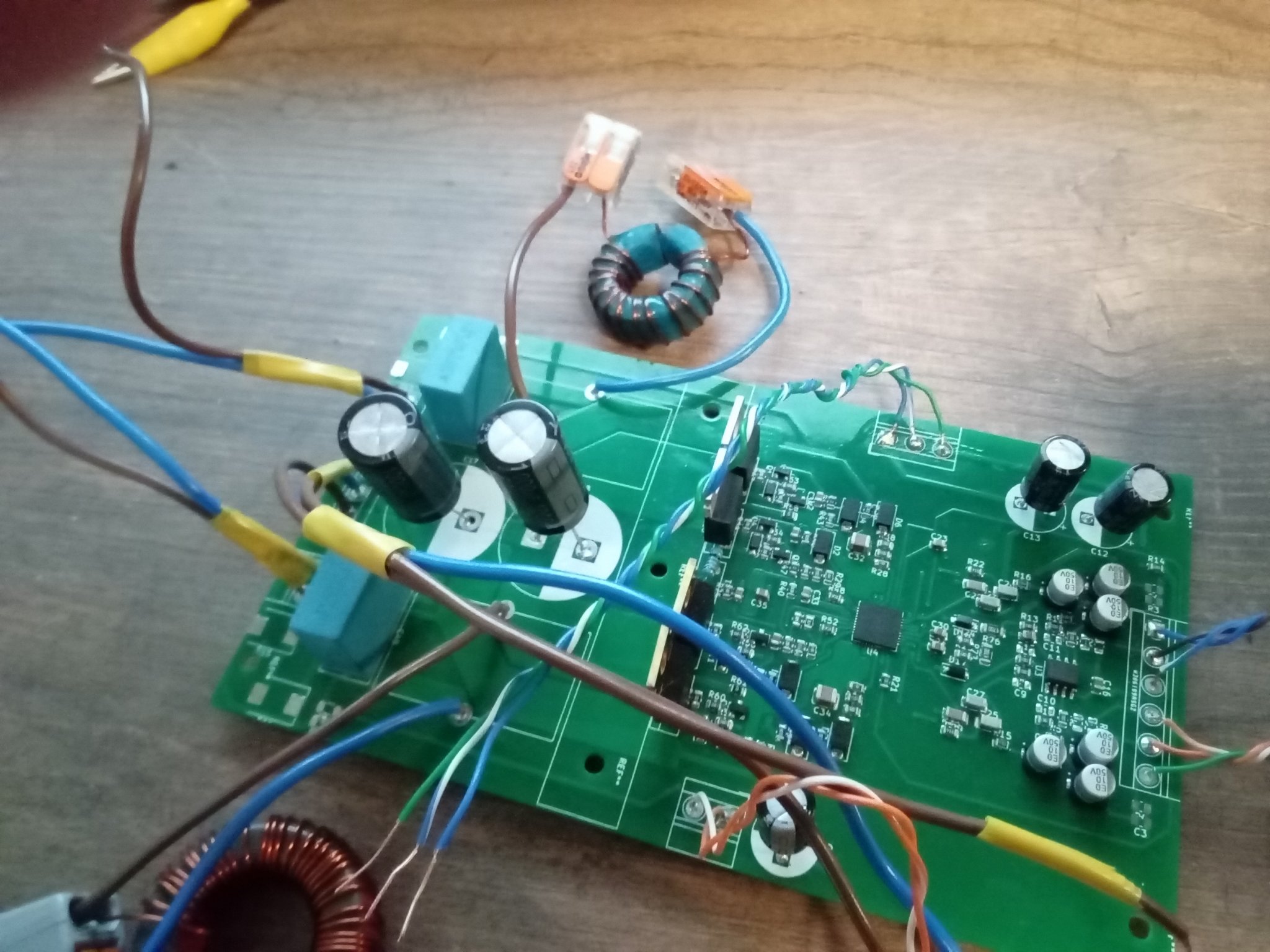

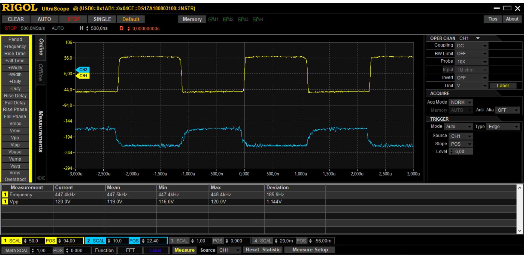

What are the exact conditions in the picture in post #31 ?
I do not like the look of the blue coil ... but being gapped it can probably work. Is the other a T106-2? ....
If you are drawing 5W continuously the fets will start to heat .... .... if everything stays cool witout signal, I think you are on the right track.
Frequency is 363 kHz as read on the scope? .... also a good sw freq

Measurement conditions in post 31: idle frequency 338 kHz, voltage +32/-32V, load 4 ohms, power 5 W, DT 65 ns.
I have two types of coils T106-2, as you correctly noticed, and ferrite with a gap of more than 2 mm. This is necessary for experiments.
The frequency with connected load and shorted inputs is 338 kHz.
C36 and C37 please review this capacitors I'm not happy with the fact that the bootstrap cap has to charge that up as well during its discharge cycle also what type of capacitors are you using for bootstrap hopefully tantalum and the polarity is correct.
