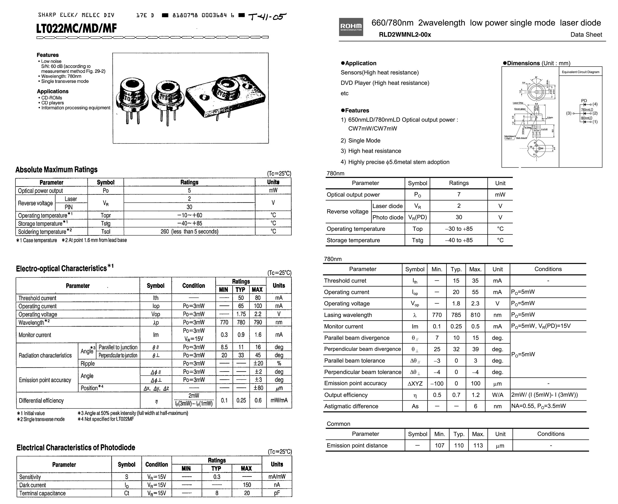

Big setback in the moment - the Sharp LT022MC diodes I got from an ebay seller are all dead. I have to deal with diodes I got from Rohm. Mechanically
they have a 5.6mm rim whereas the original Sharp have 9mm.
Does anyone out there has access to a metal 3D Printer?
An adapter could easily be milled from brass but there are notches
for alignment. This is why I would like a printed one.
I also cannot read from the datasheet if astigmatism is different.
Electrical characteristics have to be adapted as well. Anyone out there to do the math?
An APC for Sharp LT022MC diode is attached.

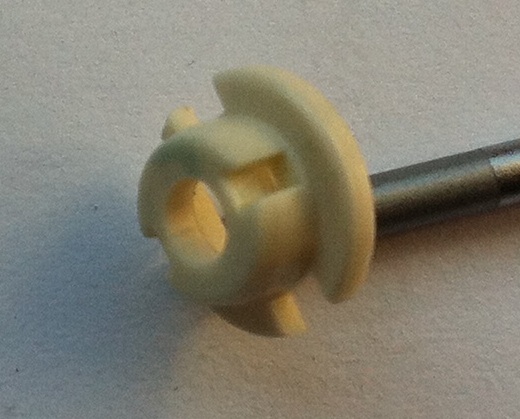

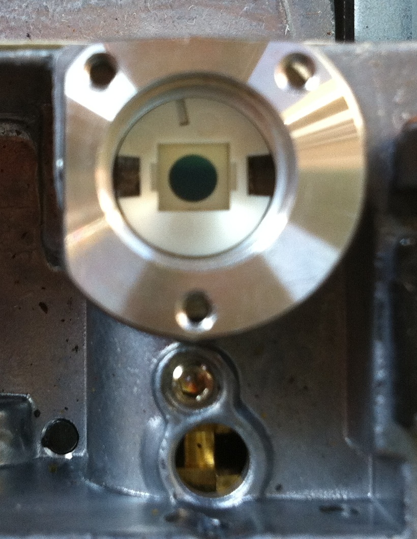

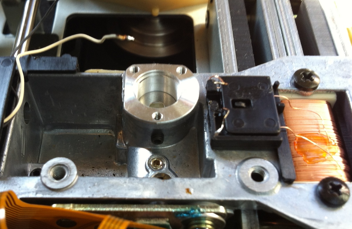

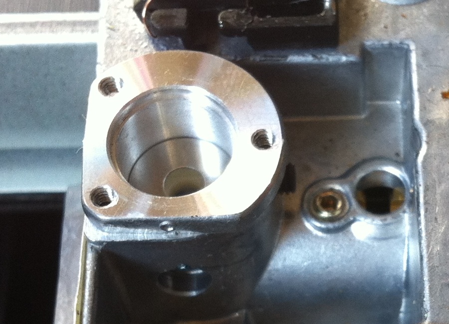

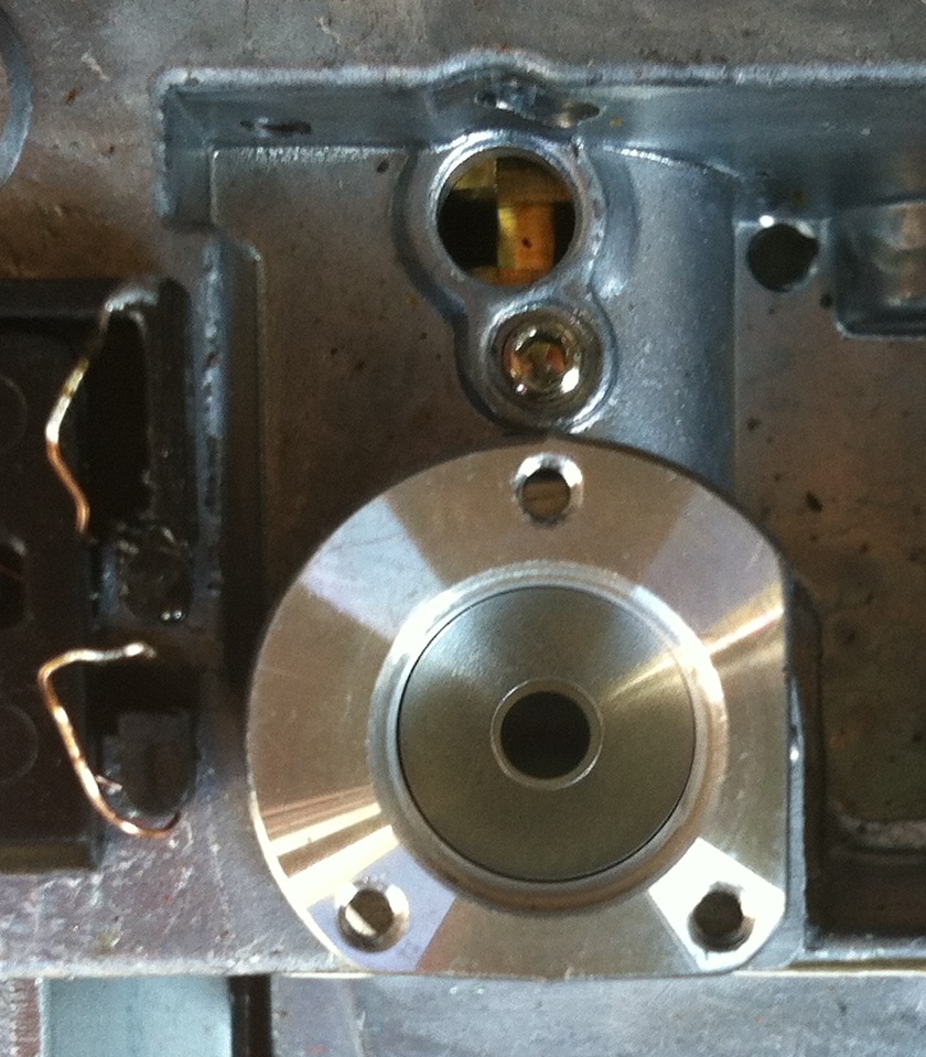

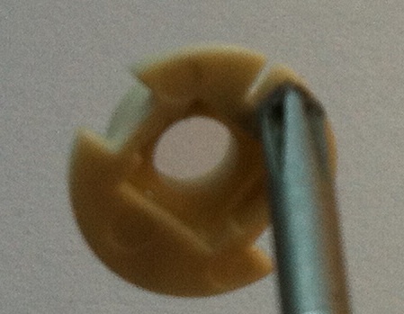

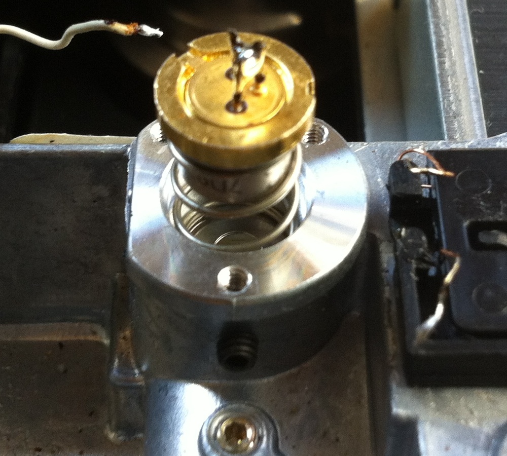

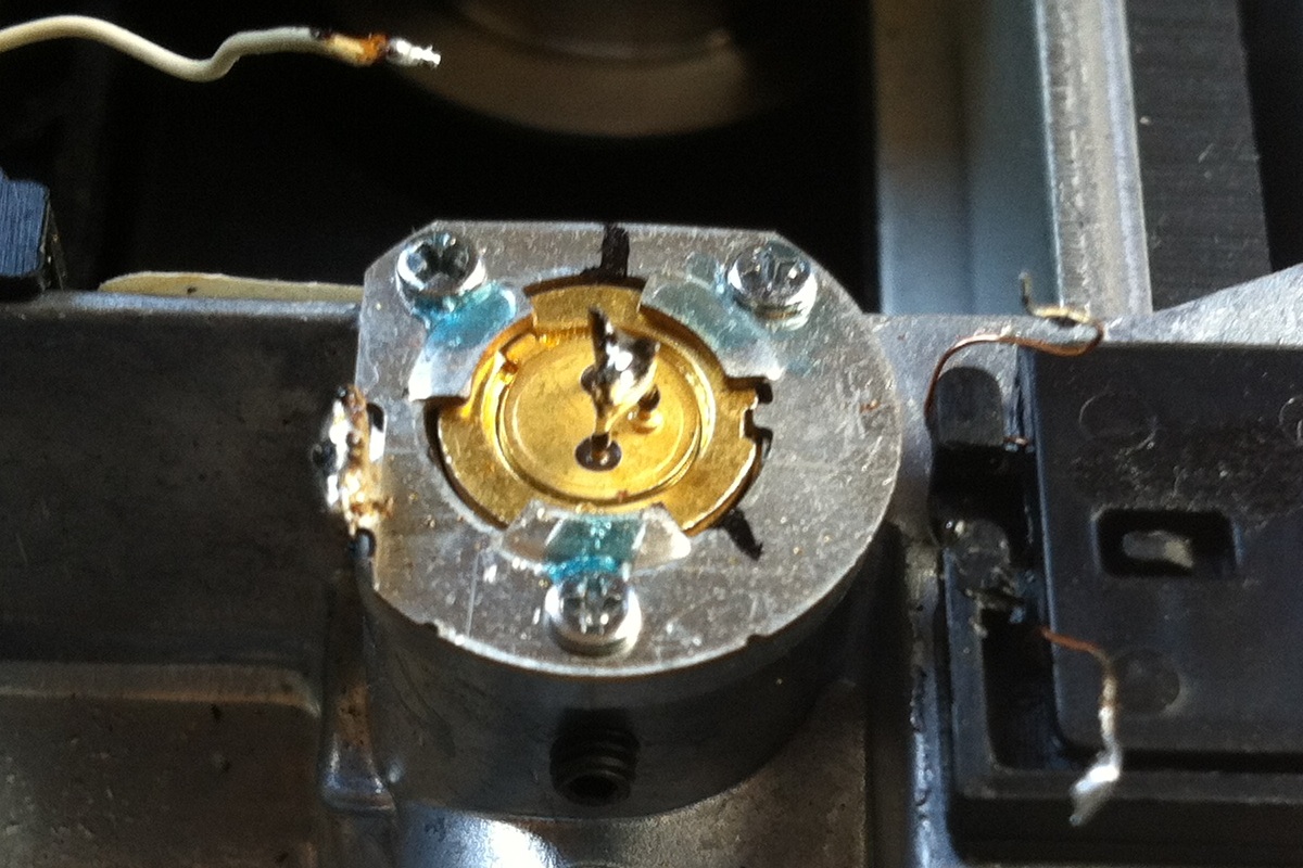

I did tear down a Sony KSS-123A laser some time ago:
http://www.diyaudio.com/forums/digi...et-us-build-one-ourselves-11.html#post4467651
Now I did the same with the BU-1C - please do not forget that this mech was working - in the moment it is sacrificed for good - I hope.
The following images show the assembly of the laser diode Sharp LT022MC.
The diode is being held in place by a washer that is fastened with three screws.
To my surprise, after unfastening the screws, the diode has much play in the washer, around 0.5mm.
If vertical misalignment and some horizontal offset had influence, this would be the first obstacle to overcome besides aligninging the grating.
The spring sits on two washers that hold the diffraction grating in place. The glass of the grating is glued into in a white plastic frame.
I assume two washers give lsser friction to keep the grating movable for adustment. To my knowledge, the adrustment is done by turning the grating.
After removing the grating you sees a little bit of thread locking fluid. But it has no strength, the grating can be easily removed.
It looks like the assembly is placed in a tube that is placed in the die cast casing.
An allen screw indicates that. Even though it looks like that the allen screw holds the diffraction grating in place this is not the fact.
But I have no fitting allen key in the moment to check that.
BTW the brass parts that can be seen in the hole mostly at the lower part of the images belong to the photodiode array.
I assume that the alignment was done before the laser diode & diffraction grating were placed in the laser assembly.
Again, any ideas about this is are appreciated.

According this various offers there must actually be anywhere special companies or guys, which have appropriate equipment for diode replacing and precision adjustment.Many of us still have first and second generation CD Players, built like tanks,
with linear motors, brushless disc motors, wonderful, heavy pieces of machinery and probably lasting forever - except the laser diodes.
And replacements for the pickups are no longer available or cost as much as a new player.
There are many Sony KSS-XXX Lasres out there, in many brands, with different physical dimensions, maybe different coil assemblies .
But what about the diodes?
Maybe many KSS-Lasers shared the same diode over the years, and maybe, besides the risk of static electrity, these diodes can easily be replaced?
Does anyone have information about this?

watching this and the other threads with interest. The Laser for my Pioneer is no longer available!!
Can I just ask though, in all the Players you are working on, have they stopped emmiting Light?
In all my years as a Repair Tech I think I can count on one hand the times a CD Laser was not lighting. The cause as I thought was the receiving Diode and the lack of a large enough pk-pk Output waveform.
Continue the good work.
P.
P.
No, they haven´t. This is why I stopped in the moment, because bringing the diffraction grating out of adjustment kills the laser...
..... bringing the diffraction grating out of adjustment kills the laser...
Moving the Grating shouldn't kill the laser.
The Grating was an alignment to be carried out when replacing a Laser in a Pioneer.
Were you ant-static protected when working on it?
P.
By "Kills the laser " i meant changing the oisition of the diffraction grating renders the laser (unit) useless. Grating and laser have too much play after disassembly in a Sony . No way (in the moment) to reach the grating an adjust it. See photos.
Hi i signed up after seeing your post. i'd like to refurbish a jvc optima 5/5S optical pickup. believe it or not there's none available in the UK ���� 🙁 did you have any success?
Some important questions about the diffraction grating used in 3-beam lasers:
-When aligned, the "sweet spot" means that the side beams next to the center beam
have the same brightness? And a misaligment does not influence the distance between the beams, only their brightness?
- When being focused on the CD, the distance between the center beam and side beams is about 1.6µm as far as I remember. Not so important right now.
But very important: What is the distance before the beams enter the collimation lenses? Something still visible to the bare eye?
I assume the distance between the photodiodes on the receiving chip could be a reference?
All the best,
Salar
All the best,
Salar
