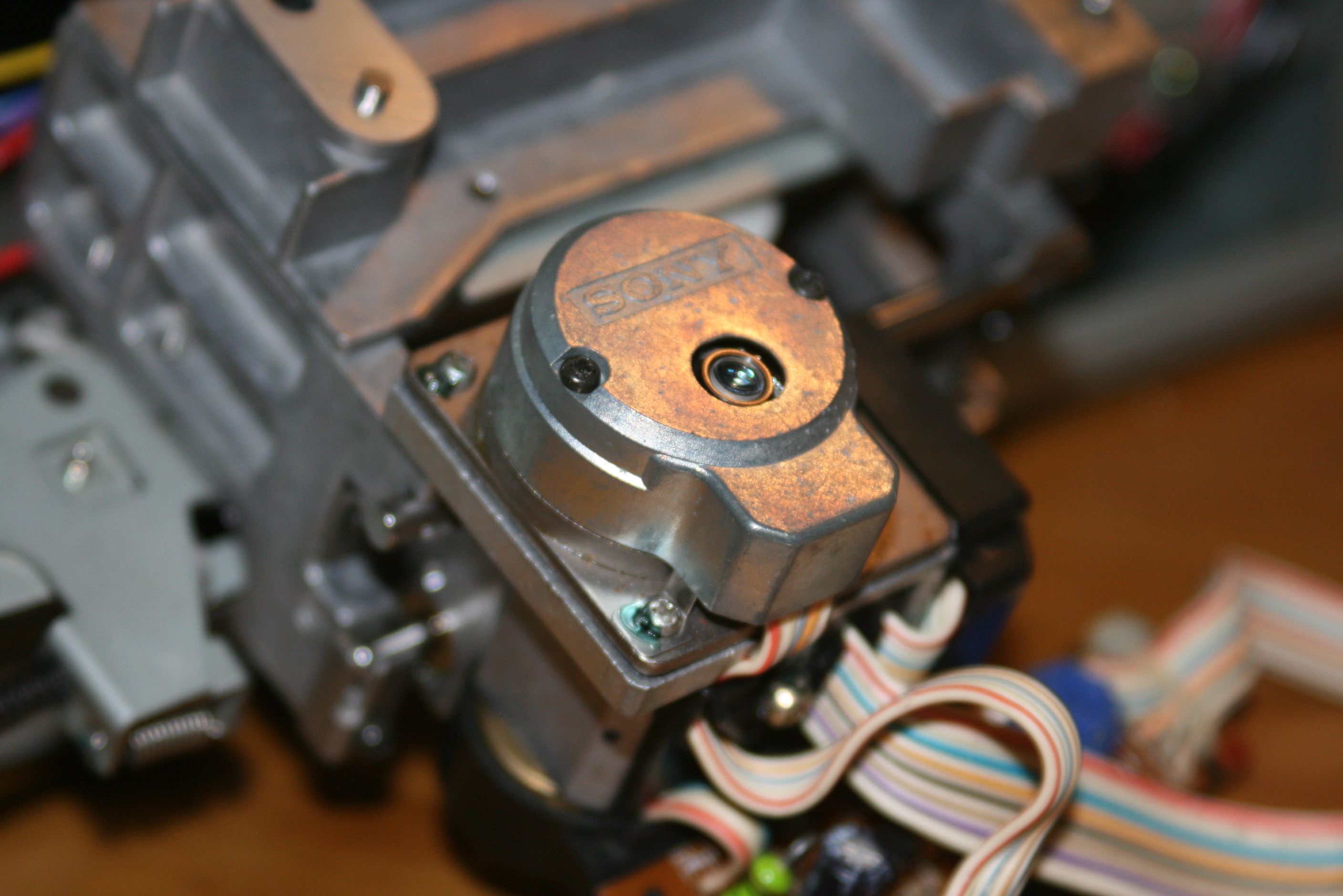

I also had a question about replacing the diode in the KSS-190A and KSS-271A. I will buy diodes, I will take 5 pcs. and I’ll try to do it myself. But most likely, in addition to adjusting the diffraction grating, the position of the photodiode array can be rearranged, and this greatly complicates the situation.Unfortunately I am still not able to find those company, which are able to remove the old diode replace the new diode include all necessary mechanical adjustments.
Who can help to find such companies or guys?
Since the diffraction adjustment is not possible in these blocks, it is glued, the diode itself needs to be adjusted.
The diode in KSS-190A has so far returned to its place, it is still working, but the radiation power is very weak, it will not detect the CD-R at this radiation power. In feedback, the RF amplifier CXA1081A (between pins 2-3) increased the resistance of the resistor to 47k. To artificially raise the level of the RF signal, CD-Rs are now detected, but this is a temporary measure to use it at least somehow ...

Maybe. But I was playing around with a BU-1 that did not need repair.
After removing the original diode and after putting it back, the Eyepattern was still there, though very blurry. Only after I touched/moved the grating (which was secured by thread locking fluid) things did not work any more.
So I assume, if there is some room for the diode to move, there is a chance
to do an alignment by positioning the diode.
Does the KSS-190 give some room for the diode to me moved?
Ist there also a spring that fixes parts like the diode?
In the BU-1, the spring gives pressure on the grating as well as on the diode, so things cannot move out of alignment...

How do you know the diode is weak or broken to begin with? There could be problems with other parts of the circuitry that controls current etc. to the diode.
Surface mount capacitors, especially old ones, could degrade, as well as tantalum. I have swapped laser assemblies as a first step to repair, but it made no difference, and the problem was in the circuitry. Replacing the diode itself, which requires all the meticulous alignment etc., may best be a last resort.

This topic is about changing the diode (as a last resort) and not intended to discuss other possible repairs…
BTW I have a laser power meter and it looks like the "original" diodes available are all crap. From 40 I measured, only 8 barely reached the output power of the already worn original. So modifying APC and fitting in

Okay, but I could not tell there was a "last resort" aspect to this in the first post, or most of if not all other posts.
Why would original, presumably unused diodes be so low in output? Don't they degrade with use?
Because they are cull or ESD damaged. Production
of 1rst/2nd generation diodes ended almost three decades ago.
Okay, but I would not have expected all of them to be cull or ESD damaged, especially the former, and if original packaging, ESD would be unlikely too.
Tell this to the traders on ebay or alibaba. None of the diodes were
placed in conductive foam. One purchase was loosely wrapped into antiststatic foil, with some
glass-windows broken. Samples from Rohm were the only diodes I received that were packed correctly...
