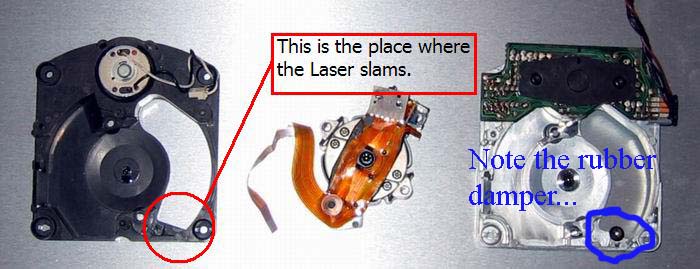

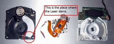

Well I will disappoint you, but my CDM doesnt have anykind of rubber.
It slams pretty hard. This is unusual.
