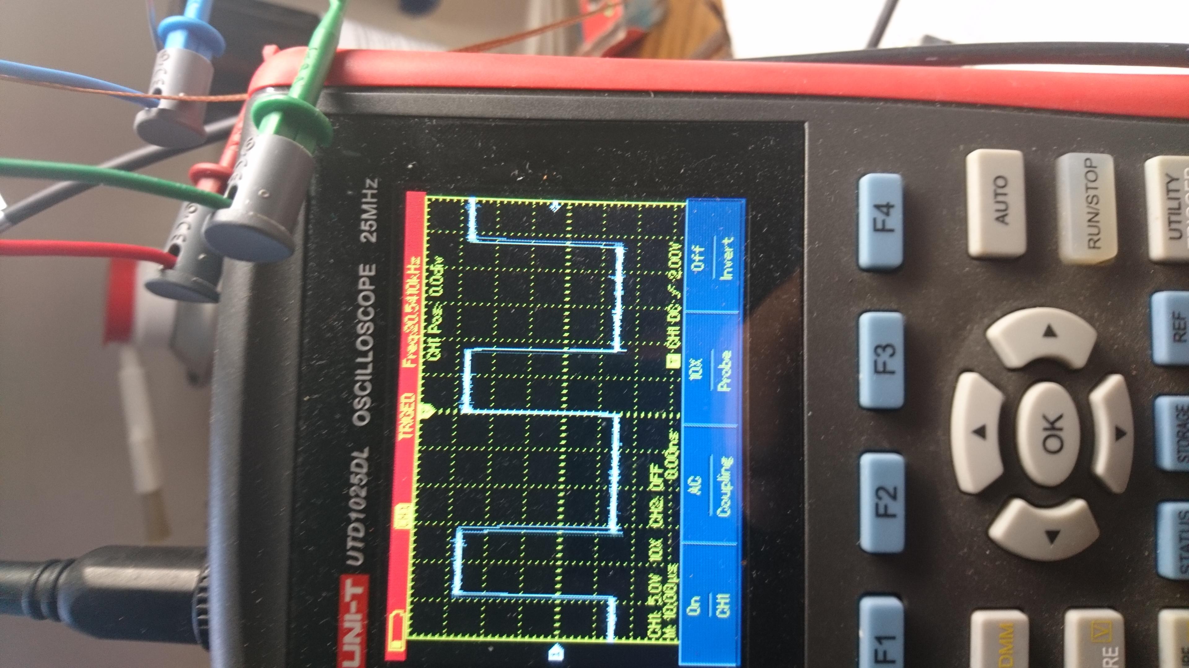

at 30V i have 27khz, but i cant trigger it good, because its moving on the timebase a little, but very quick. Is that normal?
If you have audio driving it, it's normal. If you have noise coming from the preamp circuit, that could also be causing it.
i have no audio connected. Working only on battery but still high frequency hissing noise is comming out of the speaker.

without pre amp the noise is still there, but its only high frequence noise and more stable. One Bank of fets with highs and lows getting more hot.
Do the waveforms in the gates of those FETs look different than the others?
I think you said you tried it but try pushing/pulling/twisting the inductor for that group.
yes, i tried, but nothing happen. Waveform is everywhere the same. Sound starts intermittend after a few seconds. Like peep peep peep, but very short impulses.
