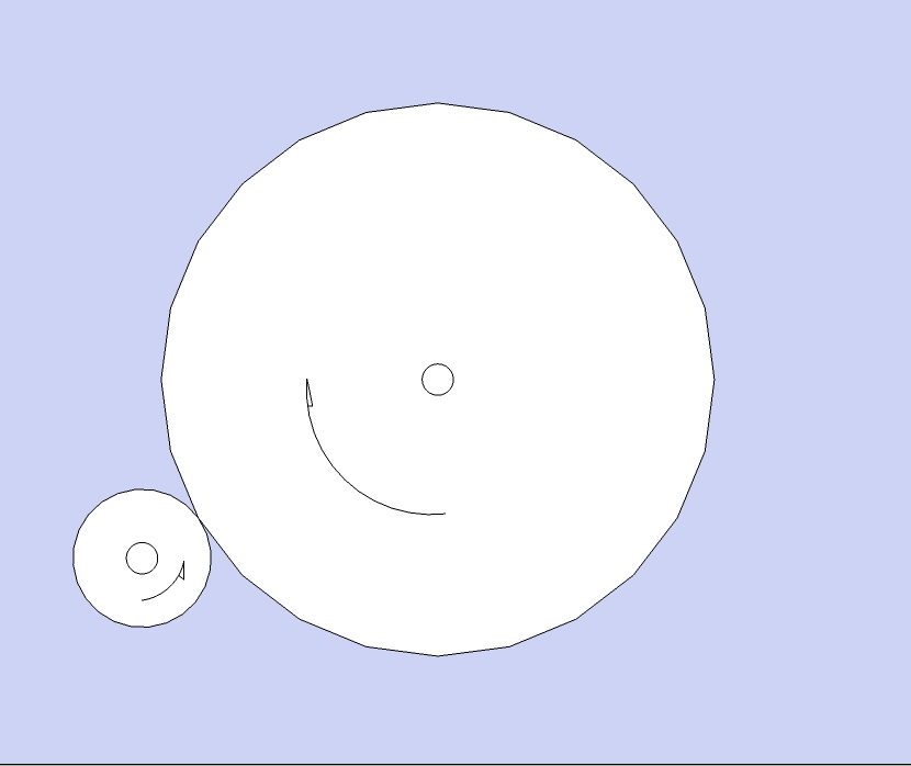

ok, how to do it (reverse rotation)? What about the speed...if a smaller "platter" could be used and the speed increased and then drive directly via the smaller reverse rotating DD motor.
hmm , I think it could be very interesting.
turn a TT upside down?
well it could work, 'ole Aengus
but I was hoping for a more elegant solution.
no direct coupling
I have to abandon the "direct-coupling" approach a la Teres Verus motor style. First, too much work and fiddling for me so I'm going to stick with using a belt or an idler wheel that's more practical. On the internet I found this quote from another forum thread that makes sense to me:
"An idler provides a rubber gripping surface so that the motor can grip and drive the platter. If the rubber surface was part of the motor drive pulley or the platter, then speed would change as the rubber wears or compresses, but by making the idler out of rubber, and the drive pulley and platter out of metal, the drive ratio and hence speed, remains constant, despite the vagaries of the rubber idler size over time. In summary: It provides the metal/rubber interface needed for grip. And it allows the dimensions critical to accurate speed, i.e. pulley/platter diameters, to be machined in metal and hence much more accurately than in rubber"
All I need is a quality idler wheel in between the two platters or back to belt-drive. Or I will try to modify the direct-drive electronics to "underdamp" the feedback loop network to make it more relaxed sounding suggested by a member here, if I can learn how to do it... direct drive is still the most elegant approach to me if done right. Gotta stick to my screenname, you know. 🙂
