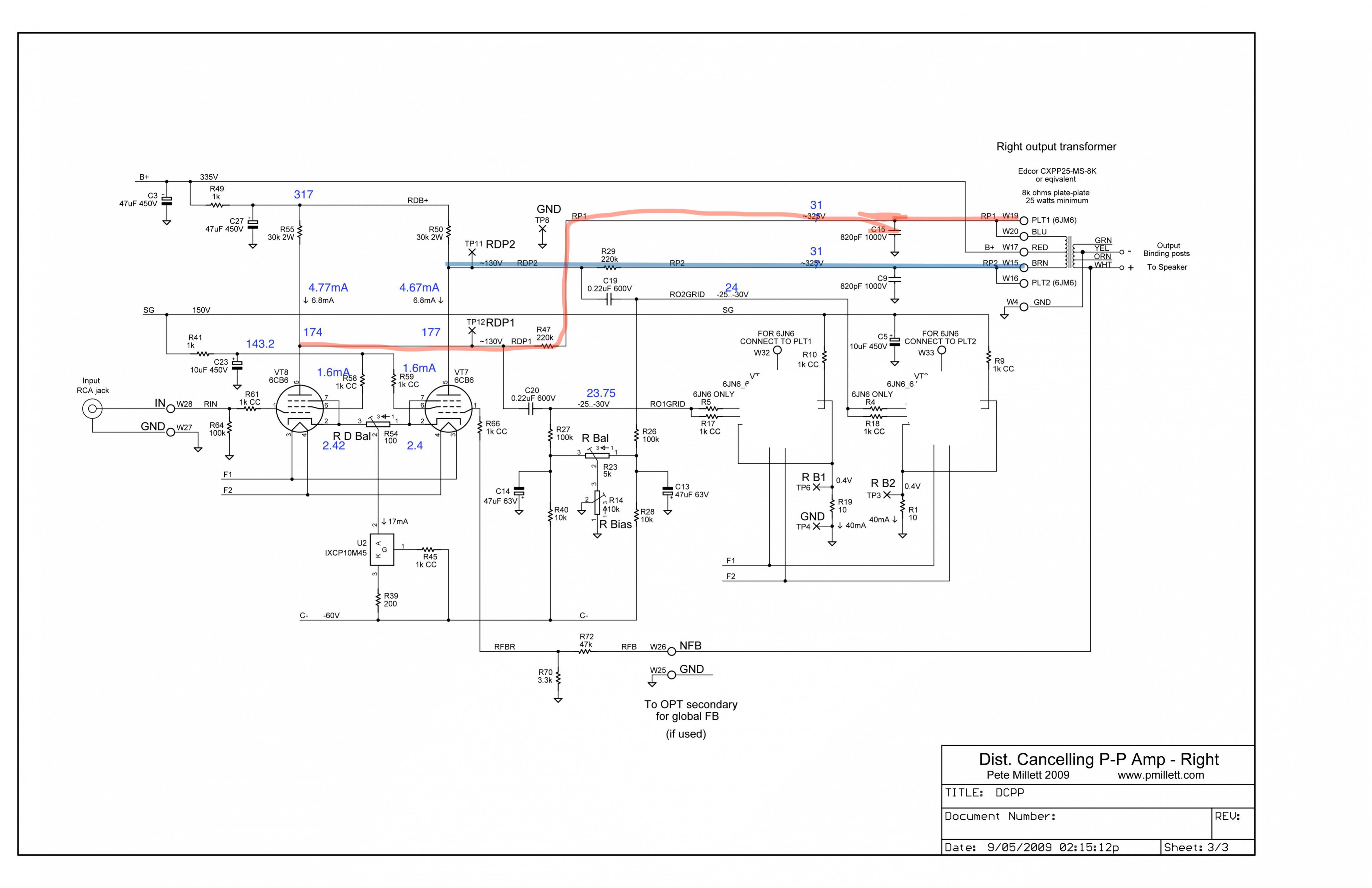

However, I'm guessing this would still include the OT via the local feedback as shown in the attached. If so I can also check the output but the level might be very low.

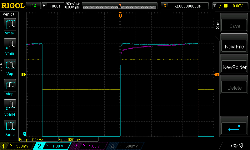

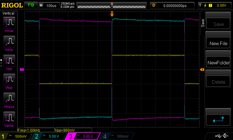

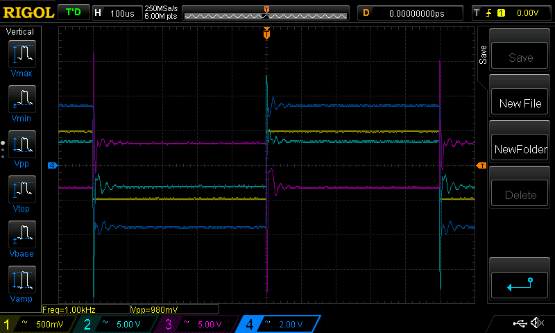

I hooked up my analogue sig gen to the input, removed the two output valves on the right channel, and scoped the grid resistors with my Rigol.
Attached is the trace with input, and the two grids at 1kHz and ~1Vpp input. Also attached is same conditions but one grid inverted and lowered / zoomed.
Then the same input with the output valves replaced, signal across the load in dark blue.
To me, that means it has to be OT, no?

1. Why are those 820pF caps connected from each primary tap to ground?
The primary center tap is at AC ground.
Effectively, 820pF is connected from the center tap to the Push winding;
and 820pF is connected from the center tap to the Pull winding.
820 pF is 9,705 Ohms at 20 kHz.
The 820pF and 1/2 of the primary is a resonant circuit.
the other 820pF and the other 1/2 of the primary is a resonant circuit.
If you are going to use a cap across the primary windings, then at least use a resistor in series with each 820 pF cap.

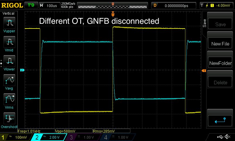

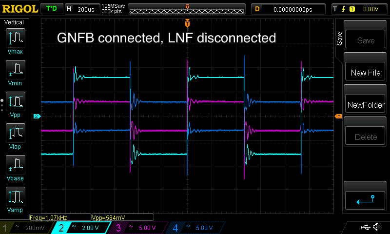

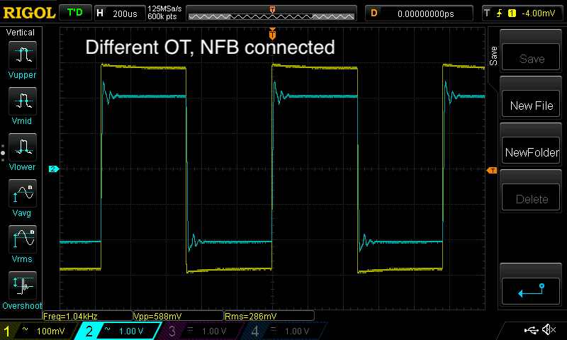

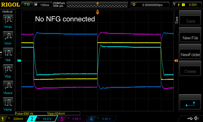

OK - been busy today. Had it on the kitchen table, disassembled. Findings:
  1. With no feedback connected, there is no ringing
  2. With only LNFB connected there is no ringing
  3. When applying GNFB the ringing appears

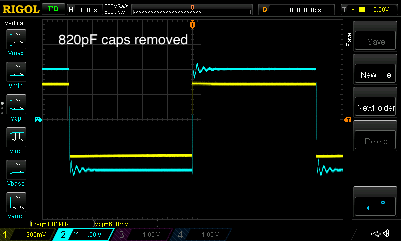

  4. Removing the 820p caps to ground in the LNFB loop makes no difference
  5. Using an entirely different OT shows the same behaviour (once I swapped the primaries)
If you still have a notch with all the NFB disconnected then the only thing with enough Q factor is the output transformer. Could be a shorted turn (but that's usually much more obvious).
1 above showed no ringing, and seemingly no notch as I went up in frequency.
I would start by swapping over the transformer primaries (with transformer NF disconnected) and see if the issue stays with the transformer.
5 suggests it's not the OT.

I'm tired, it's been a long day. Been thinking what the issue could be. Point 3 above seems to be key. Why would adding GNF increase ringing? Could the primaries be swapped? Is it something in the driver stage, ie where the FB is applied?
I've also realised I might have added the 820p caps back in ahead of returning the 220k feedback resistors - not sure if that means the 820p could still be an issue with the 2nd image below. Might re-do all the readings again in a more systematic manner.
