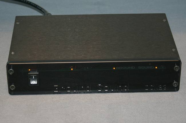

Offer: DCN23BOX – 115Vac version.
DCN23BOX product page
High performance Digital Crossover, EQ and Room Correction in a very nice ALU chassis toned acrylic front panel.
The product features 2 XLR balanced inputs and 3 singled-ended RCA outputs. The unit has 3 processing channels with 16 full-freely configurable biquads each. Free setup software
Only 4 pcs of this nice product is left – It can be yours for only 330 USD á piece including shipping with normal postal service to US or Canada. Please contact salg at groundsound dot com for more info and purchase.

I don't understand your outputs - a normal stereo bi-amp setup with electronic XO needs TWO outputs for each channel, (hi-pass & low). Yet yours are labeled 1,2,3+, 3-. Why is it labeled like that?? Are there 4 separate outputs that correspond to a standard setup or not?
Don't be confused...
There is 2 inputs and 3 outputs - "output 3" is both non-inverted (normal signal) and inverted. This makes it possible to drive the bass or whatever you connect to "output 3" in bridgemode if you want. It requires a stereo power amplifier that isn't already in bridged mode.
I don't see that I in any point claim that DCN23BOX is capable of stereo hi- & low-pass out. Where did you read that?
Bonus info: The DSP "onlY" holds 3 processing channels.
Best regards,
Robert GS
i didn't read that anywhere, it's simply a natural assumption to make, when it's described as digital XO/EQ/room correction. It seems to me one of the more basic features it should have.
So thanks for the explanation, and the realization that this is not suitable for my needs.
What do you mean? The DCN23 is suitable for one channel of a 3 way, and has all the basic features you'd expect and more.
If you want a stereo 2 way, you need the DCN24.
