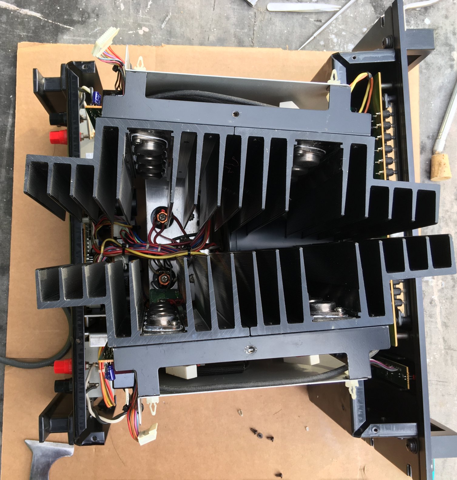

Well ya'll the amp arrived today and was packed well. Taking it out was difficult, it is heavy.
It looks very nice, not rode hard and put up wet.

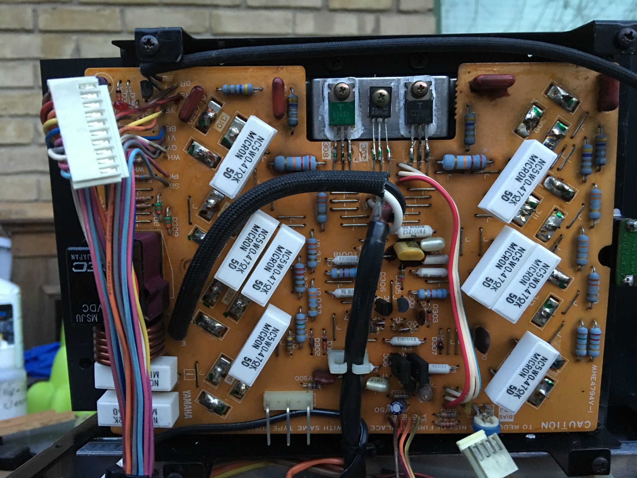

Then I opened it up and check out the all the parts. It was rode hard and the boards are covered in what ever it is thats there. Then it seeped into the heat sinks.
These are the pre amp and driver boards connected to the heat sinks.
The center board(s) I'll have to go look at it is even nastier. It looks like it had the panasonic ECQ capacitors but with the triangle logo (Matsushita or Mitsubishi). Those things are dark, dark, dark, and covered in what looks like sludge.
I can't recall ifs on that board in center, there is a cap board with what looks like the small panasonic snap in caps TS? But along with the sludge there is like black soot that is in there. I'm not sure which parts are good and which aren't.
We'll see how the boards sort out. I've got the left side out and that part of the channel disconnected. Some transistors out.
I could have swarn someone used arctic epoxy to affix them.
Two outputs came out easy, as the TO-3 screws were loose which kind of confirms that someone was in there and closed it back up, didn't want to fool with it.
Now I can see why.
I'm not even going to try and apply power to this until it is at least all cleaned up. With all that crap along everything and it melts down the board when it gets toasted.
The bottoms of all the boards have that layer of run goop on them. Woo Hoo, it's gonna be fun.

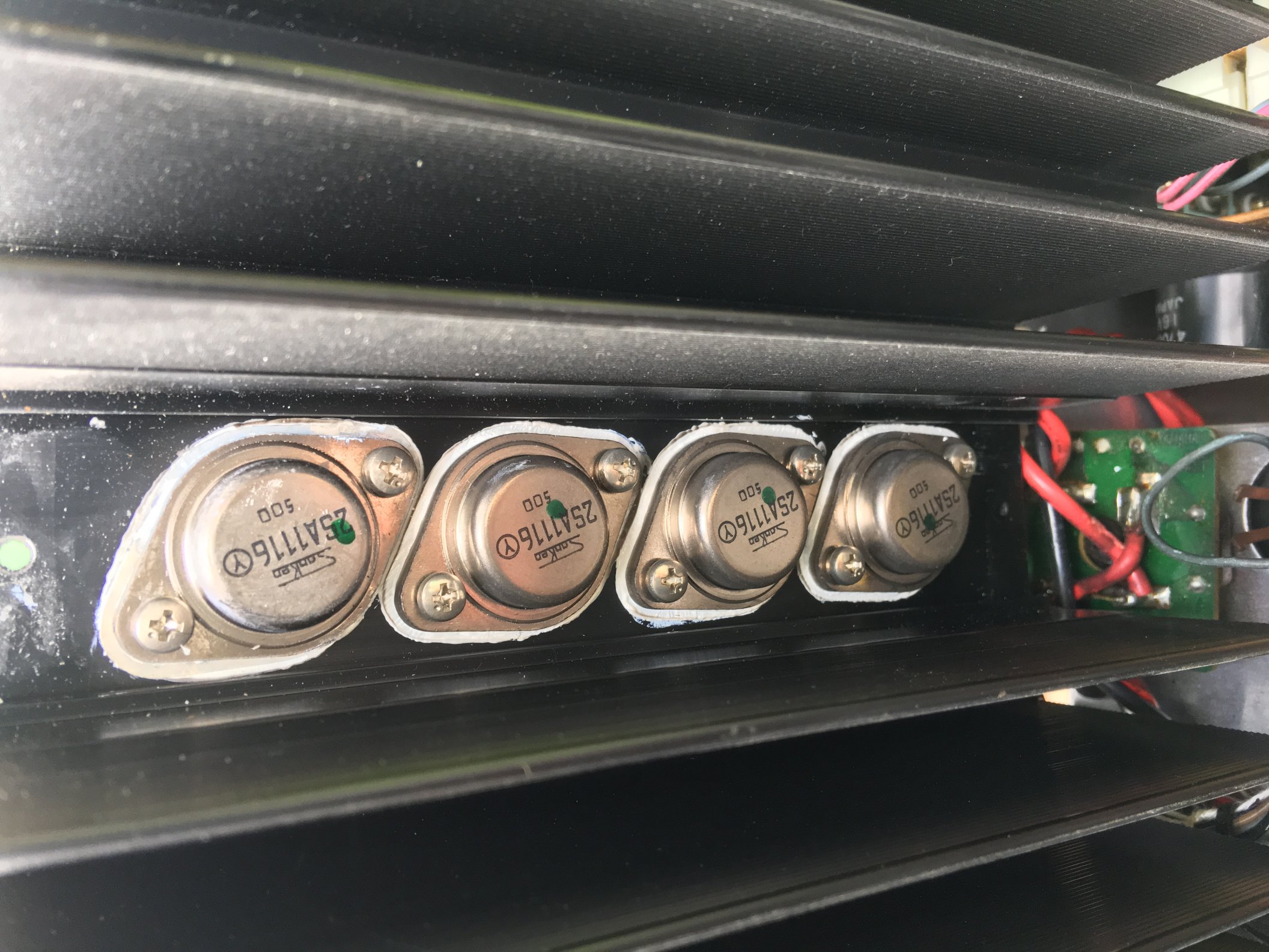

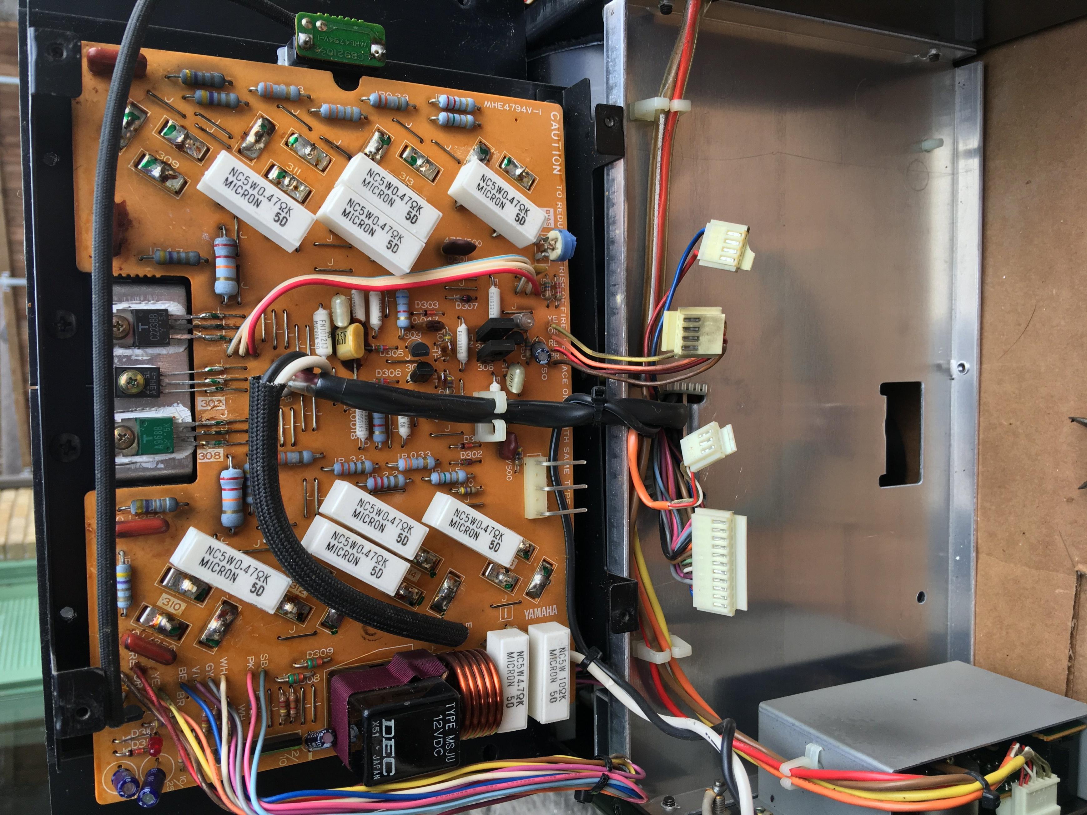

Here's some of the parts from the amp.

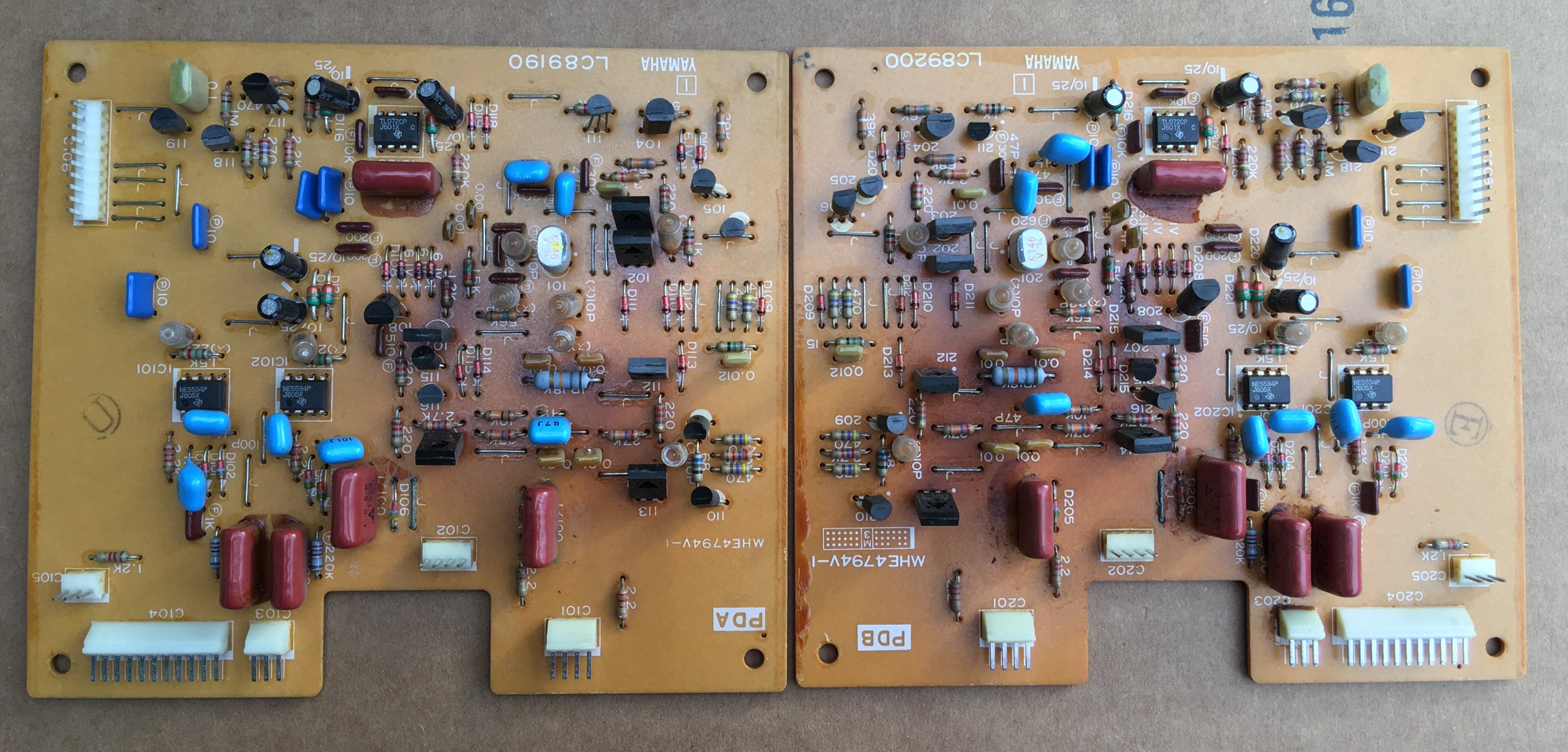

The boards look better then they are. It was over cast and the sun was going down. The board are covered in a this oozing sticky kinda something. It doesn't show up looking straight on. But, if the light hits it a certain way, that surface will look like the shimmer of the ocean or lake. That my friends is the dreaded oxen scheisse vee don't vont.
If you zoom in you can see some of it.
In the first pic zoom in in the lower left corner and look at the Film cap and look at the resistor adjacent to and below the three transistors. It got so hot it looks to have boiled through the cement layer.
Look at the resistor adjacent and just above. Little MEs suffering from heat stress. If there is any good to come out of this is note how the heat stress is UNIFORM along the resistor body--Yes.
Uniform thermal baking is preferred! Less distortion.
Warm at one end and hot at the other, is what we don't want. That leads to much higher distortion.
The plastic connectors just flake apart from being baked. Though I only lost one corner. I also broke two of the plastic snap on clamps that hold the outer board on to the heat sink. One corner connector just vaporized.
Enjoy,

Hi Sync,
Looks good aside from the coating you mentioned. So that's good news anyway.
Have you been able to measure any conductivity? The coating might be some kind of conformal coating. I'm thinking this because you mentioned that the board seems to be evenly covered. Of course, we don't want a conformal coating on these PCBs. To remove that, you need to use a solvent for that purpose. If you have to soak the PCB, you'll have to replace the capacitors and pots (remove them 1st) if they remained on the board.
I was just guessing as to what that coating could be. Capacitors don't generally leak that much and certainly wouldn't coat a PCB evenly.
-Chris

Look in the two board pic, the right board, labeled PDB you can see the contamination better. I think it's a combination of glue, electrolyte, and flux from wave soldering. Then what ever was left got mixed and migrated. The board are shown upside down. Look at some of the edges of the board and components.
It won't bring the amp out of protection with the goop. It is kind of sticky honey-esque.
The back side of the board were much worse, maybe it was left over flux remover? It's definitely not a conformal coating as I have a couple of other boards that have it and it doesn't look anything like these boards. Conformal coatings I've seen have a thick clear hard coating on both sides of the board.
Now, that doesn't mean there are lesser conformal coatings.
If I ever get the bench and sheves together again I could problaby find the boards and when I do, I'll include a pic.
Update, all 16 output transistors test good, all 6 driver transistors test good too.
One side has matched Vbe devises and are close gain grouping. This with a Peak Atlas DCA55 Transistor tester.
Okay back to work for me.
I'd build a higher voltage transistor tester for my TO-3 Devices but I can't find schematic or layout for it. I don't have access to a curve tracer either. Bummer that is.
Started removing parts. Ugly mess and time consuming. Look at the second pic in post#33. Then look at the bottom center of each board, the cap, diode jumper. Corroded through each board.
Then look at the first and last pics of post #33. IN the middle of the middle of the board, where the dark brown glue is all those parts are corroded. through the board.
It's hard getting the stuff off, and the silk screen goes with it, sadley. It doesn't want to melt off. But with ISO it starts to dissolve...and these are thick layers of crud, it take long time.
