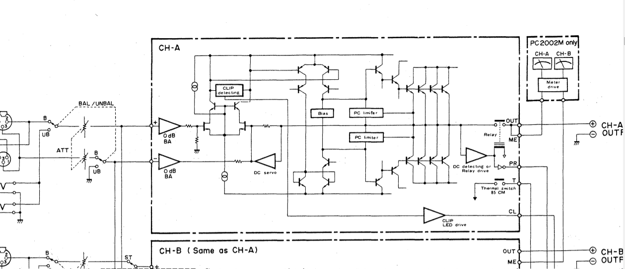

Well ya'll the amp arrived today and was packed well. Taking it out was difficult, it is heavy.
It looks very nice, not rode hard and put up wet.
Then I opened it up and check out the all the parts. It was rode hard and the boards are covered in what ever it is thats there. Then it seeped into the heat sinks.
These are the pre amp and driver boards connected to the heat sinks.
The center board(s) I'll have to go look at it is even nastier. It looks like it had the panasonic ECQ capacitors but with the triangle logo (Matsushita or Mitsubishi). Those things are dark, dark, dark, and covered in what looks like sludge.
I can't recall ifs on that board in center, there is a cap board with what looks like the small panasonic snap in caps TS? But along with the sludge there is like black soot that is in there. I'm not sure which parts are good and which aren't.
We'll see how the boards sort out. I've got the left side out and that part of the channel disconnected. Some transistors out.
I could have swarn someone used arctic epoxy to affix them.
Two outputs came out easy, as the TO-3 screws were loose which kind of confirms that someone was in there and closed it back up, didn't want to fool with it.
Now I can see why.
I'm not even going to try and apply power to this until it is at least all cleaned up. With all that crap along everything and it melts down the board when it gets toasted.
The bottoms of all the boards have that layer of run goop on them. Woo Hoo, it's gonna be fun.
Film at 11.

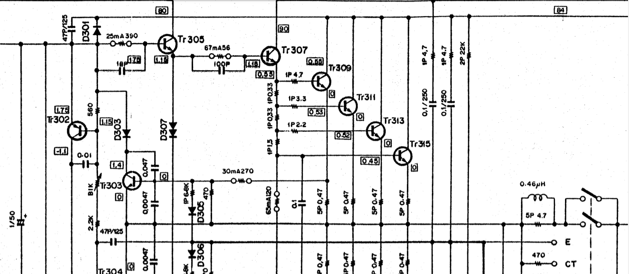

Update, all 16 output transistors test good, all 6 driver transistors test good too.
One side has matched Vbe devises and are close gain grouping. This with a Peak Atlas DCA55 Transistor tester.
Okay back to work for me.
I'd build a higher voltage transistor tester for my TO-3 Devices but I can't find schematic or layout for it. I don't have access to a curve tracer either. Bummer that is.
