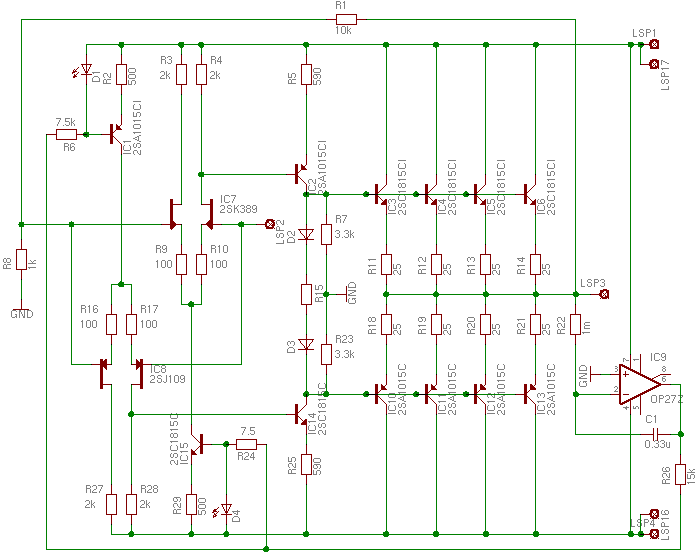

Hi all.
Kevin Gilmore has made a interesting DC-servo in his headphone amp. He is manipulating the current sources of the input stage. Very elegant!
powerpill.org
Kevin Gilmore:Servo loops MUST NOT be in the audio feedback loop. This rule is also very important. Two of my favorite high-end audio electronics manufacturers put servo loops into the minus input of their amplifiers. Most other manufacturers that use servo loops do the same thing. Opamps used for servo loops do not have an output impedance low enough to make them suitable for this purpose. Furthermore the dynamic output impedance of opamps adds non-linearities to the audio when put in series with the gain resistor on the minus input.
What is your opinion?
Regards
GEirin

Hi all.
powerpill.org
Regards
GEirin

Hi all.
The circuit I posted is the Kevin Gilmore amplifier, not mine. My intention is to know the opinion about this type of servo.

but he never proves for example how the opamp's dynamic output impedance adds non-linearities to the audio when put in series with the gain resistor on the minus input with actual measurements.
It's not hard to set up a more conventional type of servo that doesn't add anything significant to the audio signal, so I think it's a solution to a non-existent problem. But if the designer has measurements showing otherwise, that would be interesting to see. The link took me to a blank page...

It is a bunch of bull...
1. The DC feedbak will be in the "loop" no matter what, otherwise it doesn't work. Attaching it in some other point of the feedback loop doesn't change nothing.
2. The influence that it has on the loop is in DC and very low frequency range because the rectification and filtering. That puts the resultant low-pass filter frequency below 0.2-1Hz.
Can it be done better than with an OpAmp PI stage? Nope... you don't need a PID for fast loops. It is a basic PID controller loop and is not rocket science to understand it.
3. "OpAmps do not have an output impedance low enough ". To do what? To drive a 10-100kohm input??? Is he serious?
Yeah, it's in the loop, but not at an AC or feedback node, but a DC node. This is a fact, the conclusion(s) you want to draw from that are subject to many variables.
