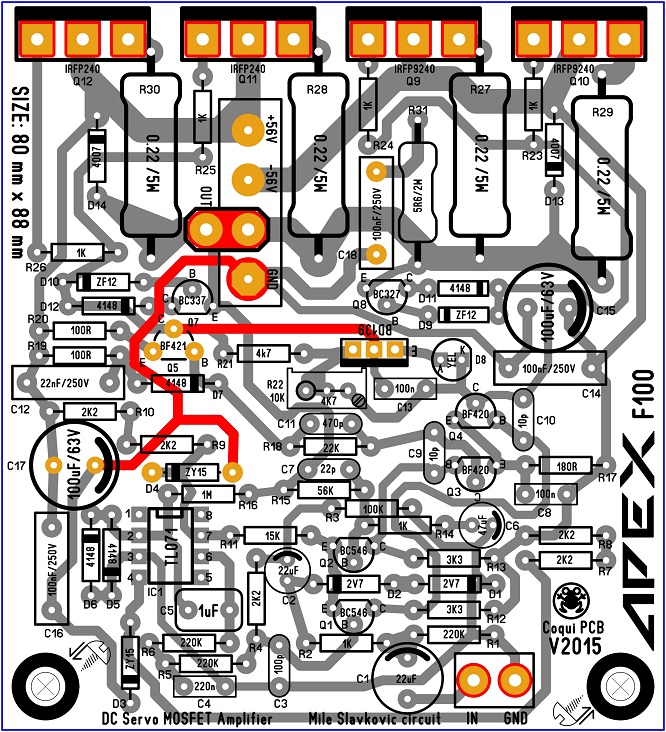

oh I see you modified the main connection with faston type really nice Terry 🙂

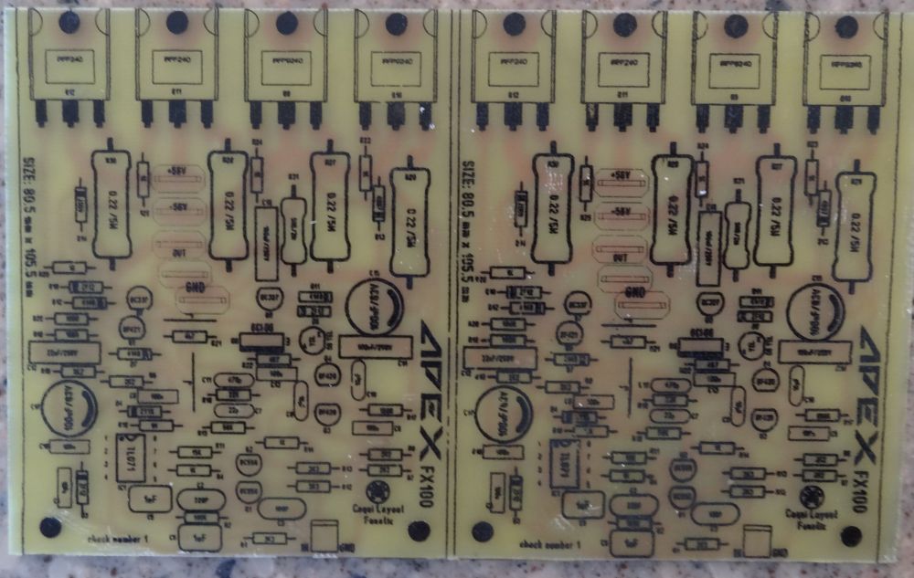

man if I was no so short in money I be ordering the updated PCB F100 I made a from the original files that mister Mile post #12 and I think is an awesome amplifier to have in my/your collections guys 🙂

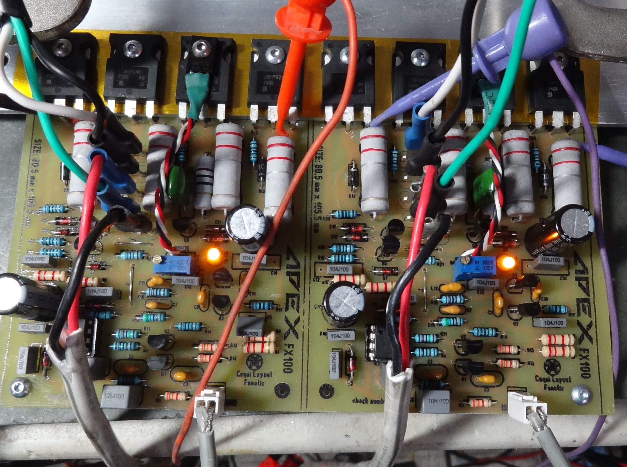

Well my parts came in so the FX100 is singing. Sounds lovely as expected. I had to set the bias up to at least 40mA to get rid of the crossover node. I installed a 5k pot in place of the 4k7 resistor and I think it is at about 2k5 right now. I had one issue when I hooked up both channels together for the first time I forgot to attach the left channel input and blew two outputs before the fuse blew. It doesn't like running with the input open. I replaced the outputs and all is good. I cheated a little and attached a jumper wire on the bottom of the board to attach signal ground to power ground so I didn't have to worry about running a separate wire to star right now. If the amp ever makes it to a case I will probably run it right. The amp is dead quiet.

Nice work, what about dc offset measurements?

0.5mV offset. There is a slight turn-on thump.

I got a chance to hook it up the the A/B setup. It is virtually indistinguishable from the VSSA. Very, very nice. It has higher gain than the VSSA. No need for a preamp at all.

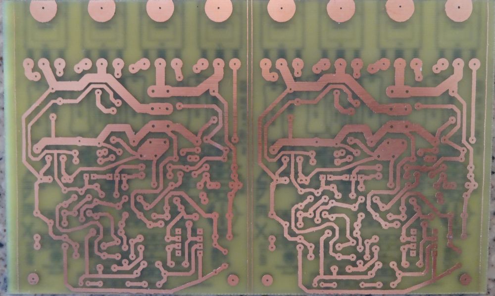

Very worth building. I'll post the etching files if anyone is interested.

FX100 no need preamp, only volume pot.

Yup, that was my finding. BTW, Mile, what rail voltage do you suggest is best. I'm using +-50vdc but have other options.

From +/-40vdc up to +/-60vdc. +/-50vdc is OK

I'm attaching the iron transfer pdf.

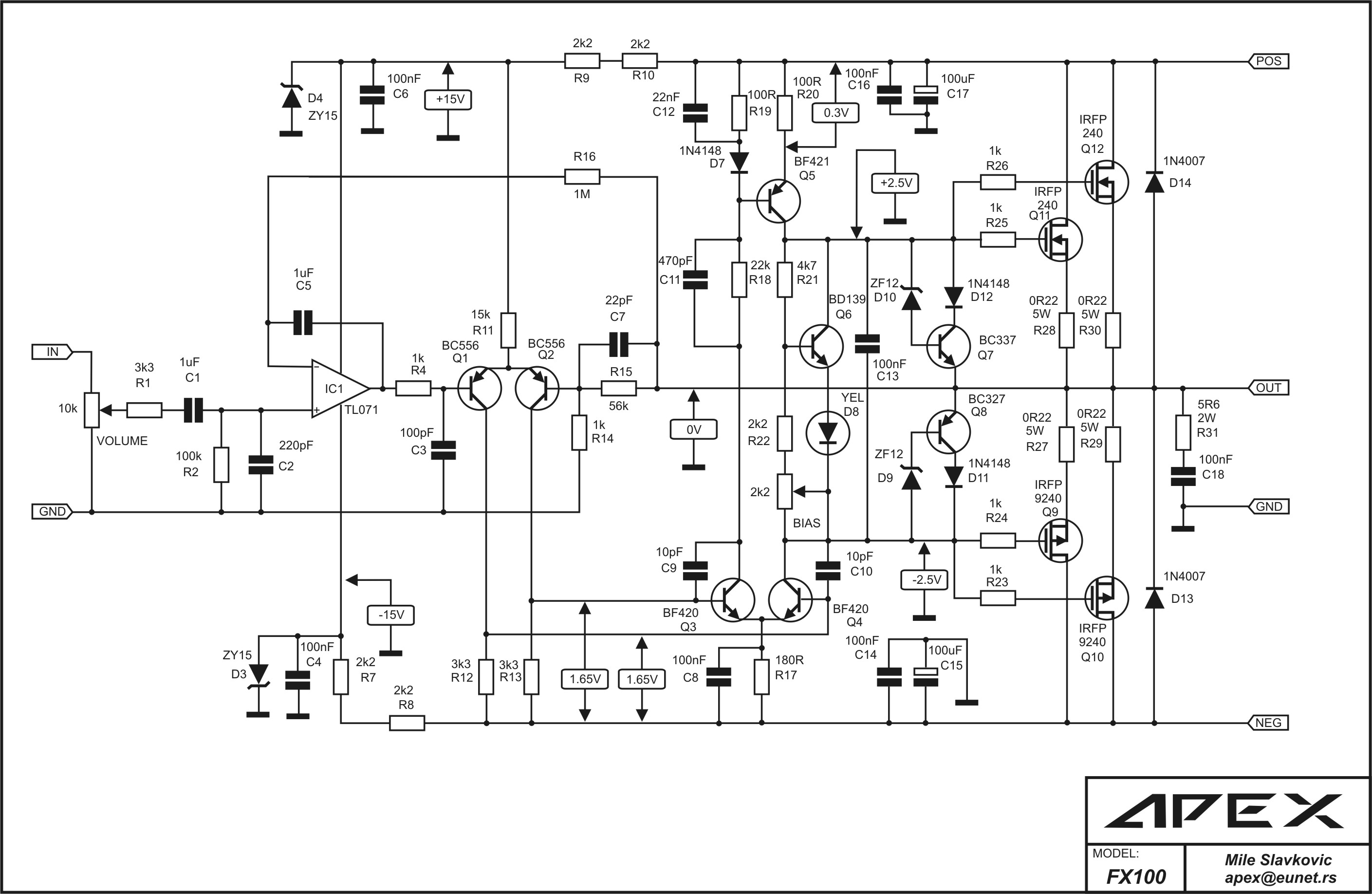

Q6 BD139 should be on a heatsink or attached on one of output stage transistor...
Yes, if you look in the picture in post #486 you will see that I fly it on wires and mount it on top of one of the outputs, ala SKA GB150.
i'm sorry, i haven't seen that picture - i downloaded pdf from few posts ago and than commented. i am browsing internet over my mobile lately, so i can not see much detailes from pictures in posts.
thank you both for the pcb/layout and checking schematic!
