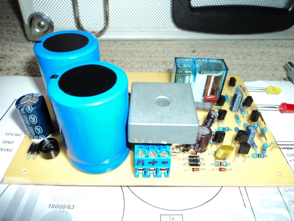

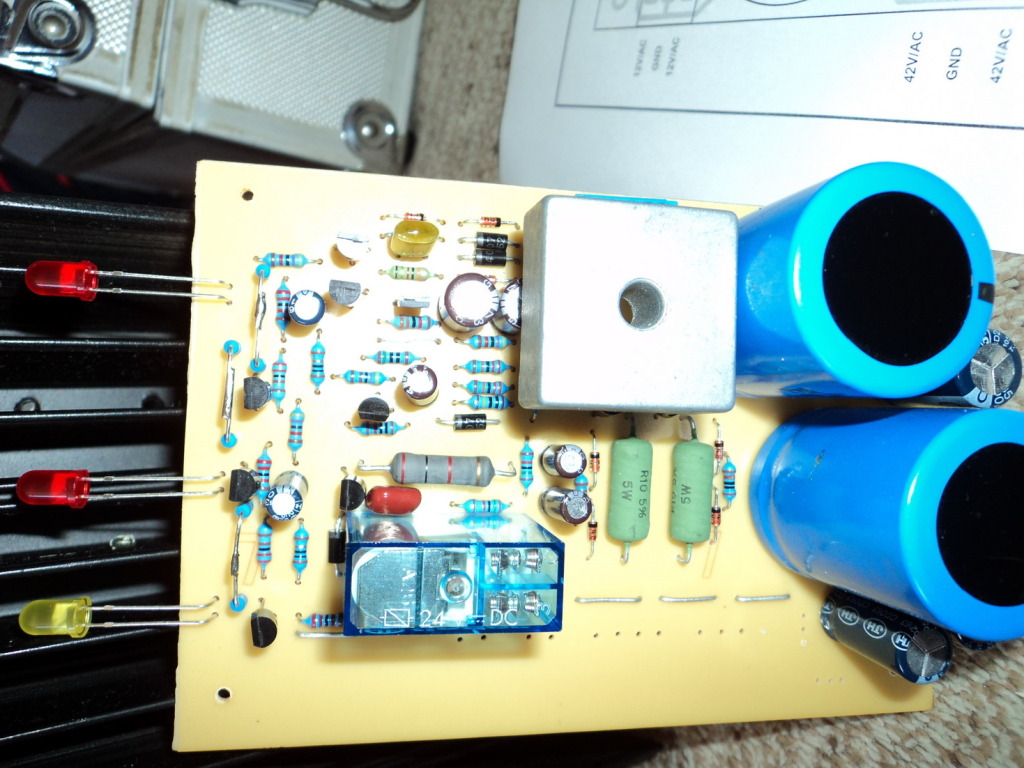

PSU with Protect... pictures from local forum.
