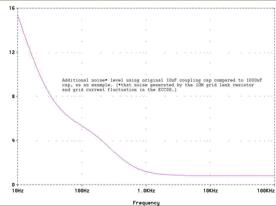

This discussion of grid leak bias recalls design considerations for low noise that I’ve seen in some professional tube audio equipment, and also in my own RIAA/MC head amp work experiments. Basically, coupling caps might increase noise if noise equivalent circuits are not also considered. I’ll present this issue here for what it’s generally worth, and not necessarily as a recommendation to change anything in the design being discussed.
The nice part about a very large grid leak bias resistor (the 10M grid resistor on the ECC88) is that it allows the use of a tiny coupling cap, here a 10nF, which can be of very high quality. The pole frequency is set to a reasonable 1.6Hz, even with only 10nF.
However, there is a risk of additional noise generated by the 10M resistor itself and also by grid current fluctuations acting on that 10M resistor to create additional noise voltages. The latter will be predominantly of the flicker or 1/f^n variety and is similar in principle to noise currents in an opamp. One hopes that the preceding components will provide a low enough source impedance at all audio frequencies to essentially “short out” these noise sources. But we need to test that assumption by looking backwards through the coupling cap. In this case the noise voltage must “see” through the small coupling cap before being attenuated by the preceding RIAA filter components. But the cap’s reactance is no longer small compared to the impedances that precede it in this backwards view, especially in the lower frequencies. So there will be some excess noise from the last stage when using a small coupling cap compared to using a larger coupling cap. I whipped up a quick sim of two cases of coupling cap size, 10nF and 1000nF (a big cap, I realize) using the relevant components in the RIAA filter discussed here. See the image below, which shows the DIFFERENCE between the two cases.
So, interestingly, in some cases you may actually want to use a larger coupling capacitor for noise considerations than you would just for adequate low frequency response.
The original cap choice here may well represent the optimal sonic trade-off because of the more nearly ideal behavior of the smaller value cap. There is also a reasonable charging time constant for setting the ECC88’s grid bias. There are too many variables to know for sure whether a larger coupling cap is worth it without actually trying both a small coupling cap and a larger one. In the most sensitive range of human hearing, there would be only a small difference. But if you notice an undue amount of rumble or woofer movement, it might worth experimenting with larger values.

Konnichiwa,
Which in the case of this phonostage (that is my own one, with ECC88 in gridleakbias) the dominant noise source is the ECC83.

Change the 10M gridleak resistor to 3M.

Thanks carawu, but may I ask you why you would change the gridleak resistor value from 10M to 3M? I always thought/supposed that the two circuits were meant to complement each other electrically....

There is a small time window...between ON and the valves drawing current...here your 160V caps can run into their limits. 250V is good, 400V is on the safe site. Please measure.
Not every ECC88 valve runs well in the riaa with 10M in this circuit...but with 3M there is minimal impact to riaa-curve and nearly every ECC88 performs well. Read the former pages, TL says this...AMEN. Else...try another ECC88
