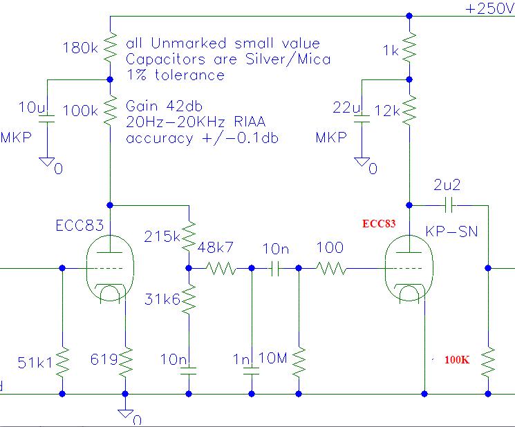

Can someone tell me if I'm correct that the anode load resistor is the 1000k from the schematic and the +B dropper is the 12k. I'm having some trouble finding a 12k resistor that's 9watts or higher. How critical is that exact value?Power rating, all resistors are fine as 0.5W excepting the Anode Load and +B dropper resistor for the Output Stage. They needs to be 3W & 9W minimum
Step up transformer for this phono preamp ?
Hi, I´m about to build this phono preamp, however I need to get at least two volts out of it (my main amp is 1.5 watts and my speakers are only 87db efficient, so I really need those 2 volts to get satisfying listening levels).
To get those 2 volts I was planning on using a 1:4 step up transformer. My amp has an input impedance of around 250k (baxandall tone control input (yes I like tone controls, so what 🙂) so, 250k/16 = 16k which, for what i've read here should be fine for this preamp.
I´m in argentina, the only kind of decent quality transformers I found here are the neutrik ones, but the only one which seems to fit the design is this one, which has been designed for MICs (Neutrik - Audio - Transformers - NTM4)
Another option, if the neutrik are not adequate, would be to contact lundahl and ask them to send me the right transformers.
My questions :
1- Would the neutrik 1:4 mic transformer be adequate for this design ?
2- If not, which do you think would be the most adequate lundahl transformer to get the 0,5v to 2v ?
Thank you very much for any help you can provide me.

What cartridge are you using?
You need a transformer that would be specified as 10K:80K, mu metal shielded. Not a lot of options, if any... I doubt most that you can actually get would be that good...
No.
Lundahl does not have any adequate item in their catalog.
For what you need you may get more mileage out of a 2nd stage with ECC83, use with 100K load and in griedleak bias. This should get you most of the way, with your high impedance amplifier input the 6DJ8 is not needed, if you can make sure the cable is low capacitance.
Ciao T

Hi, thanks for answering.
The turntable is a clearaudio concept with an output of around 3.5 mV.
About the mod to the circuit, you mean something like this ? I just replaced the 1m resistor for a 100k one and the ecc88 for an ecc83.
Should the other resistors remain the same ? and the 2u2 cap should remain this value ?

You mean something like this ? I just replaced the 1m for 100k and the ecc88 for ecc83.
The 12K on the Anode become 100K, the 1M stays as is, the 2.2uF can be a lower value, I would no go below 0.47uF.
