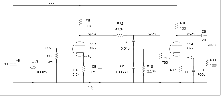

At first glance R 17 seems of.
I'd expect to see something like 1K there...
C9 1m ? Does that mean a 1000 µF?
Cheers,😉
Cheers,😉
Hi Frank
I find the schem in the net . I don't remember where .
I like it 'cause it hasn't a coupled cap btw the first and second stage !
And I expect too much gain from this phono with the 6SL7.
But as a newbie I'm not sure if it's a good project .
R17 seems of . For me maybe it's 10K.
At the G1 on the second triode we don't have 0V.It's dc coupled with the first stage.So the resistor at the cathode must be higher than 1K. What do you say?
C9 it's 1000uF.I don't thing there's a problem to put something lower or to leave it as it is.

The output impedance of this preamp will be extremely high.
You'll experience some loss of high frequencies if the output cable is anything more than a couple of feet long.
You might want to add a cathode follower stage to lower the output impedance.
Otherwise, the preamp looks pretty straight forward and should be a simple and fun project.
Happy soldering!

That's Bob Danielak's circuit :
http://www.geocities.com/bobdanielak/dc_phono.gif
The 100k is correct though 85k can be used to get more current through the stage but I wouldn't go any lower.
Brian.
Yep...I thought I'd seen it before somewhere...
However DC coupling a phono stage seems very attractive but...
Unfortunately neither vinylrecords, cartridges nor tonearms are perfect.
These all exhibit a resonance frquency in the 10 to 15 Hz region.
Even whith a flat as a pancake record these resonances are going to drain the PS of the phonostage heavily.
What's even worse it's going to amplify this across the entire stage.
On the bright site, one could build it, monitor it it for while and if what I suspect does cause trouble a highpass filter can easily be added.
Due to the high Zo a buffer or at the very least a low Zo line stage is recommended.
Cheers, 😉

So I can't avoid the 3rd stage.🙁
I don't want to use a line stage.I have an input volume at my amp.
Thanks Brian that you remember me Danielak's site.I went back and I see another phono stage with a cathode follower at the end.🙂
But with three stages.Is there any solution not to use a 3rd stage??
I think with an interstage transformer I can do it.But what is better ,a 3rd stage or a step down xformer?

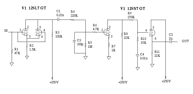

The other phono from Danielak is in the attached photo.

Well, in this case the RIAA correction is spread over two stages so the last one is a necessary evil.
Oh, and if you want a volumecontrol on this one as well the only place left is at the output...
Cheers,😉

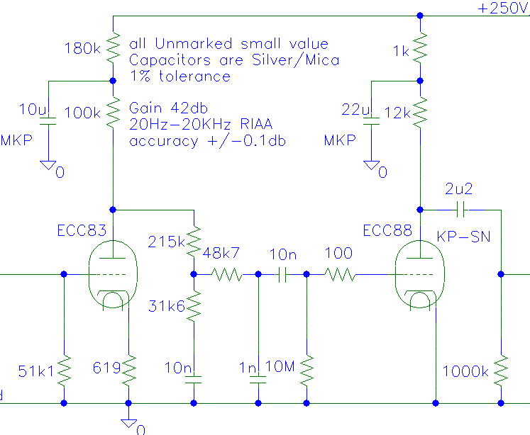

Konnichiwa,
Well, as you ask, do you really feel that having a low quality 100uF Cathode capacitor is preferable to haveing a high quality, small value capacitor (say 0.047uF) between the RIAA and the 750k Resistor, in sonic terms?
Even better, if you actually increase the gridleak resistor of the second stage sufficiently you could use an even smaller value capacitor and completely drop the cathode bias resistor.
Also, a 6SL7 as output valve, very high output impedance, very bad load tolerance. I would do a simple, 2 Stage Phonostage more like this....
Sayonara

the ECC88 has a 0 Volts bias. is it intentional?
No, it doesn't.
Look at the 10M gridleak resistor.
Cheers,😉

Konnichiwa,
Depends. In some ways ECC83 & ECC88 have complementary sonic traits, many modern and NOS options exist, it's just basically a nice and easy to get combo, especially considering that you need only one of each, so you can buy singles.....
The 7025 is listed as pin and electrical equivalent of the ECC83. If I write ECC83 I really mean any of the following:
12AX7, 12AX7R, CV10319, CV492, 12AX7A, 12AX7S, 12AX7WA, 5721, 5751, 5751WA, 6057, 6681, 6L13, 7025, 7382, 7494, 7729, B339, CK5751, CV3970, CV4004, CV4017, CV8156, CV8222, CV8312, E2164, E83CC, ECC803, ECC803S, ECC863, M8137, QB339
And when I write ECC88 I mean any of the following:
6922WA, CCA, CV10320, CV2492, CV2493, CV8065, E88CC, E88CC01, ECC868, 6DJ8, 6N23P, CV5358, ECC88, 7DJ8, CV10403, PCC88, UCC88, 6N1P, E188CC,7308, CV5231, CV5354, E288CC, 8223
Using the standard russian 6N23 (aka 6922) and the EHX 12AX7 makes for a nice sounding phonostage, using NOS Mullaed Box Anode CV4004 and Siemens 7308 sounds notably better of course.
Around 2500 Ohm, dependiong upon the ECC88 type valve used.
Yup.
Hmmm. It is hard to make a LP Pickup with > 30db channel separation. Sharing valves between channels will couple a little at high frequencies, but a lot less (at least 20db++ less) than any Pickup. I'd not loose much sleep. On the plus side, the halves within one valve envelope are usually assebled by the same person from the same tray of parts and hence chances are good for very close match, sonically and elecitically.
Because it's closer to the nominal 50K and because I like people asking "why do you use 51k1" instead of enquiring into the intricacies of the design.... ;-)
What about them? Implemented correctly and applied well they work okay, but I don't like to work so hard and prefer a much more KISS approach. Why use halve a dozend parts where one good one will do?

GAK said:My problem is that I read somewhere that ECC83 and ECC88 doesn't sound nice in a phono stage.
GAK said:Frank also avoid to use ECC at his phono stage and uses 7025.
GAK said:How much is the Zout ?
GAK said:Half valve for each channel right?
Yup.
GAK said:I was always wondering if this effects the separation of two channels (L-R).
GAK said:Why you are using 51K1 input R and not the classic 47K?
GAK said:One more question:what about SRPP, u-follower and Kimmel circuits?
Sayonara
Konnichiwa,
Actually, it has what is normally called Gridleak biasing. It is not ideal for Amplifier driver stages, but with stages working at a fairly low level this works fine.
The advantage of very small value coupling cap's and no cathode RC combo have too much a lure for me to resist. Sonically it works great, as evidenced also by Kurt Strains Phonostage (who converted his second stage to gridleak bias on my suggestion and gary Piumm's Phonostage who in turn took the gridleak bias from Kurt.
Reading them old valve books has many cool ideas rarely seen in modern commercial gear.
BTW, the first stage has an unbypassed Cathode resistor to stabilise the gain and output impedance (which impacts on the RIAA EQ accuracy) and also helps to reduce the classic "ECC83" sound a little.
For implementation, this was meant to be fed 250V from a simple, solid state regulated supply, All cap's in the main audio Circuit MKP (PSU) and Silver Mica, all resistors good quality metal film, PTFE Valve sockets should really be considered mandatory for a Phonostage.
Sayonara
fscarpa58 said:the ECC88 has a 0 Volts bias. is it intentional?
Sayonara

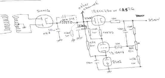

Any comments-suggestions for the following PSU?
Sorry for the bad quality of the schem.If there's any problem to understand it ,tell me to post a new one.
