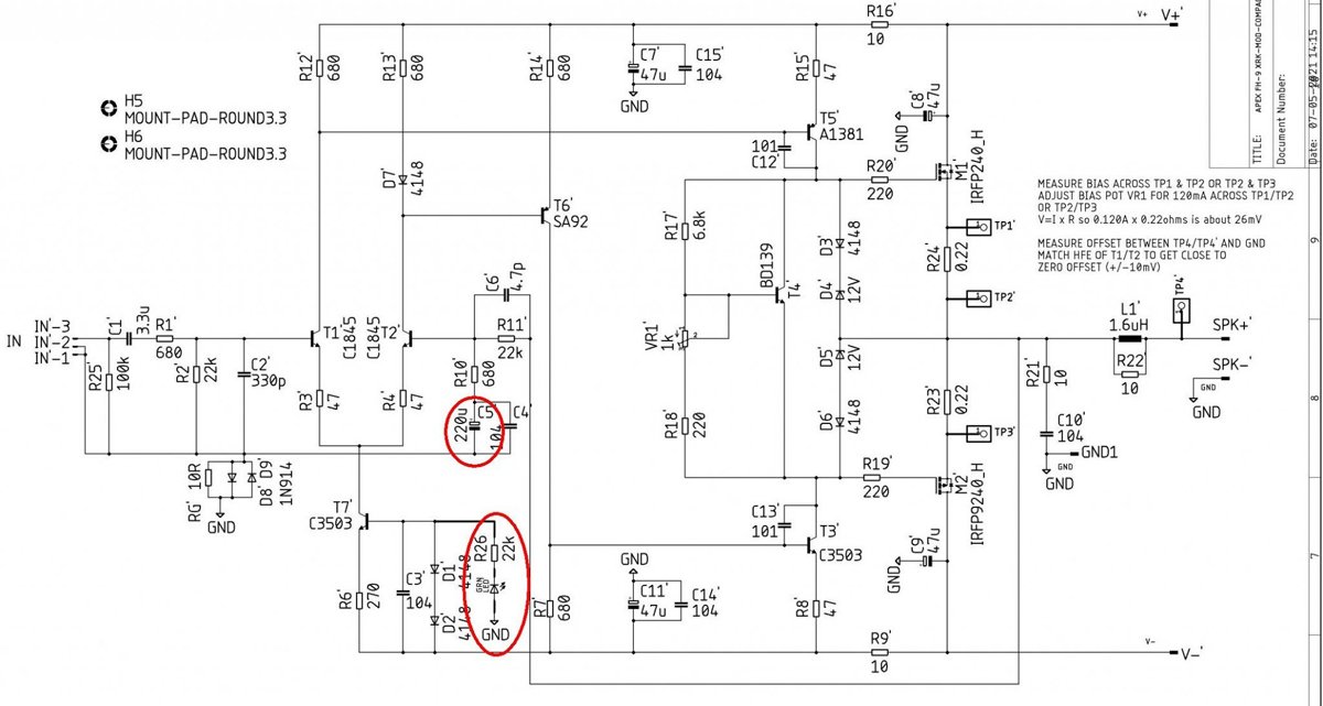

First i soldered out R5, 22k on one side, soldered a little wire on and soldered the end of R5 to dirty ground. No success....-20 mV offset
I see that the output is now negative with about -20 mV. I wonder why. The only change i made was to change the 47 ohm resistors, R3/R4 to 0,1 % and used new matched drivers. I could notice that 0,1 % resistors will lower the offset a little bit more. Soldered 1% again in. I odered MPR 0,1% resistors for all input resistors.
Second try with shorted RG, 10 ohm....very low offset, about -2,4 mV. But the output voltage is not stable, its floating a little bit, wents between -3 mv and 1,5 mV up and down. Is this normal ? I have no load at the output, input is shorted.

yes its normal. its the thermal issue in the amp...(bias Spreader T0-126, BD139)
keep that!

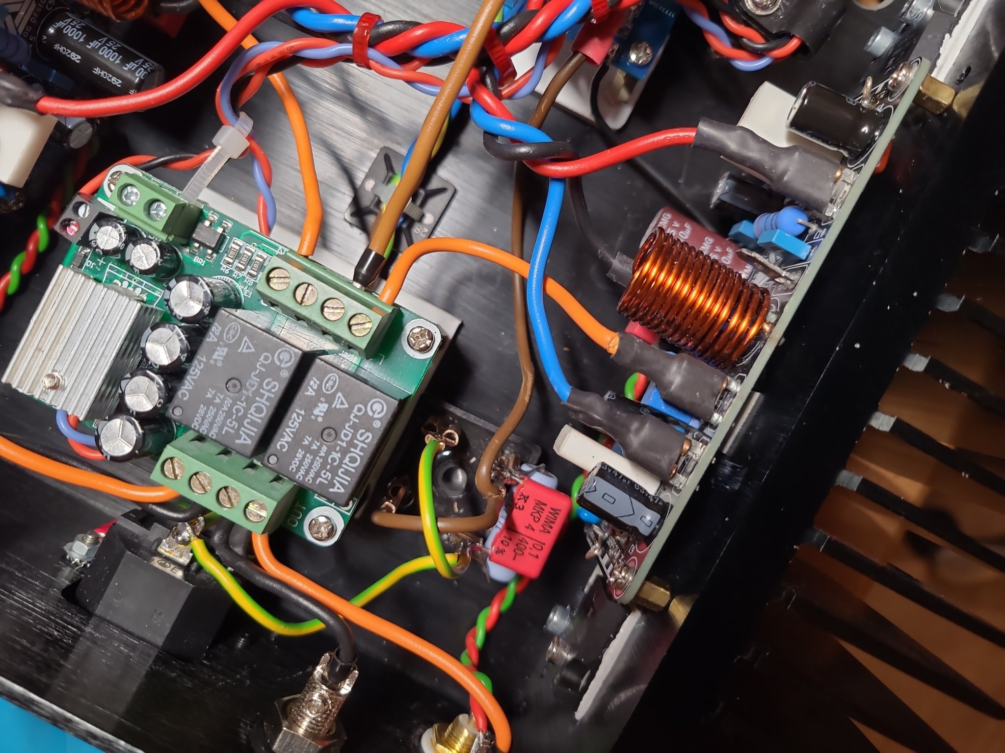

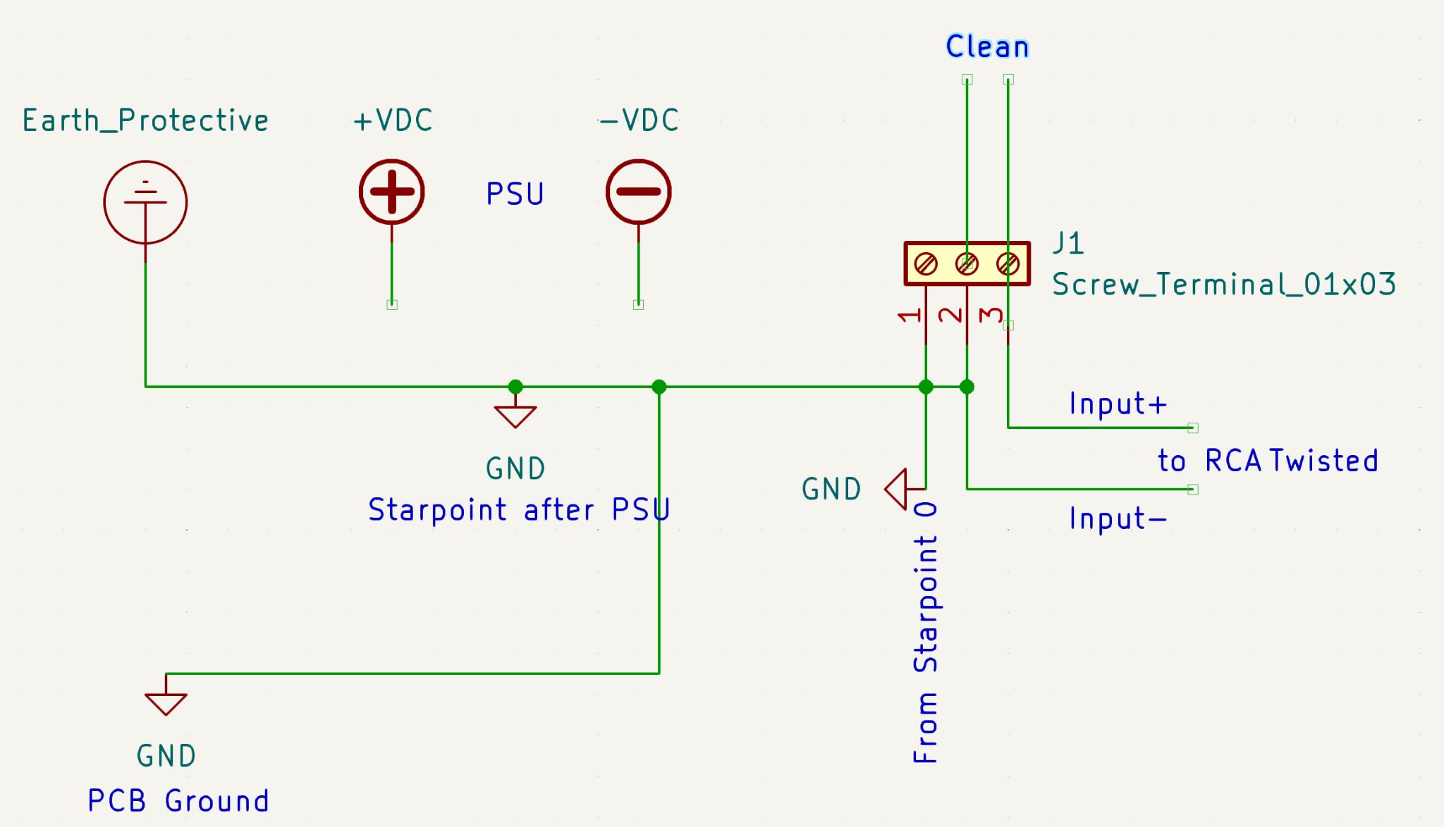

If i understand right, you set a starpoint near the psu output. One wire to the PCB ground, 0, and one wire to the signal ground, RCA and pcb input ?
Correct, but not exactly.
1 GND wire to dirty ground on the pcb.
1 GND wire to clean ground on the pcb.
RCA connectors are not grounded to the case. Twisted pair wires connect RCA to the PCB (using clean ground obviously).
I get better results (no hum!) using twisted pair wires rather than shielded cables.
Note twisted pair wires for inputs.
Arrow points to the 'clean ground' connection. Dirty ground is somewhere closer to the output.
All wires, including gnd, are soldered under the PCB.

'dirty ground' is 'output ground' where flowing currents are higher.
Everything except what mentioned below, should be connecting to dirty ground.
'clean ground' is ground with minimal currents, where only input LTP stuff is connected to.
Normally that would be only stuff connected to the BASES of the LTP
keyword 'dirty' means that currents flowing through that ground are higher, and fluctuating widely (e.g. from rail caps).
in your case, only C2, R2, C4, C5 should be connecting to the clean ground. And of course the input wires going to RCA jacks.

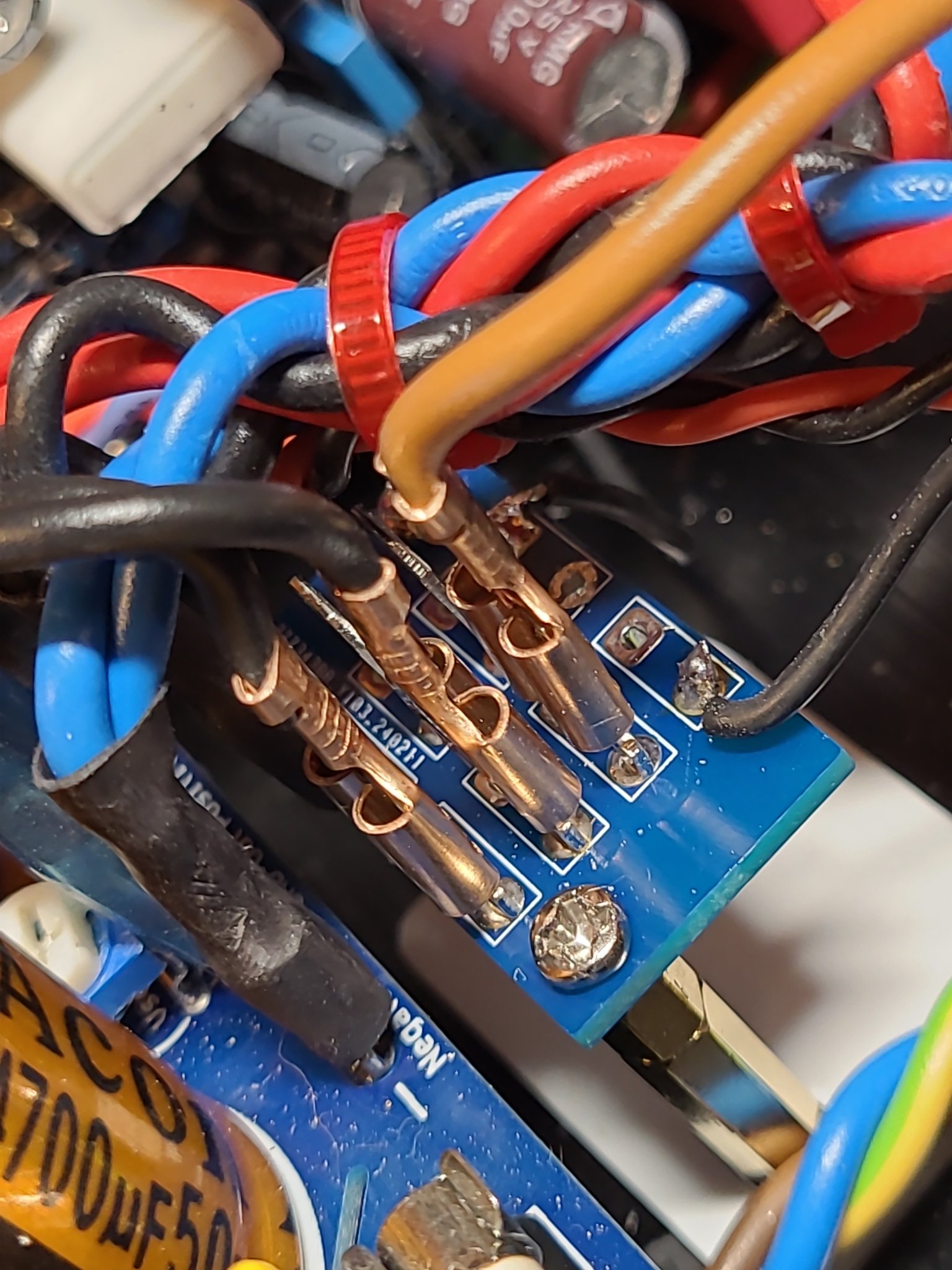

I had made little pcb's for a starground/starpoint. I will test your advice.
I can set the small pcb in front of the spms and connect all grounding wires with fast on, or solder wires on. Now i have understand what do mean with dirty and clean ground.... 🙂

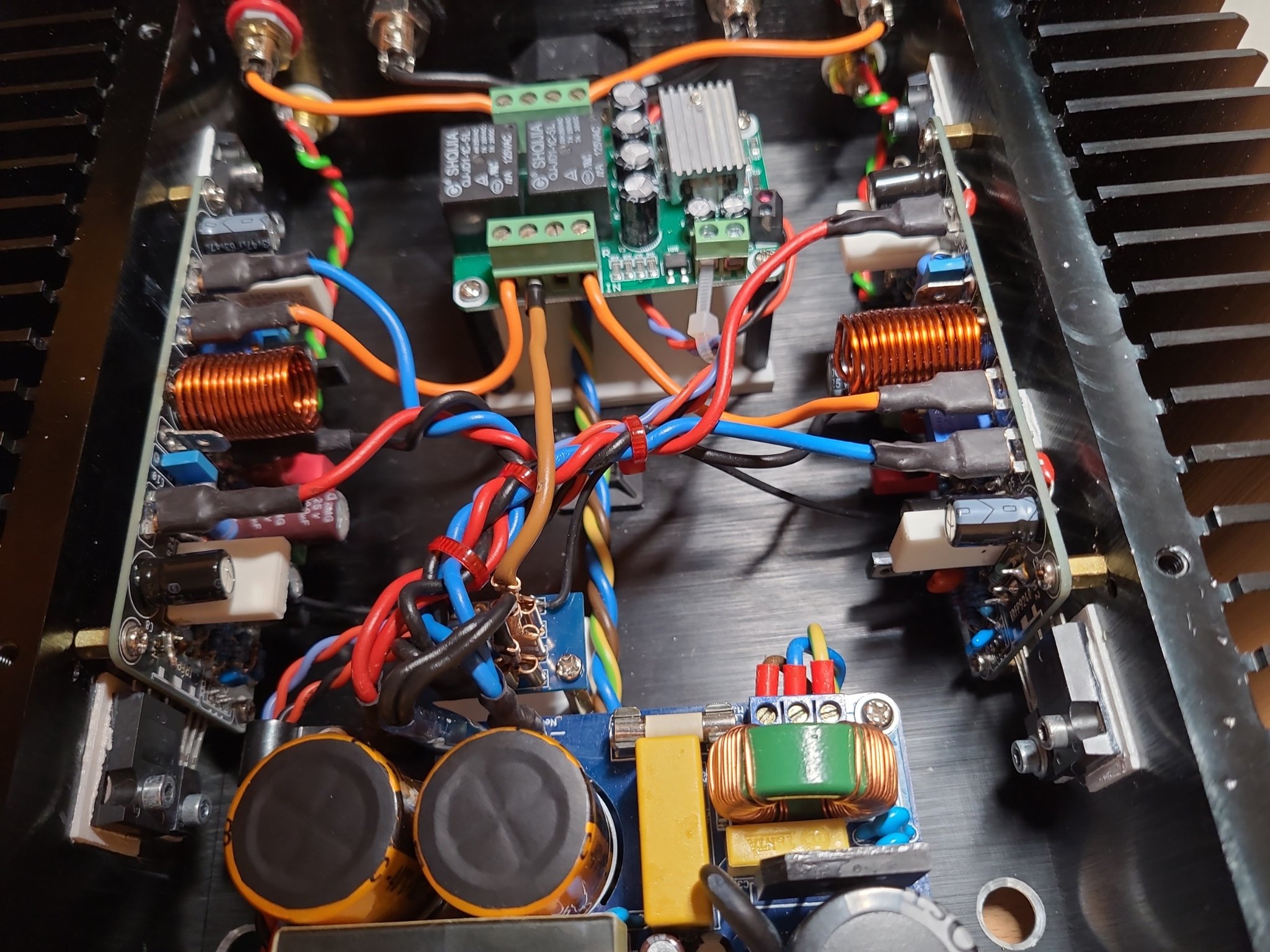

I was not lazy....builded a starground in the FH9. Clean and dirty ground have their own wires now, also speaker minus. RCA with twisted wires as you like it...there two wires from the smps to the little pcb. Only ground wires on it.
I need a 100 ohm resistor 3 watt and will connect the PE and ground with the resistor, not directly, or i use a loop breaker for PE as Elliot shows.

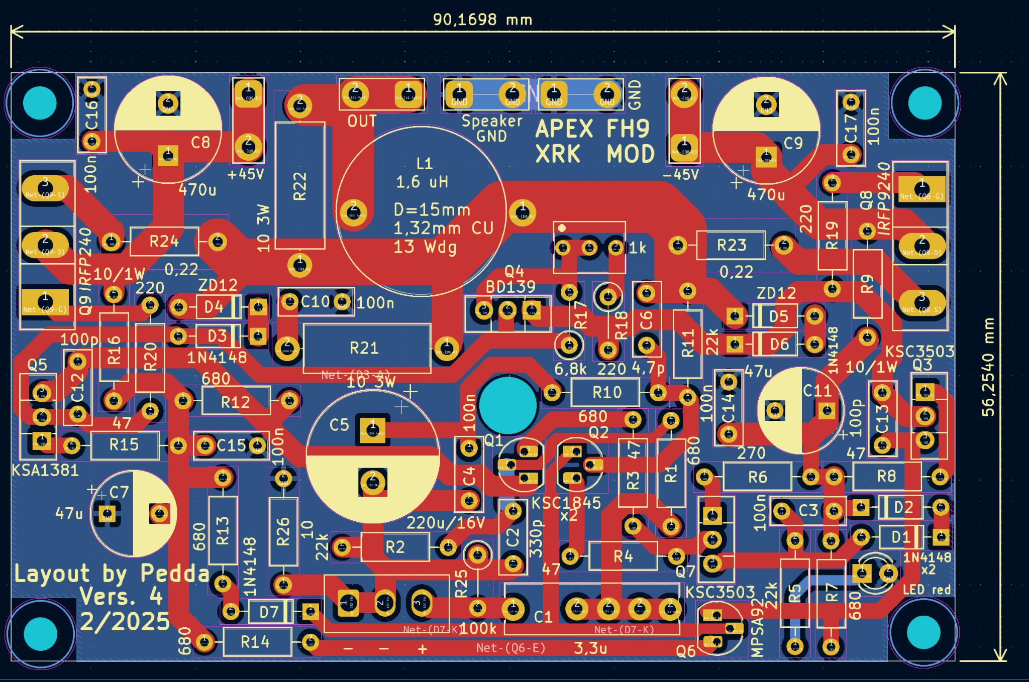

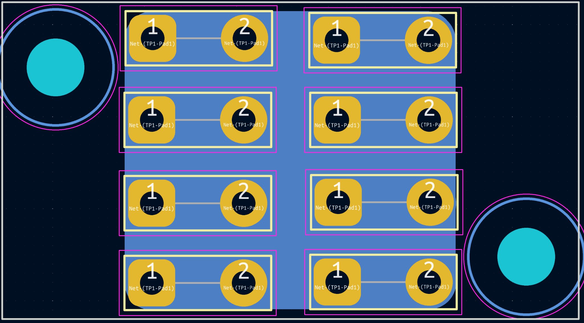

That is the reason for me to build one more with new pcb.
I have done a few little changes with KiCad and thinking now..its finished

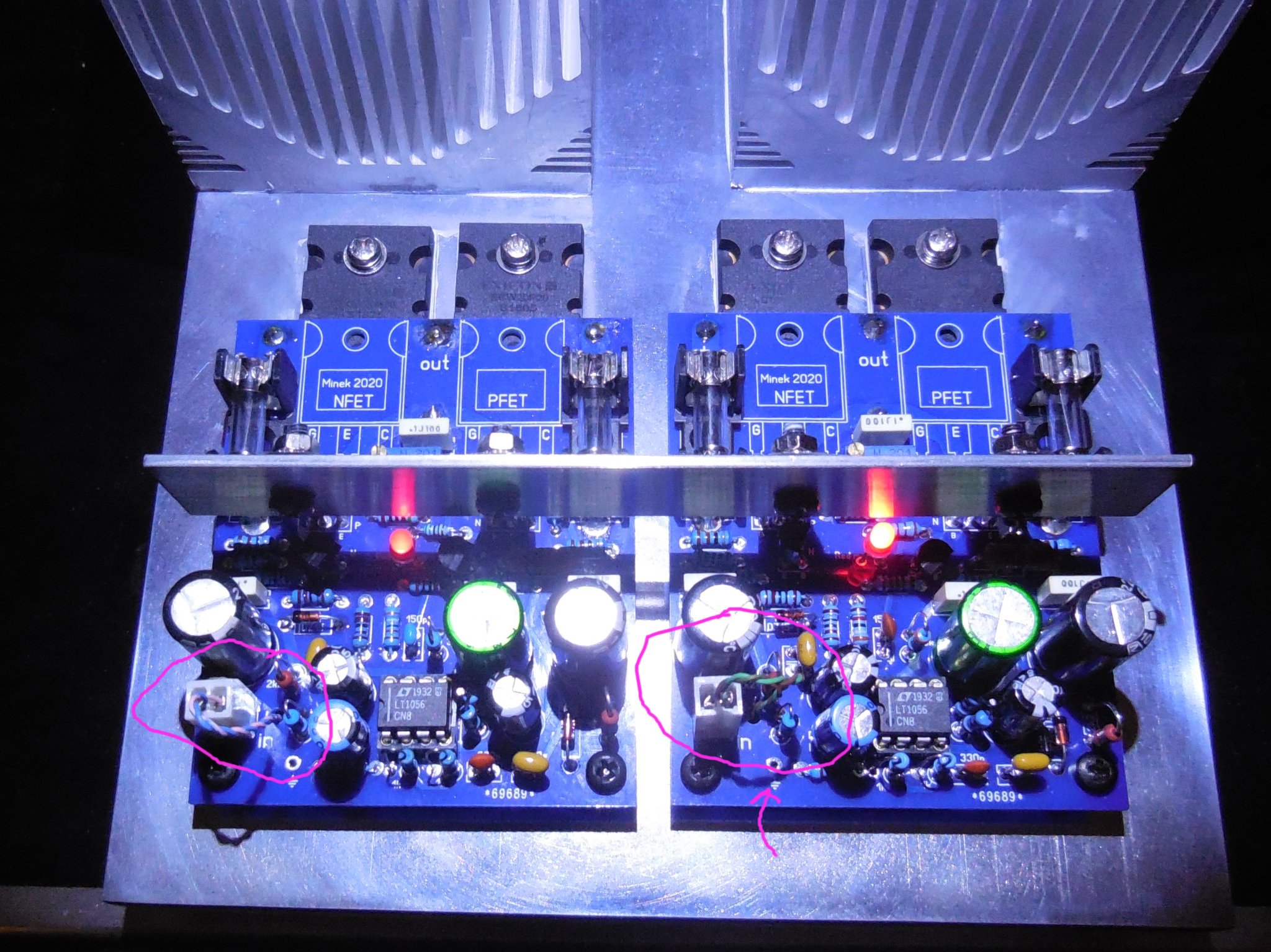

A new idea. One RG pin has connection to ground. I solder one led pin on. Take one pin of R5, 22k, out and with a short wire a make a connection to the second led pin. Thats what is shown in the second schematic, but the pcb doesn't fit the compnents, i need, right.
I can lower the feedback capacitor, perhaps i can use a NP type. Another test then....
