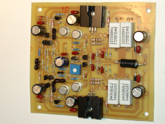

Alright guys, I guess I'll just fire it up and see what happens. (I hope not literally) It still seems strange to me that there would be such drastic differences between the two boards (which should be identical) but we'll see what happens.
BTW, I do have access to a variac so I hopefully can avoid any major problems. But I will definitely use the resistors instead of fuses. Are there any other suggestions as to what I should look for? (this is my first time doing this) Or just suggestions on this process in general that you guys have gained from experience? Do I just test the DC voltages on the boards themselves, or is there some other point I should look at?

wrl, since the driver seems to consume normal amount of power, apply nominal voltage (or at least minimum voltage), then you can make conclusions.
But first (iyou can), calculate all currents and voltages.
Assume 0.7 V Vbe and Hfe 300 for all small signal transistors and 100 for the driver transistors. With this simplification you can calculate almost everything.

Pics Pics Pics
Upon further inspection, I found no solder bridges or wrong parts. For all I can observe, the boards are identical.
The output was a clipped sign wave. The only reason I became suspicious was because the output to the other board was a "nonclipped" sign wave at the same voltage. And when I unbalanced the +- voltages, the output became "unclipped".
Here are the pics: The board with "ok" written on it is the working one.

Did you prep the boards like Leach specified in his instructions 1) and 2) at:
http://users.ece.gatech.edu/~mleach/lowtim/part2.html
under "Testing the Circuit Boards"?:
1) Temporarily tack solder two 100 ohm resistors to the back of each circuit board, one from the loudspeaker output to one side of R36 and the other from the loudspeaker output to the other side of R36.
2) Tack solder a short circuit jumper in parallel with C12.
3) Connect the positive, negative, and common outputs from a dual power supply to the board. Note that there are two circuit board grounds to which the power supply common must be connected, one is near the input and the other is near the output. The power supply output voltages should be set to zero and the current limits should be set to about 50 mA. If the power supply does not have a current limit function, connect a 100 ohm 1/4 watt resistor in series with the positive and negative power supply leads.
4) With a signal of about 1 V peak at 1000 Hz connected to the input and a dc coupled oscilloscope connected to the output, slowly turn up the power supply voltages. The circuit should amplify without drawing more current than about 25 mA when the power supply voltages are about 8 V dc or greater, not to exceed 60 V dc. The output signal will initially be a clipped sine wave until the power supply voltages are increased.
If you have more than 25ma, you probably have a building error and need to stop and find it. If the current draw is OK, raise the supply voltage while observing output waveform. As the voltage is raised the sine wave should get better until it pops in. If that doesn't happen, check harder for wiring errors. Check carefully for solder bridges across traces where they shouldn't be. They can be real difficult to detect, because they can look like real traces. Check carefully that you have your transistor leads oriented properly. These are real easy to screw up. I usually put an alligator clip on the transistor lead between the board and the case to draw heat away from the case while soldering the leads, to prevent burning up the transistor.
I think the first step is to raise the voltage and observe the current draw and sine wave. You haven't yet determined for sure whether or not you actually have a problem.
Also, check polarity of caps, and make sure you haven't switched PNPs for NPNs. Obvious, yes, but it happens. Check operating voltages at various points in your circuit, e.g., across zeners, the tail resistors in the input stage, etc., and all power supply traces. If you tacked the resistors in to test, make sure they are tacked properly, and not shorting anything out. If all else fails, try removing some of the protection transistors, to see if they are shorted and limiting.
My power supply doesn't provide more than +-20V, but at this voltage the amp didn't seem to be drawing any observable current. (just to be sure that the current meter on my PS isn't broken, is there a way I can measure this with an multimeter?)
I think that I might possibly have burned out a transistor while soldering them in because I felt them get pretty hot. To check for this I can just measure Vbe and Hfe for the transistors right?
