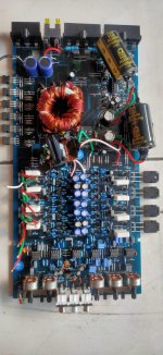

I know this is car amplifier, but beside the inverter it is a solid state.
Before i use tda2050 with 24v dc ct inverter in my car, no pcb i solder the resistor and caps straight to the pin as short as posibble. Sounds good, but it is hot and i think it have potential fire hazard.
So, i buy this cheap amplifier and replace most component with a better one. This is what i do:
1. Change all the 1/8w carbon resistor with 1/4w metal film.
2. Replace original capacitor to better capacitor. i use elna re3, silmic ii and panasonic fc. For smaller value i replace mylar with generic mkm and philips mkt. I replace mono ceramic with 2kv ceramic.
3. Replace the original jrc4458 with original ne5532 from ti. Yes, they got both input protected with transistor configured as diode.
4. Change supply for opamp from zener with lm7815 and 7915. I measure the voltage at +15.1v and -14.8v. I use two 220ohm 2wa resistor in parallel before the regulator.
5. Rewind the inverter toroid from 24v to 32v. Replace the original pair of 4700uf 35v capacitor with 10.000uf 50v+1000uf.
6. Add another gain stage before the amplifier with resistor divider at the input, i use ne5532 set around 9x gain. I use shielded cable around 10cm, i also ground the shielding wire. The total gain is around 2.5x. i do this because the source voltage output is to low, if i increase the volume i notice distortion using 50hz test tone.
7. Change the final transistor on the channel that i use for my woofer and tweeter. Before it was 2sc5198/a1941, i replace it with 2sc5200/a1943. It got 2 way passive crossover.
It works, no noise albeit a little muddy. Maybe because i use elna silmic which need some burn in period. And yes, i know it is improper using electrolite as input caps, but i like it. The original caps is generic eletrolite anyway, so it might be an improvement.
The problem is, i got 120mv dc offset on one ch. The other 3 was below 20mv measured. On this ch i use the original final transistor, it was the 2sc5198/a1941. I recheck all the resistor value, nothing wrong. I also resolder all the solder joint. The one thing i notice is 0.01v diffrence between the base of the 2sc5198/a1941.
Did i miss something? Do the 0.01v diffrence between the final transistor pair base is the problem or should i look somewhere?

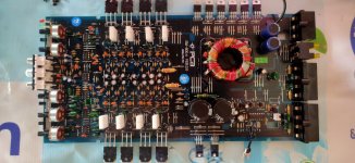

Here i attach the before and after pic. i add the gain stage later on and is not in the after pic, it was before hf filter on the amplifier input(it was 2.2k resistor with 100pf to ground, the input resistor is 10k):

It is hard to tell anything from your photos, what I would look for is where the offset starts, is one of the opamps perhaps? I do see the IC on left bottom not pushed in properly
Don't take this the wrong way but those improvements did nothing to improve anything.
Caps don't need to be burned in.
Do you see more DC offset on the output terminals of one op-amp than the other op-amp output terminals?

Sorry, forgot to tell that I notice it when i put the final transistor. Its already properly fix to position when i test it.It is hard to tell anything from your photos, what I would look for is where the offset starts, is one of the opamps perhaps? I do see the IC on left bottom not pushed in properly
Anyway the amplifier input was from the second opamp from the left and third opamp from the right.
I pull 2.2k and 2k resistor from the second(from the left) opamp output feed it to another ne5532 on separate board and put the resistor back at its output. It goes to the two amplifier i the left (the two without final transistor in the pic), before 100pf cap and 10k input resistor to ground.
For the other two i pull two 1k resistor from the third opamp from the right, feed it to another ne5532 in separate board and put the 1k resistor back at the opamp output. Then it goes to 100pf and 10k input resistor to ground.

Listen, I have to agree fully with Perry on this. There are things you can do to improve quality but not what you have done so far.
Those main filters need to be soldered in place like the originals. If they don't fit, drop the capacitance until they do. You can't use parts that don't fit. By hanging them on leads you have created issues you didn't have before. Lose the darned sockets! They increase capacitance between the leads for one.
Did you check for oscillation on the outputs? Meters can respond in odd ways to RF signals, or it the RF is distorted it will be an effective DC offset, but not for the reasons you think. So, you absolutely do need an oscilloscope here. You also really need a THD meter, or better yet an audio analyzer. Disagree or not, but there are very good reasons why we purchase and use this expensive equipment. Wouldn't be great if we just had to use our professional, tuned hearing ('cause we do this for a living)?
One thing about testing listening to music. People make terrible test instruments! Very unreliable. Very susceptible to whatever is in their head and cues from others in the area.

The 4558 is an improved 741 type op amp, BJT diff pair. Same as the 5532A. The 5532 is a vastly better part, not just an improved 4558 or 741 type.
You need to examine what is going on using an oscilloscope. Trial and error is not the answer.

So, with a borrowed meter from a friend. I found 3mv on the third opamp from the right, it is on pin 5. My meter only read 1mv. Then i soldered two 100nf ceramic cap from pin 4 and 8 to ground patch in the middle op the opamp. Dc still there. I then replace the opamp with jrc4558, got no dc. I got 17mv on the speaker terminal.
Do i got defective chip or is it the resistor capacitor combination on the input?
I notice that the second opamp from the left, left side configured as non inverting with gain of 10 with 3k and 27k resistor. The right side configured as inverting with 15k and 150k resistor also at gain of 10. Why they do that? Is it posible that inverting/non inverting configuration affect stability of the opamp?

Hold on now!
Listen to what I said earlier. If something is oscillating and has distorted output, you will see an effective DC offset. However meters all respond differently to this, so you know nothing yet. You absolutely do require the use of an oscilloscope to see what is going on. You can't even begin to troubleshoot without knowing what is going on.
So, stop. Figure out who can help you probe various points to see what output you actually do have. You need the use of an oscilloscope, this is why they make this instrument and why it is a very basic piece of test gear on every service bench for electronics.

Hi. Had possibility to repair something similar , a cheap car amplifier , 4 ch , had large dc offsets too , and output amplifiers were ok . Problem was tl074 if i remember correctly, had random high dc offsets at outputs. Final amplifiers had direct input connection from diff stage to tl074 , no ac coupling capacitors, but feedback had electrolytic cap. So a 0,7v dc from opamp had transferred to spkr terminal as 0,7v. Problem solved by replacing all the ic's . Audio ic mostly are not low offset ones, so its normal to see a several millivolts at their output with dual supply .Try to excahge ic's, they are in sockets anyway , and see how dc offset changes at spkr terminals , maybe you have similar issue.
I do not have dc offset problem anymore with either jrc4558 or opa2604. I even connect a small speaker, its working nothing abnormal, even the magnet is cold to touch. But, I think I do not need 4ch, 2.1 would be better suited for my speaker configuration.
