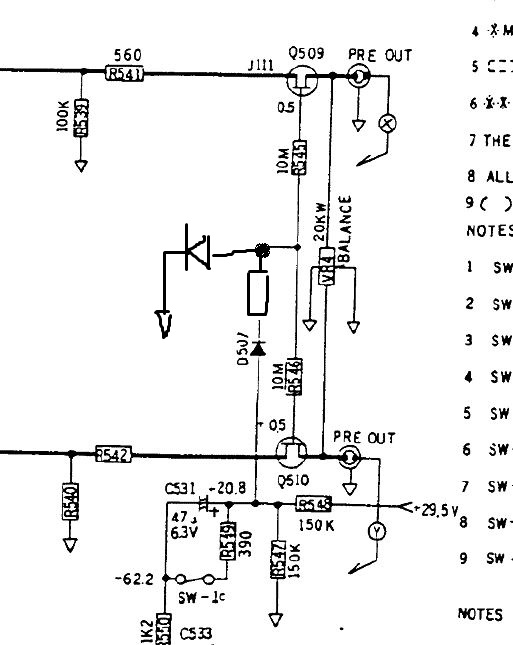

Those readings are odd. How is the gate of the FET at 19.8 volts if point E is only 0.598V? It should only be at 0.5V.

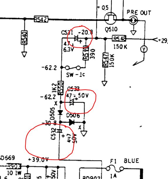

Check if the minus 62 volts is present here. The two lower caps could be suspects.
I'm wondering if the voltage readings are true or whether there could be an AC component to them that a meter can't show.
A high positive peak voltage (that a meter can't resolve but an oscilloscope would) could conceivably drive enough current through the 10Meg and 100k to create a significant offset.

We'll pick up from this point:
There are a couple of totally different possibilities for what is happening so lets explore each.
We have to go back to the basic theory of how the FET operates and what it does. The FET turns on when the gate is brought toward zero volts. That allows the FET to conduct and pass the audio. It operates as a simple on/off switch. That is the normal condition when the amp is on.
When the gate is taken negative, the FET turns off and mutes the audio.
So far so good. If the gate is taken to far positive then the gate channel of the FET will conduct and allow gate current to flow (which we don't want). That current allows the offset voltage to appear. So the gate needs to operate within strict limits. No more than around 0.3 volts positive (so the FET doesn't allow DC current to flow and cause an offset).
1/ The 19 volts you measure on the gate of the FET is a problem. So much so that I wonder if you have reversed points D and E in the measurement. If that has occured then we might be some way to explaining the odd results.
19 volts could allow a significant offset to develop as that voltage is high enough to force enough current through the 10 Meg resistor, through the FET and onto the output line.
That theory only holds good if you have points D and E mixed and so we need to prove that.
Leaving the FET's removed can you now remove the diode D507 (just lift one end of it).
Now check the DC voltage on the two 10meg resistors. They should be floating and have no real voltage present apart from stray pickup. Measure on both ends of each and be sure.
Now measure the DC voltage at the point where the diagram shows -20.8 volts which just below Q510 on the diagram.
I'm guessing that point will in fact read plus 19 volts or so. Can you confirm that is so ?

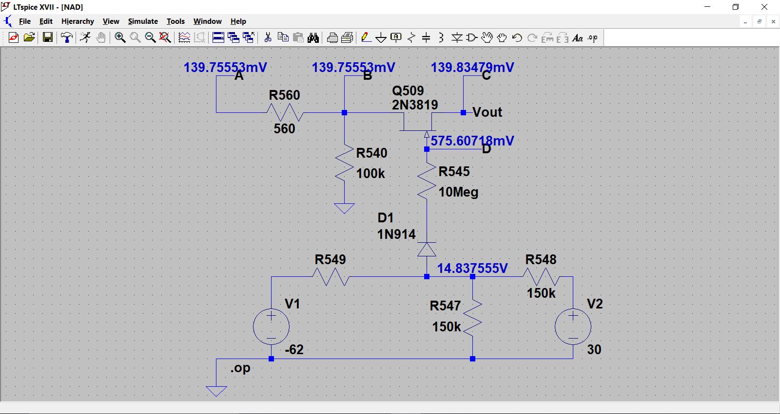

The more I look and the more it seems normal.
Resistive divider R547 and R548 generate a relatively high gate voltage at their junction. In theory that should be one half the applied voltage... maybe your 29 volts is a little high.
So we have around 15 volts generated, and that is applied to the FET's via the 10Meg.
Very approximately... 19 volts across 10 meg generates a current of 0.0000019 Amps. That current flows in the 100k R539 and develops a voltage of 0.0000019 * 100,000 which is 190 mv. You mentioned 200mv in post #1
The numbers are a good fit.
This is going to be normal behaviour I think.
The negative rail (the -62) is applied is applied only at switch on (that auxiliary contact on the switch) and once that opens the negative rail is effectively out of circuit as cap C531 will not affect the DC conditions.

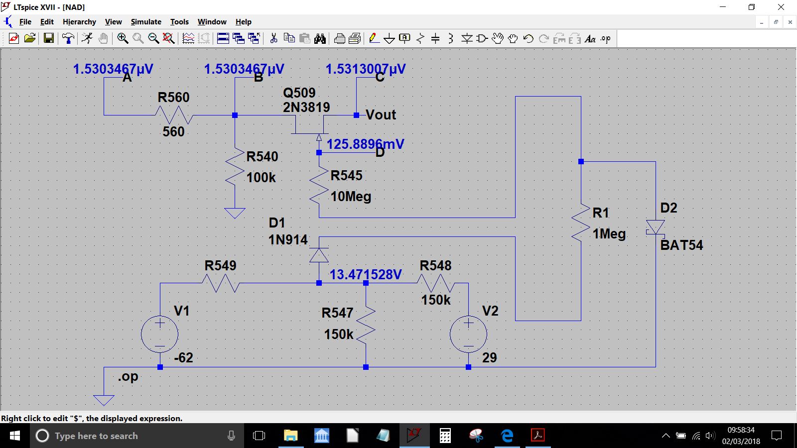

I think this might work as a possible fix.
If you add a high value resistor such as a 1Meg as shown here, and a diode clamp to limit the positive voltage to no more than 0.6 volts then that would limit the gate voltage.
Ideally the diode needs to be a germanium type that has a low forward voltage of around 0.2 volts. If that isn't available then try a small signal silicon, preferably a Shottky type.
The other option is to further AC couple the output with another cap.
This is a working simulation showing the original and then the modified.

No problem - I just checked your modification as well, using a 1Meg + 1N4148. The +182mV & +198mV I had last night, are now ca. 1.8 - 2.0mV when they settle down.

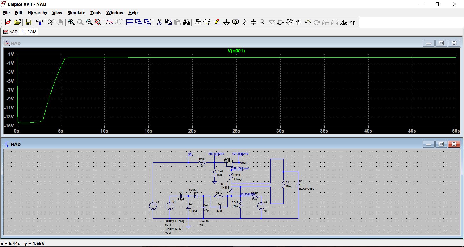

So...
The switch appears to be used to discharge the cap C531 so that the circuit always functions correctly at power on.

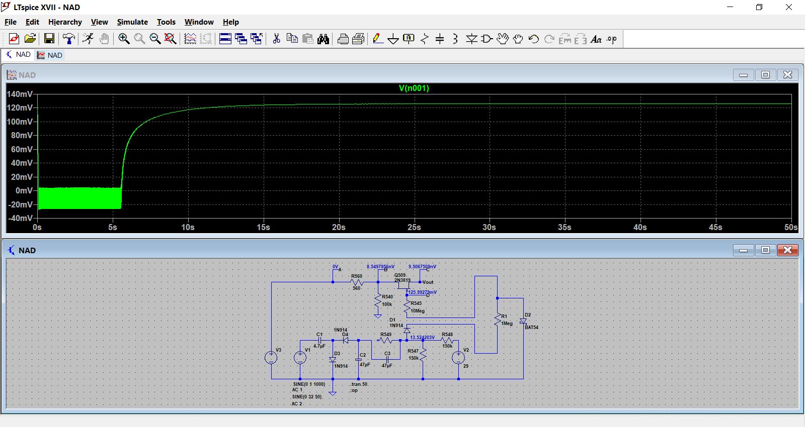

One problem with simulation is that leakage currents in semiconductors aren't always modelled accurately. The original circuit seems to rely on leakage in D507 to 'pass' the negative voltage onto the FET gates. If you look, it is reverse biased and so in theory should not allow the gate to be pulled negative... but it does in both reality and in simulation.

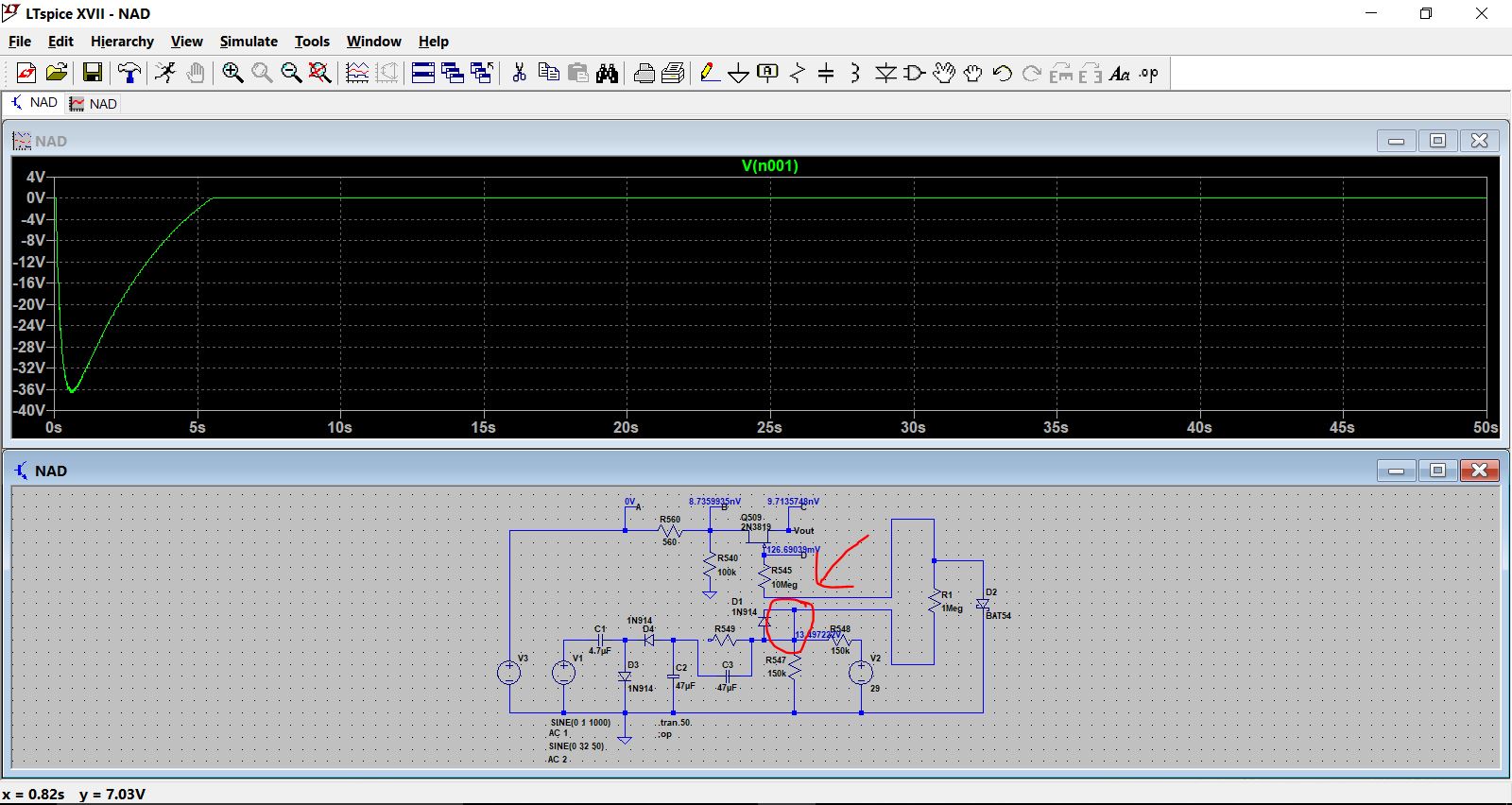

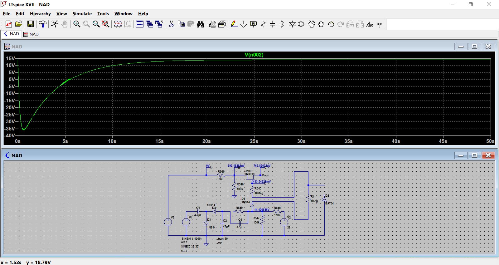

Here is the sim with a real AC voltage source to derive all the voltage. With the circuit in standard form the gate is held negative and then rise positive to unmute.
First image is gate voltage on cathode of D1 in the sim. My mod is out of circuit here. This shows the problem of the unclamped gate voltage that is the cause of the offset.
Second image is with the added diode and measuring on the added diode anode. It would seem the gate is not now being pulled negative, presumably due to leakage currents sapping the voltage. The new diode is reverse biased but still pulls the negative voltage down. It does clamp as intended though at around 130mv (shottky diode).
Image 3. Shorting the original D507 out allows the negative voltage to develop. Hmmm ! Should we deliberately make it more leaky with a resistor ?

Its what I would call a bit of 'fringy' design in that it is to reliant on using devices in ways that we wouldn't normally use them.
I had another idea.. and that was to replace my additional diode with a zener instead. That would limit the negative voltage to the zener value.
