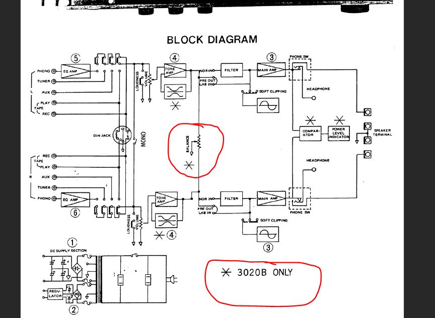

Agree completely on the early NADs, I started with a 3020, and still use one often - they're great little amps to learn on, and develop the hands-on skills.
I normally use a completely rebuilt early model, with added protection relays / muting (ESP P33 board). It is a tight fit, but works very well. I also swapped the grease for silicone pads.

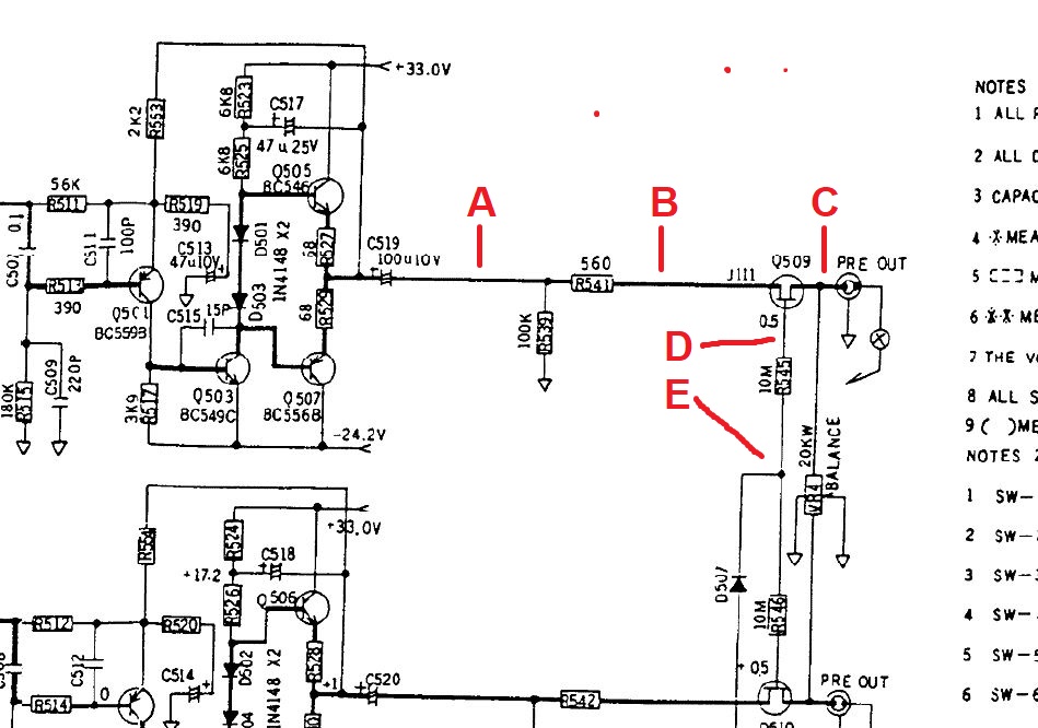

I run it integrated, so I've never really considered the pre-amp offset separately until I saw this thread.
