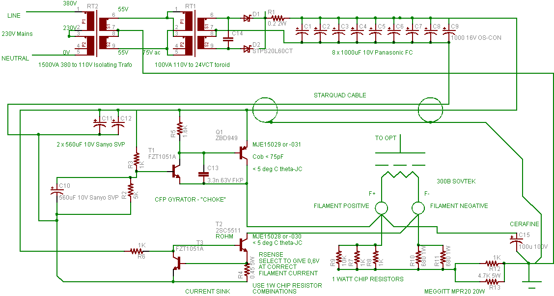

My 300B heater adopts a resistor network that compensates for the filament voltage by offering a higher impedance to anode return supply on the filament +ve compared the filament -ve. See the resistors R8..R11 in the schematic (this is an outdated schematic BTW - for updated circuits & ideas see thread: http://www.diyaudio.com/forums/tubes-valves/151421-26-pre-amp-3.html
One thing Guido Tent (the Tentlabs DHT heat-module designer) correctly identifies: The principal benefit of current heating of DHTs is that you don't present a low ac-impedance across the filament. Perhaps the cathode current distribution across the filament is upset by low shunt impedances. But if anyone is in doubt about the truth of this - here is a test. Put a LT108x 3-term reg on a heatsink. Connect ADJ to GND, OUT to GND via 1R/5W, IN as the filament negative, +9V dc supply as F+ve - a rudimentary current heater for 300B. When you have enjoyed the sound for a while, connect a 1uF cap across the filament, be it as boutiquey as you have on hand. Now see how the sound is degraded - to ac-heat level and below.

You can run the 2A3 filaments in series
Wouldn't this then connect the cathodes together via the path of the filament supply? How then would you account for the cathodes bring connected prior to the cathode resistor? I realize the cathodes are eventually "connected" at the ground, but this occurs after the cathode resistor and bypass caps.
