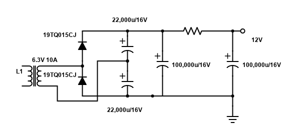

I have a challenge to heat 4 tubes 6SN7 with DC. I have a 6.3 VAC winding on my main transformer @ 10 Amps.
If I rectify the 6.3 VAC I don't get enough DC with the 2.4 Amp load (4 tubes). I tried a voltage doubler with 22000 uF capacitors instead, but still get only 4 VDC.
What are my options to get 6.3 VDC from this transformer? Space is very tight, so I need something very compact.

6.3VAC with a quad of Schottky diodes (e.g. SB520/30/40) will give you almost 8VDC (probably even more, considering you're using just a fraction of winding's nominal current, so the AC voltage should be higher than 6.3V). That's even enough for some CRC filtering.

Hi Koda,
I’m using your diagram, however with normal diodes and without the 100000 uF capacitors.
I’m just getting 4 VDC with 2.4A load.
Do you think the extra capacitors and the Schottky diodes instead of normal ones will make the difference?
If so I could try too with a standard bridge for 6.3 VDC output? This way I wouldn’t have to change wiring for series heaters.
Regards, Gerrit
I would say if you only get 4VDC what do you get with no load? You should have almost 17VDC from a 6V doubler... If you get almost 17V, your caps are too small and the diodes drop too much. If you only get around 8V, it's not doubling.
If you use 4 Schottky diodes as a bridge with large capacitance, it should provide 6VDC or more.

Without load I got around 17 VDC, but the voltage drop when loaded is excessive.
I just ordered some extra capacitors and schottky diodes.
Perhaps I will add a regulator, like on the DIY PCB Board you mentioned.

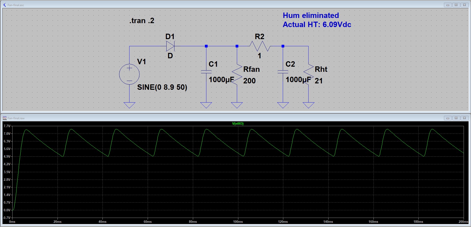

I was talking about when I design it myself. FWIW, I'm using 6 4700uF caps for smoothing a linear PS in an amp that needs over 5A. It's smooth enough that there is no hum audiable. As I said 100000uF is excessive but it would work with very low ripple 😛
Here's what I did to my Fender Champ guitar amp: crude, but the hum level is way below the hiss level, with everything full up.
Of course, a full wave rectifier would be even better.
