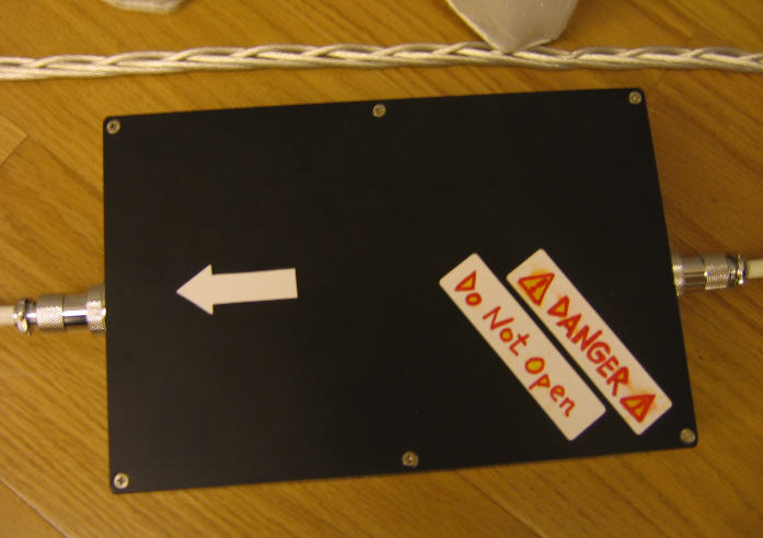

PS. The label makes you feel better . . . ?

as pointed out earlier the back to back caps are split between the lines, one // pair on the live line and one // pair on the neutral line.
On safety alone this is not recommended.
I believe it would be safer to put the whole DC blocker on the neutral line. Others would adopt the industry standard and NEVER put the DC blocker in the neutral line.
What label - the safety warning inside the lid? to help protect future repair technicians.

Glad to.
Picture a primary connected to one of two DC filters. One having the filter in the hot line, the other in the neutral. Now picture the DC filter letting the smoke out and becomming open circuit.
In the case where you have the filter in the hot line, your primary is now disconnected and all is well.
In the case where you have the filter in the neutral line, your primary stays live, all is dangerous.
You can then see that standard isolation precautions are suitable in either case, yet one remains potentially far more deadly in case of fault. That's my understanding of this tired debate anyway (it's come up in other threads).

Hi all,
Chris is right. When the DC blocker fails opencircuit, it is much safer to have the opencircuit in the hot (live) line. Then all down stream is dead. The Technician lives on to work another day.
However, this is where I disagree, when the unit is working correctly the DC blocker (including all it's wiring and casings) is working at line voltage and is potentially very dangerous if unsuspecting fingers are poking around or metal tools get dropped.
In an operational unit when set up or testing is in progress I believe that the DC blocker would be safer in the neutral line. This is completely in contravention of standard UK practice but it has a safety advantage. A safety label on or in the box is mandatory and possibly a LED alarm showing a volts drop across the blocker indicating that all is not dead.

I don't think I can agree with that. Such a circuit can simply not have easy access/quick disconnects or anything.
Even though this is a DIY thing, technicians are trained and know what not to do, and if they don't, no amount of shinny red labels will save them anyway. It also seems unlikly the OP would be sending this off to a technician for repair considering he built it himself.
So we can forget about the technician I think.
What the concern is are all the unknown that it's plugged into, all the different ways everything can go wrong in one big chaotic cascade... smoke and fire.
Seems to make alot more sense to put it in the hot line when you think about it like that?

Is your load really 1400W continuous?
If the continuous load is 200W and peak load is 1kW then design for 200W and accept an infrequent bypass current thro' the diodes. You decide what infrequent is. If you go for 1n5402 diodes they will run hotter than a power bridge and thus should only pass less frequently I would not recomend 1n4002 but they may work if the caps are kept big enough and a soft start is used on your bigger loads.
BTW,
you can test the effectiveness of the DC blocker by monitoring the voltage across it after you have installed it. If the peak voltage is less than the diode voltage then the caps are big enough.
use F=1/2PiRC to find C.
If your continuous load is 1400W from 110Vac, then rms current I=P/V=12.7Aac. Peak current into a capacitor input filter is even higher, but for simplicity I'll ignore that crest factor.
If you decide to use cascaded diodes in antiparallel then Vpk across the caps is 1.4Vpk (two in series & four in total).
The equivalent R for 1.4Vpk and 18Apk (=1Vac & 12.7Arms) R=V/I=1.4/18=0r078
Substituting into that first formula C=1/2PiRF=1/[2*3.142*0.078*60]=0.034F=34mF (=34,000uF)
If you put caps in back to back the effective capacitance is halved so one needs 68mF+68mF back to back to meet a continuous load of 1400W on 110Vac and keep the bypass diodes (1.4Vpk) inactive at the peak of the current flow.
BTW,
